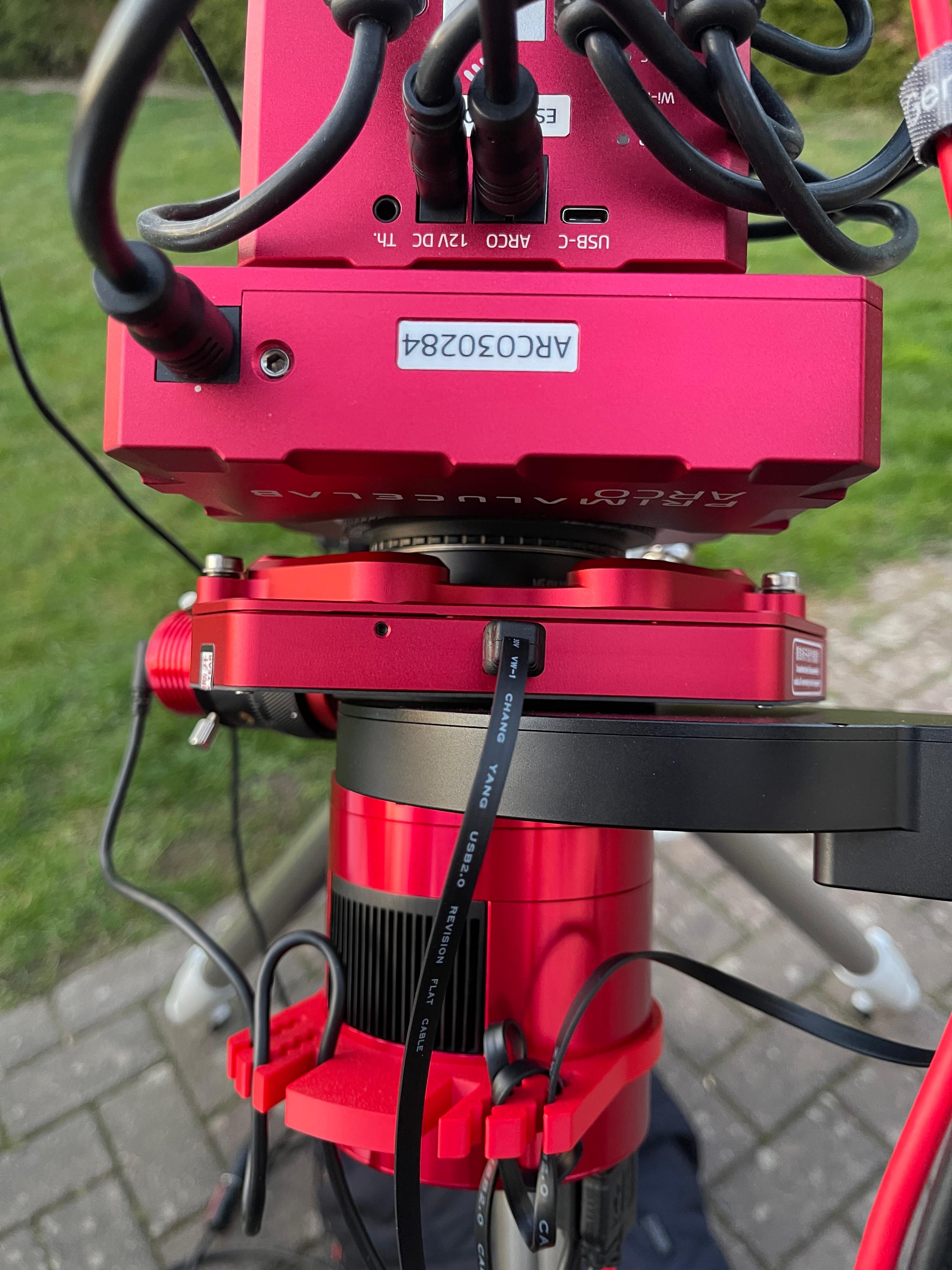

thanks for your response

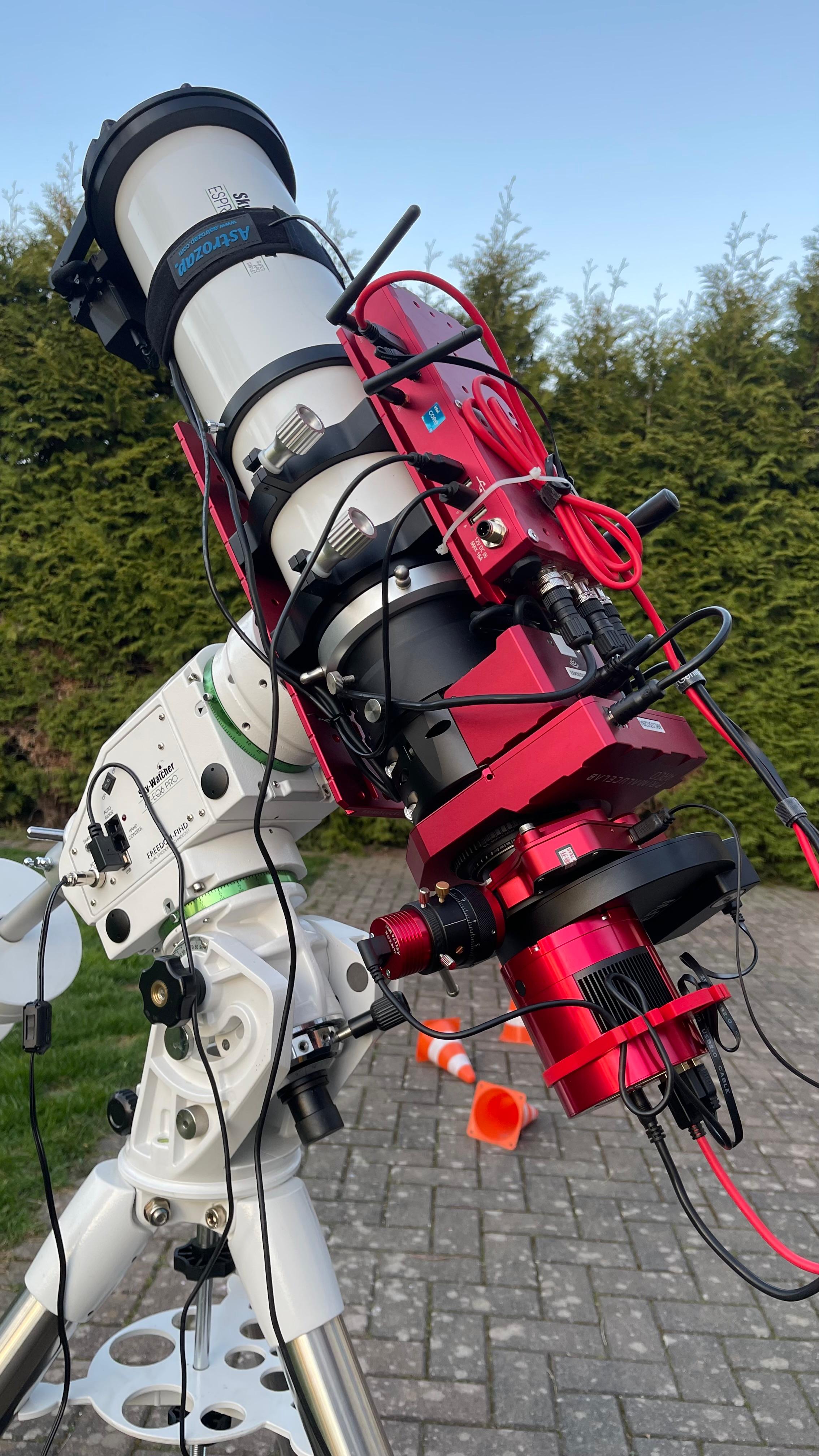

My rig is 2600 without tilt plate, efw and zwo caa (all is 56,5 mm) and i tried very different distances between 78-81 mm and never got puntual stars on the conrners...all the BEST was this
And this is my rig with adapters

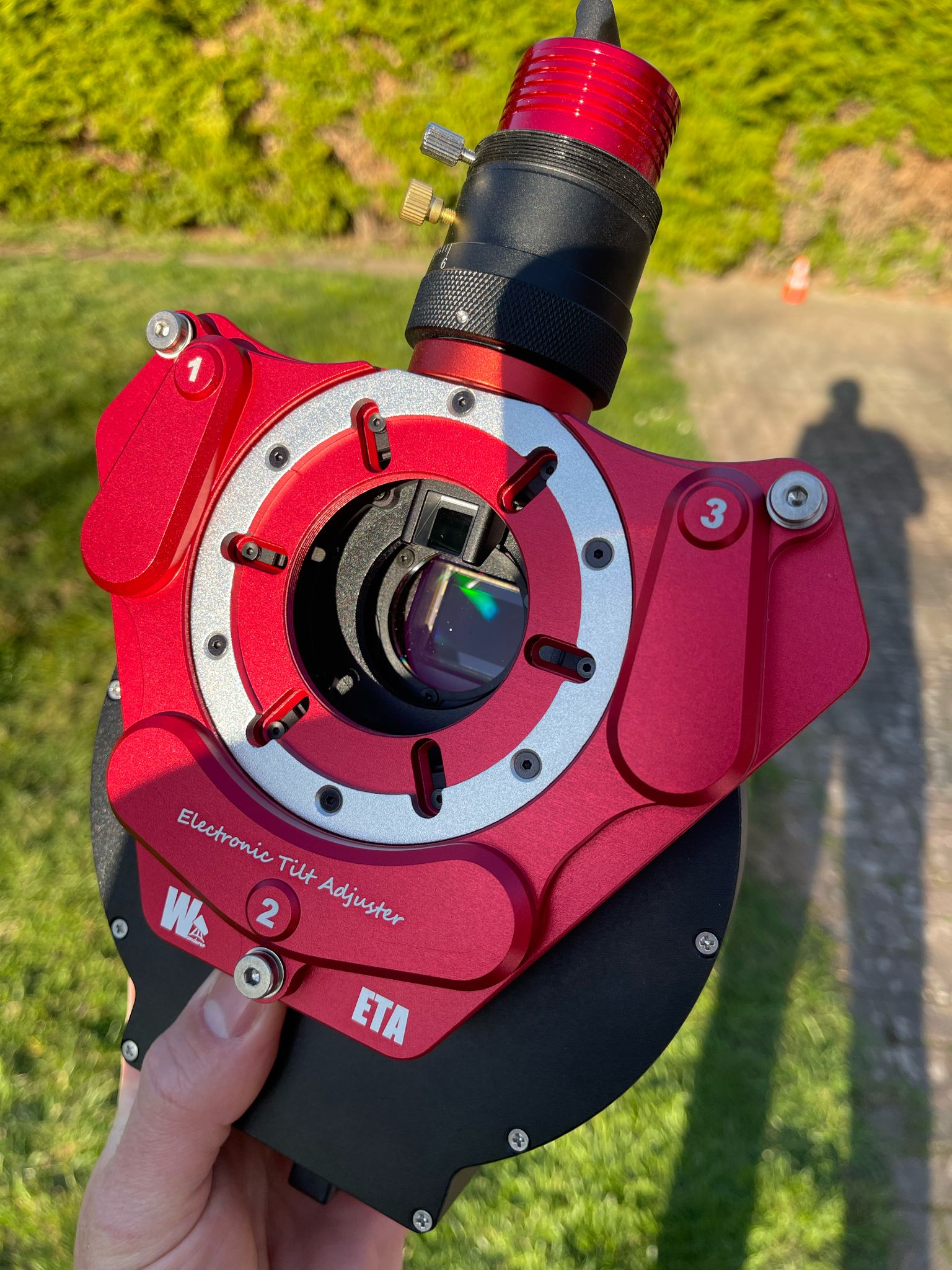

Kelvin.Hennessy 0.90

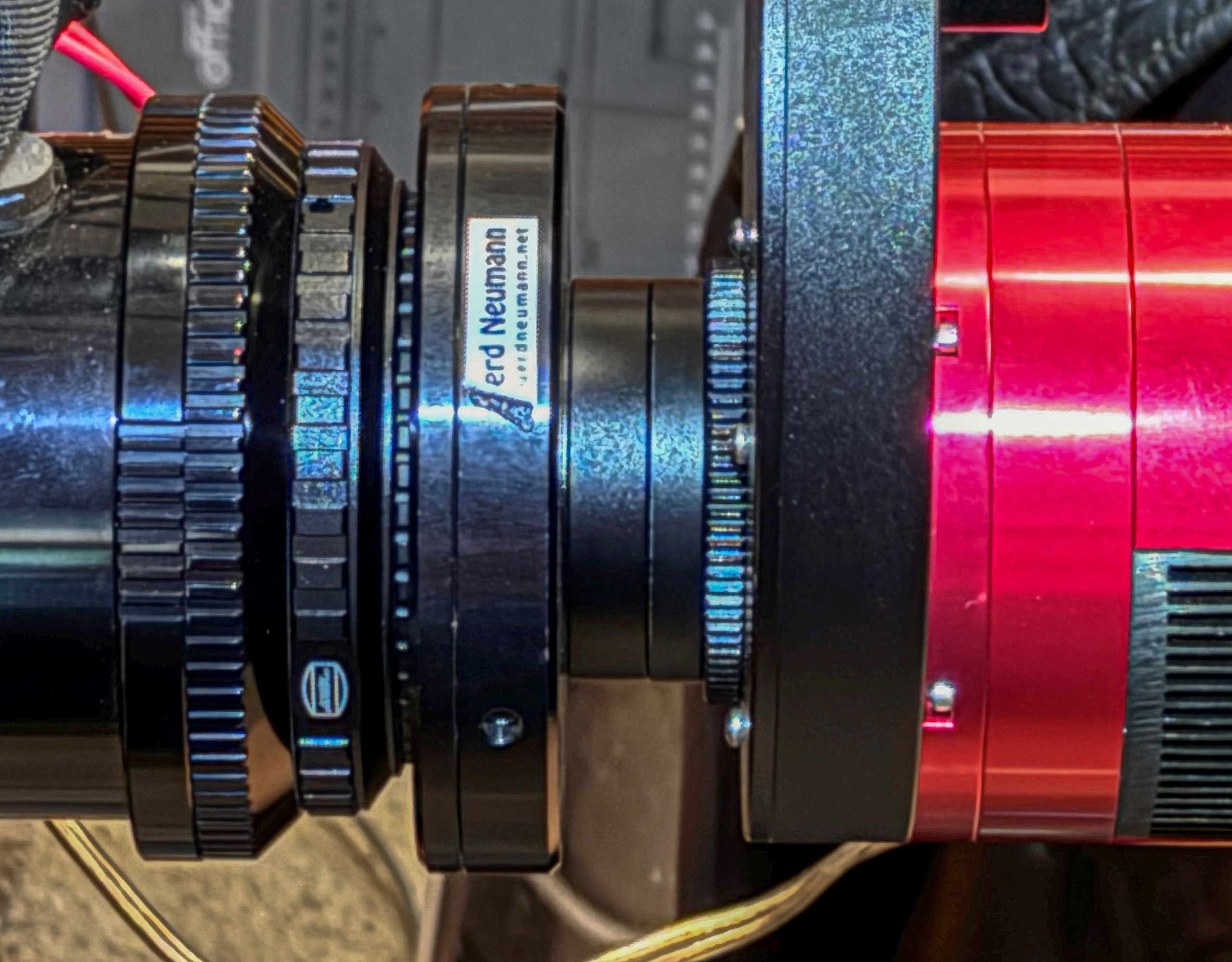

Espirit.jpg@Jandro.rm  here is mine.  Your spacing looks similar but you have extreme tilt.   I did have a 48mm 15-18mm variable spacer in there until last week but it got stuck to my Gerd Neumann tilt adapter and the only way to get it off was with a vice and breaking it .  Luckily I had the right combination of 48mm spacers to replace it and get close enough.  The tilt adapter made a big difference, though my tilt was nowhere as bad as yours. My Espirit focusser is at 47mm.

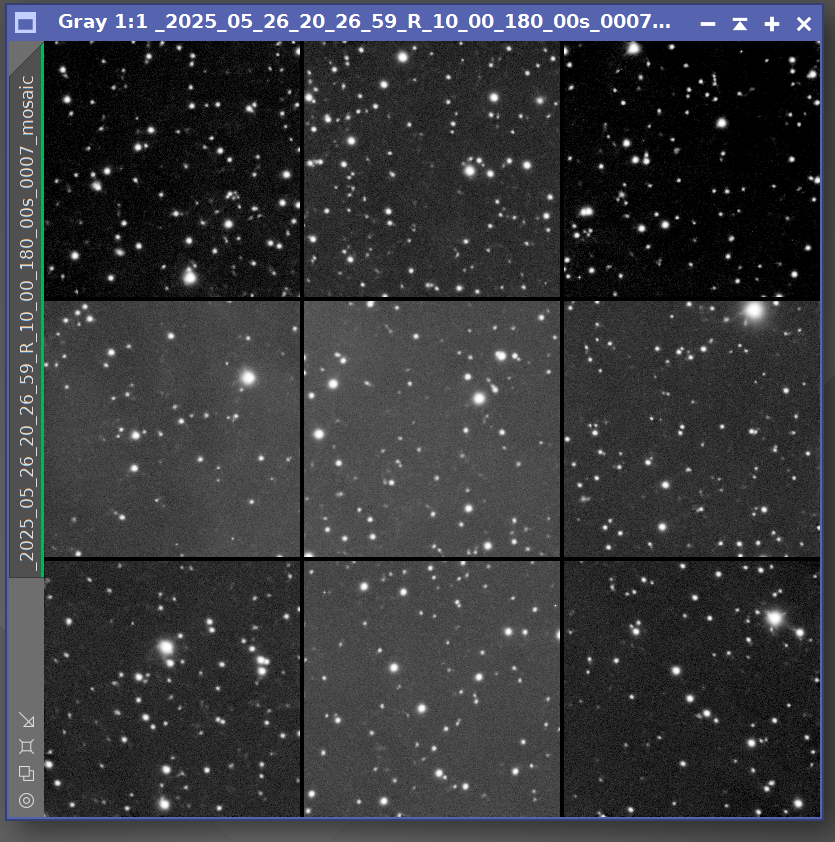

Here is a PI aberration inspection of one of my subs
At a guess I'd say the combined weight of your camera, EFW and CAA is too much for the draw tube.

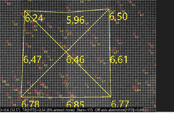

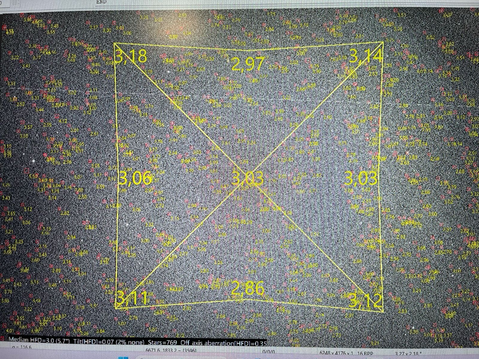

I've been testing backfocus these days but haven't been able to get it right. It's incredibly sensitive to 0.1 mm rings. I'm currently at 77.5 mm and it's the best I've gotten (pinpoint stars in one corner, since I have tilt, which I'll fix later), but it's very difficult to fine-tune. I've used Astap and Hocus Focus, and sometimes they contradict each other. When Hocus Focus tells me I have to move closer to the sensor, however, elongated stars still appear visually in the corners.Captura de pantalla 2025-06-18 103123.png
Jandro.rm 0.90

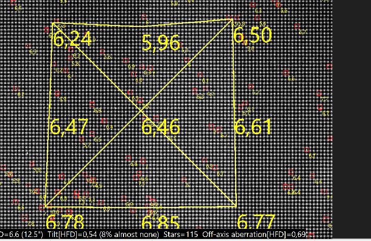

To check in astap. whats is the best HFD Value to check backfocus in this setup? i can´t down to 3,5
Jandro.rm 0.90
Finally i get it. Stars round on edges and no tilt at 74,5 mm

Hi Rob
From riccardi reducer. I  measured from there with a caliper to the 2600 camera and then added 6.5 since I don't have a tilter.
Jandro.rm 0.90
I adjusted using Hocus Focus and Astap. It was 4-5 hours adding and removing < 1 mm rings. Maybe to complete perfect backfocus need 0.01 mm rings…it´s very sensitive
