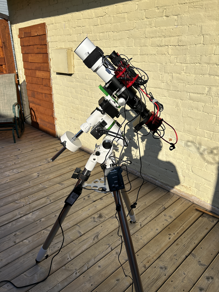

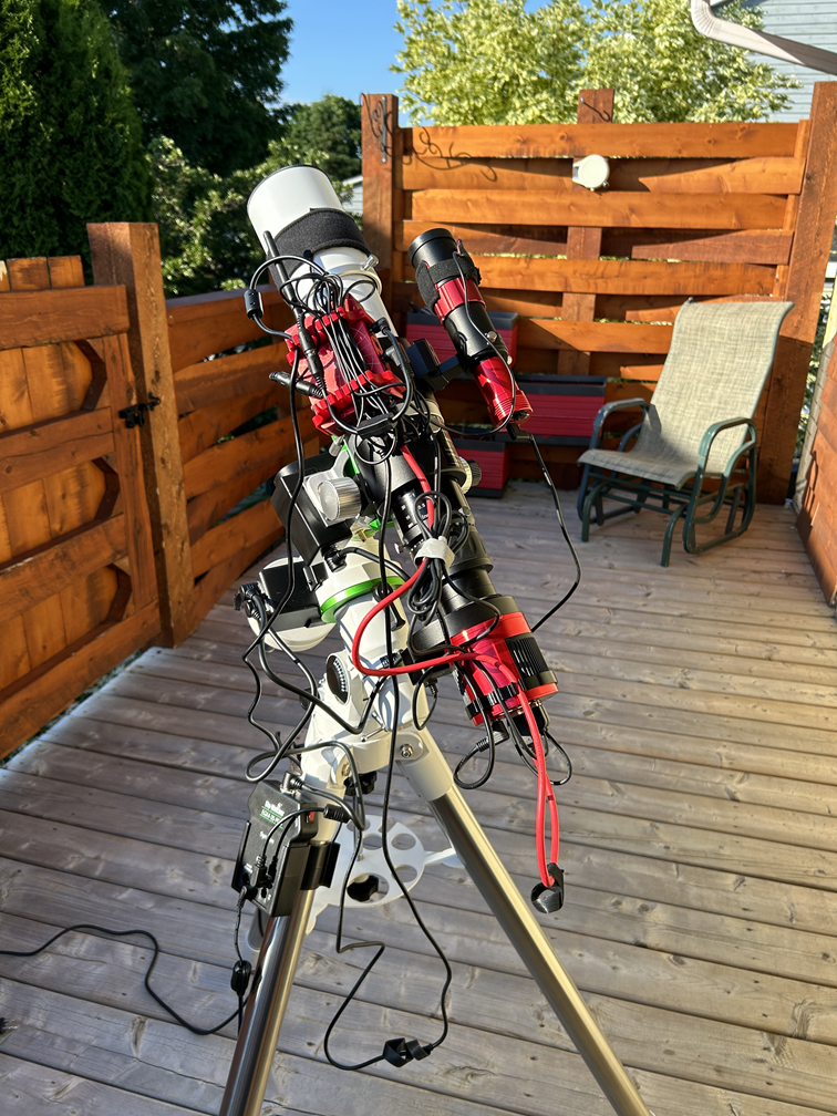

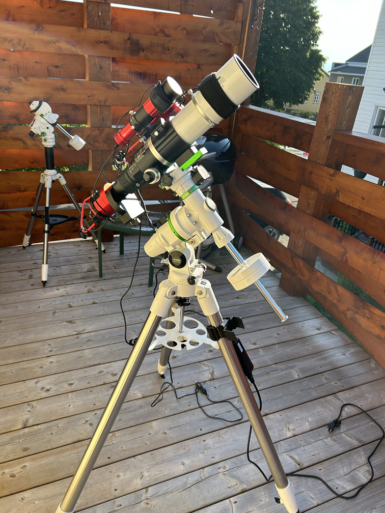

EricGagne 3.82
There it is.  It looks good so if it doesn't work in the end I can always put it in the front yard as a piece of art .  There is a bit a cable management left to do.  I need a short one to go from the camera to the EFW.   I am also planning on shorting the dew heater cables.
