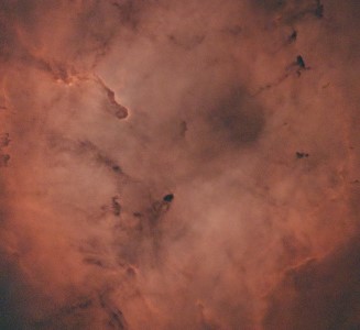

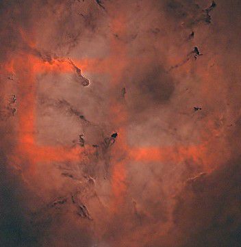

Doversole83 1.43
Not sure what's gone wrong with BXT.
My version is 1.1.18 AI version 2.
After one month of miserable weather, I am processing some images from last night.
I found some strange results using BXT on my star reduction then this on the starless image.... Where does that sign come from???
rcroman 3.91
Was this in luminance-only mode? There seems to be an issue with it that I’m looking into now. At the moment I recommend against using it.
Doversole83 1.43
Russell Croman:
Yes, this was with luminance only.

ScottBadger 7.63
Just be glad it’s not a pentagram……
Cheers,
Scott

This has append to me...I ran light denoise first and it resolved the issue
ScottBadger 7.63
BTW, I would *guess* that the large scale pattern shows the tiles that went astray for some reason. Since it's a starless image, you used manual PSF, right?

Astrobird 10.16
To me, it looks like the Chinese character for " center".  (中)
