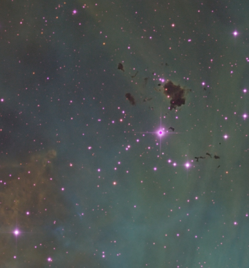

Anyone else getting weird star artifacts after BXT update?
I am not sure if its the update or problems with the data I downloaded from telescope.net
DevonRob 0.00
Is this narrowband data? I tend to associate purple stars with data collected using SHO filters?
walter.leonhard 1.20
Yes, I had this problem in my last LRGB image.
@Rob Walker  I think he's talking about the dark dot in the center of the brightest star. I'm 90% sure.
That was exactly what I saw in my image.

if you were refering to the purple core of the brightest star then check and see if the artifact is there before running BXT because some camera just show black pixels on overexposed part.

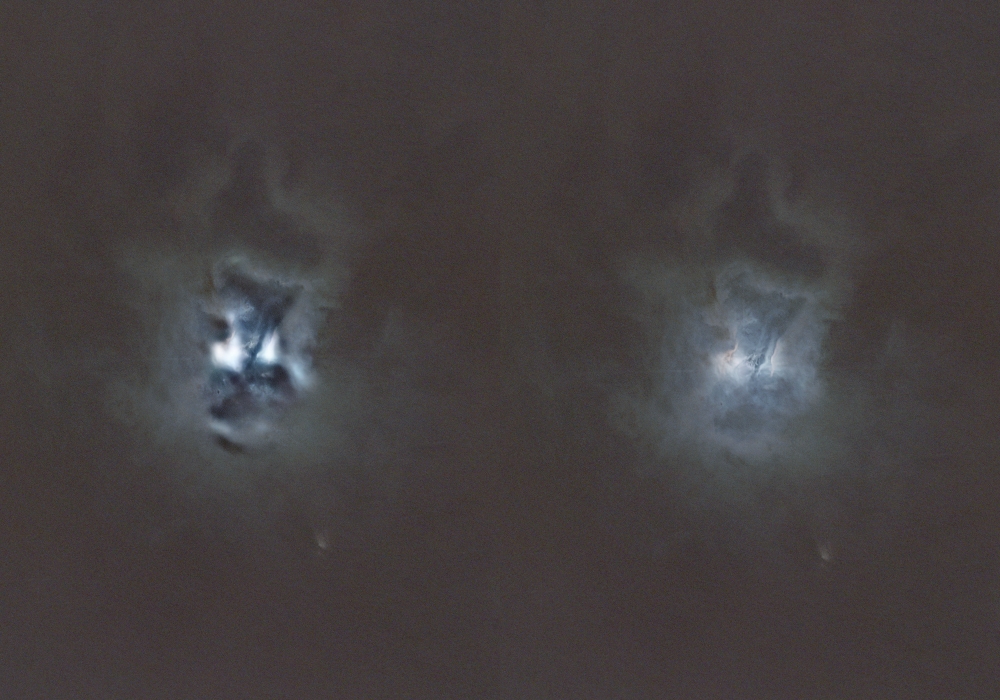

I also experienced a problem with the new version. Thankfully, we can select the AI version, so I switched to v.1 and now is much better. Below I place a piece of the Iris with v.2 and v.1, Sharpen Nonstellar: 0.9 in both cases.
Robsi 2.33
I have the same problem with the dark spots!
TareqPhoto 2.94
Should people update BXT then? I didn't use PI since long time because no imaging and no data, but i already have BXT, i don't remember i updated it, or maybe i did within PI update itself not sure, but if i will have data to play with then i will check it out.
Vroobel
Tareq Abdulla:
You can choose v.1 as the temporary solution.

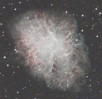

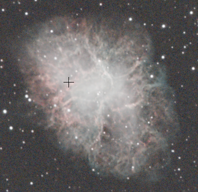

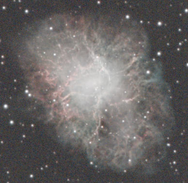

tried it with an OSC picture of M1 in linear stage, same dark areas and color changes as can be seen above. Used  the FWHMEccentricity Script  and manual PSFl... no positive effect (no other option selected), so Adam's advice is no solution for me.
going back to AI version 1 works at least to get the black areas gone.
Used a L-mask before BXT. this worked but makes the BXT less effective.
Here are some versions, with standard parameters 0.25, 0, automatic psf and 0.9 non stellar (manual psf shows no big effect)
version before update:                                                                             with AI version 1
version with Luminscence mask                                                    new version 1.17
the result depends strongly on the amount of background in the picture!  As more you crop as better is the result! You can try it with different previews.
So no solution for me up to now.....
