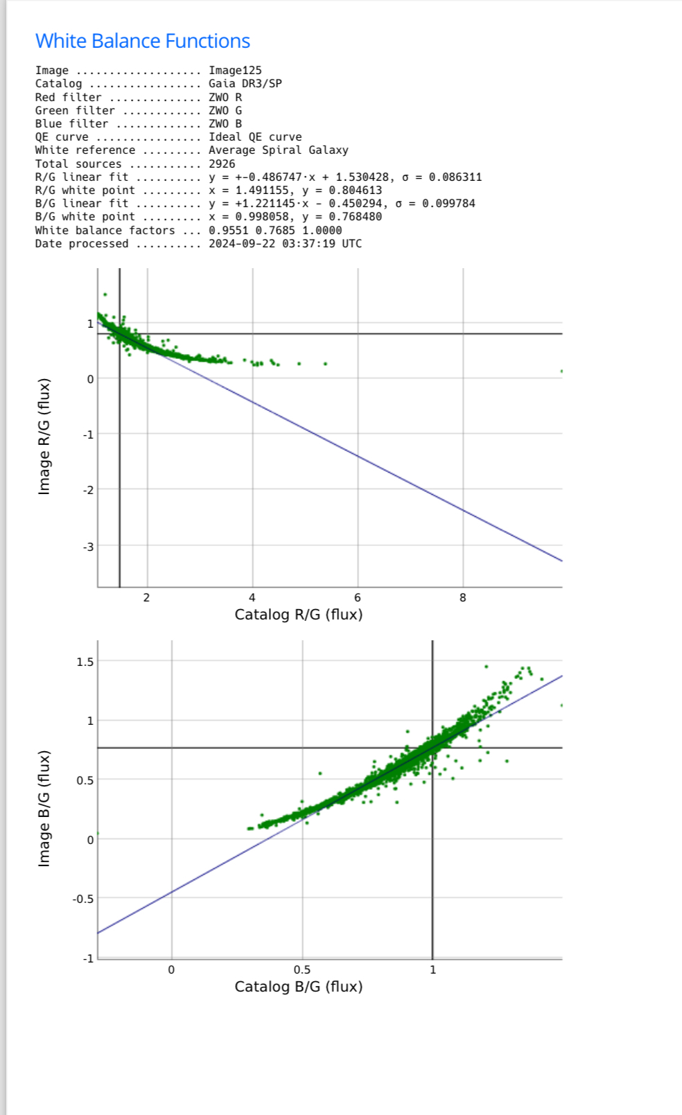

chrisastrophoto 0.90
Try to exchange B and G channel.
Your second graph shows a clear 1/x behavior, which indicates that you might have assigned B to G and vice versa.
Megsgallery 1.51
Yes;  this is great feedback, thanks!
I’m praying it really is something as simple as accidentally switching my filters around.
And if so, I will be having my spouse checking me yearly for early on-set Alzheimer’s.
Sucks for him, I guess, if that IS actually the problem / solution.  Hahah
Itching to get back to my computer tonight to troubleshoot.

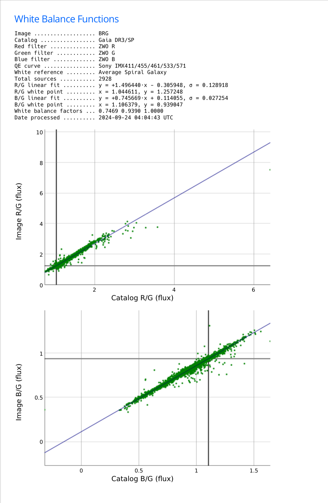

Megsgallery 1.51
Ok, after some great feedback, I can confirm the following:
1.  I did not accidentally switch my blue filter for an Ha filter.    I know this because the next night, before I replaced the filter wheel entirely, I shot one night of Ha data, and my flats were auto calculated by ASIair to last 15 seconds long, whereas my blue flats from the night before were about 8 seconds.    8 vs 15 sounds correct.  So, no accidental switching, there.
2.  Second, I tried switching in SPCC from my specific Sony sensor to the Ideal QE curve setting.  That didn’t make a difference whatsoever.  My blue to green graph in the SPCC results was still just as wonky.
3.  I re-ran WBPP and started from scratch. My master lights for each filter all looked same as before.  So no pre-processing issues I could identify.
5.  So, I tried integrating an RGB image swapping out my blue data for green data and vice versa and then running gradient correction and SPCC again.
Voila —— WAY, WAY better visual results.
The SPCC results via graph, however, still aren’t perfect:
But I do think I’m on a better track now.
The purple/magenta issues I was having went away, and color adjusting after SPCC with SCNR was much easier.
So my follow-up question is this:
Do I need to be worried about these less than perfect SPCC graph results?   They still don’t follow that perfectly linear regression the way I see them do so in tutorials.    Will that cause problems down the road as I further post-process the image?
But now the R/G graph is wrong. This one shows now the 1/x behavior. I would try all permutations of RGB and I am pretty sure that you will find the one which gives 2 linear plots with positive slope.

Cfreerksen 1.81
Christoph Nieswand:
I agree with Christoph. The graph is not a positive slope and this is in my opinion a dead giveaway that there is still an issue. I loaded my filter wheel a long while ago and did not look through the filters to identify. I had all mine skewed. Instead of RGB I had GBR, each offset by one. here is a typical graph found in the Pixinsight manual. Do yourself a favor and check your filters and either move them or make note on the filter wheel the order loaded.
Chris
Megsgallery 1.51
Thanks!
As noted above, I’ve already switched out the wheel for a new one so I’ll never know for sure.
But, I can try all six iterations of RGB channel combinations tonight and see if any one of the combos generates a positive slope for both graphs, which will help me narrow down how badly I messed up the filter order (if at all).
Thanks again to all providing feedback.

Megsgallery 1.51
You guys are absolutely amazing.
After channel combining all 6 iterations of RBG, GBR, RGB, etc, I indeed found the right combo.
You were all 100% correct —— I mixed up my filters like an idiot in my filter wheel.
After doing some really light processing, the results were entirely encouraging.
I can’t tell you how much I appreciate the feedback and quick troubleshoot.
You saved me hours of going down the wrong road in post-processing.
Apparently, I accidentally switched my filters as follows:
Red - was improperly labeled blue
Green -  was improperly labeled red
Blue - was improperly labeled green.
What a mess!   But now fully saved.
THANK YOU THANK YOU THANK YOU!
