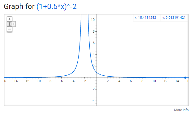

yzhzhang 1.81
Hi Mike,
Thank you very much for introducing an excellent generalized form of generating monotonically increased stretching curves. Very very interesting! Just out of curiousity (and I am guessing I wouldn't understand this completely given I have not picked up math textbooks for some 15 years lol), is there a general tutorial/introduction of Generalized Hyperbolic Function and how it's related with equations used in your form (in Figure 15 in the documentation)?
I googled around and found this to be the general definition of a GHF. I can see this turn into the Taylor Series of e^x, cosh(x), sinh(x) etc. at special (a,n,r) cases. How does these values translate to the D & b used in your equation though? I seem fail to see the link between this and the generalized expression you use in your equation (I suppose it's [y=(1+b*D*x)^(-1/b)]?). Also is there a mathmatical reason for the transition between "normal" form & "integral" form b cross 0?
And just to make sure I am not understanding this wrong, for D=1 (Stretch Factor: ln(D+1)=0.69), b=0.5, I should expect y=(1+0.5x)^(-2))? Why google tells me that's a monotonically decreased function between x=[0,1]?
Again totally out of curiousity and I likely wouldn't understand it very well, so I don't want to waste your time typing to answer and explain the whole thing to me; if there is any existing tutorial/paper about this, I'd be very interested!
Thanks,
Yizhou

Great question and I love this kind of question as it is an excuse to blather on....  Note that below is likely far more information than you wanted, but I thought I would let you know how GHS came about anyways)   Don't worry, do really don't need to know it, however, to use GHS and THERE WON"T BE A TEST!
I skipped quite a few steps going from what you show above to the formulation, but I will try and describe them here.   Your graph is quite helpful on this.  First off, let's only consider the RHS of your plot, with x>0.  The rest of the graph we can throw away.   From the equation, you can see that when x=0, then y=1 for any value of b and D.  Then the graph asymptotically approaches 0, as x goes to infinity, with b and D essentially determining both the slope (how fast y drops from 1 as x moves positive, and how long it takes for the curve to approach 0.   By varying b and D, you can achieve a family of curves.
This family of curves generated by has a bunch of properties that describe physical processes and is used in many scientific, business, and medical applications for time series forecasting  (substituting t, time for x).   Often you can either analytically or empirically determine b and D from early measurements, use y=1 to represent your initial condition and then, with reasonable confidence forecast what the values for y will be in the future.   In this form, the equation is known as the "generalised hyperbolic decline formula".   All you have to do is substitute 1-y for y and you have a family of curves that all go through the origin and approach 1 at infinite time and you have the "generalized hyperbolic growth formula"  Forgive me, but  an example application might be forecasting Covid-19 cases or hospitalization models (with y=0 representing no-one has it, and y=1 representing everyone does).   In this case b and D are derived from transmissibility, and effectiveness of distancing, masks, immunity, vaccination, etc.)
A couple of special cases of the generalized growth formula, are when b=0 (or rather when b approaches 0), the formula becomes exponential  ( y=1-exp(-Dx) ).   This is the formula for the growth in amount of a radio-active decay product.   It is also the formula for continuous compounding interest rate in economics.   Another special case, is when b=1, the formula become "harmonic"  or ( y=1-1/(1+Dx) ) - think of a guitar string getting quieter after plucking.      When b>=0 and b<=1, the initial slope (derivative) of the function is D and the function is hyperbolic.   When b>1,  the slope becomes D*b and the curves are deemed "super-hyperbolic.  If you are a petroleum/exploitation engineer, you will recognize these as the Arp Equations - if you are a petroleum engineer you can stop laughing now - I are one too.  Regardless, the largest slope is always at x=0, and the function is always increasing.   It is helpful that the function (important that it isn't a "relation" ie flat or decreasing y with increasing x, which will cause image artifacts) is also integrate-able, differentiable, invertible (can get x from y or y from x) smooth and continuous (at least for x>0).
For application in GHS script and image stretching, we have manipulated the formula so that it only runs from x=0 to x=1, and then linearly normalized the curve so that y(x=1)=1.   (Both input and output pixel values can run from 0 to 1).   We put sliders in for b and D, to be able to control the slope (amount of contrast) added at x=0 versus what was added at x=1.   We also changed the slider from putting D in directly, to putting the log of D in  to allow for sensitive input of true linear D at low values of D and also very large values for D.   (the actual formula for D input, is shown in the script, but we just call it D anyways - so the work you showed is fine, just substitute ln(D+1) for D in your example) .   Another trick we played is used the integral (cumulative) form of the hyperbolic equations when a negative b value is input (a negative b means a positive b with the integral form).   In its integral form, a b=1 (input b=-1) yields a logarithmic curve and a b=sqrt(2) yields a decent approximation to arcsinh  (for more on this read about Euler's formula - but only if you like math).   We're still ok at b=0 because both the hyperbolic and integral hyperbolic forms are exponential.   Even the "Histogram Transform" can pretty much be duplicated (it is, in essence, harmonic).
The shape of the resulting curve  that I was drawing when I used the curves process, was almost invariably the same shape as the resulting generalized hyperbolic equation, that it inspired me to chase these equations a little for the application of stretching.   By basing the curve on b and D however, I could get precision and repeatability that you practically cannot get by drawing curves.   (try going from linear, to a decent stretch in one go with curves, and you'll see what I mean).    Also, I wouldn't have to deal with spline or linear interpolation - both of which can cause artifacts and destroy data.   Finally, no clipping!, at least in RGB/K mode as both x and y run from 0 to 1.    That is the basis behind my claim that GHS is a "safe" stretching environment - at least safe for the data - I don't recommend using GHS while skydiving.
Use of the SP slider essentially changes the origin (moves the x=0 point) to allow for the the maximum slope to apply (maximum contrast addition) at any chosen point.  For pixels less than SP, the negative mirror image is employed which is symmetric about SP, keeps the same desirable properties of the hyperbolic equations and, in essence, allows for the a typical "S" shaped curve to be applied.  With D and b, you control how both how steep the middle of the S is and how curvy the S is.   FInally, LP and HP were used where the slope (or derivative) was held constant for x>HP or x<LP - ie contrast reservation through linearization for highlights (brightest stars, nebulae) and lowlights (dim, background) features.   Through their effect on normalization, HP and LP also serve to bright or dim the stretch function to help set the "black point" and "white point" - again without clipping.   By employing an inverse - an inverted S shape can also be applied.
If you are a geeky applied math guy - another way to look at the GHS transform is as if you were doing a masked stretch, only with an infinite number of masks and/or applied them implicitly (using the results of the stretch before you have them, as the mask) rather than explicitly (using the current image as the mask) as with the "Masked Stretch Process".
So that's how we get from the curves/equations you correctly show, to the GHS input.   Hopefully you aren't sorry you asked or read this, I did enjoy typing it.   Mike and I didn't really create anything new here, we just "borrowed" from other fields.   (Next stop, Laplace transforms rather than Fourier? :-) )
Dave
