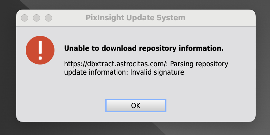

Hi Raúl,
I got this error message when I try to install your script.
Do you know if there is something wrong with the script or if the issue is on my side?
Ben
Hi Ben. You must have an updated version of Pixinisght to have my signature as a developer. Pixinsight includes valid developers in updates and im too new

Moto_Man007 0.00
Raúl Hussein:
Ben Altmann-Vacqué:
Hi Raúl,
Ben
OMG... I´m ashamed.
Now it worked perfect.
Thank you Raúl :-)
