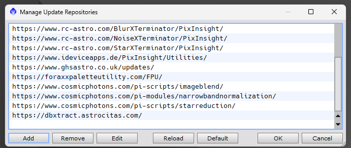

kerryw 0.00
Ignore below removing and reinstalling all updates fixed it..
I'm having an issue installing the script. I can add the repository but when I check for updates I get "no updates found" and nothing installs.
I'm on build 1612 released in June 2024PixInsight Standard Edition
Version 1.8.9-3 Ripley (x64)
Copyright © 2003-2024 Pleiades Astrophoto
All Rights Reserved.
https://pixinsight.com/
Kerry
