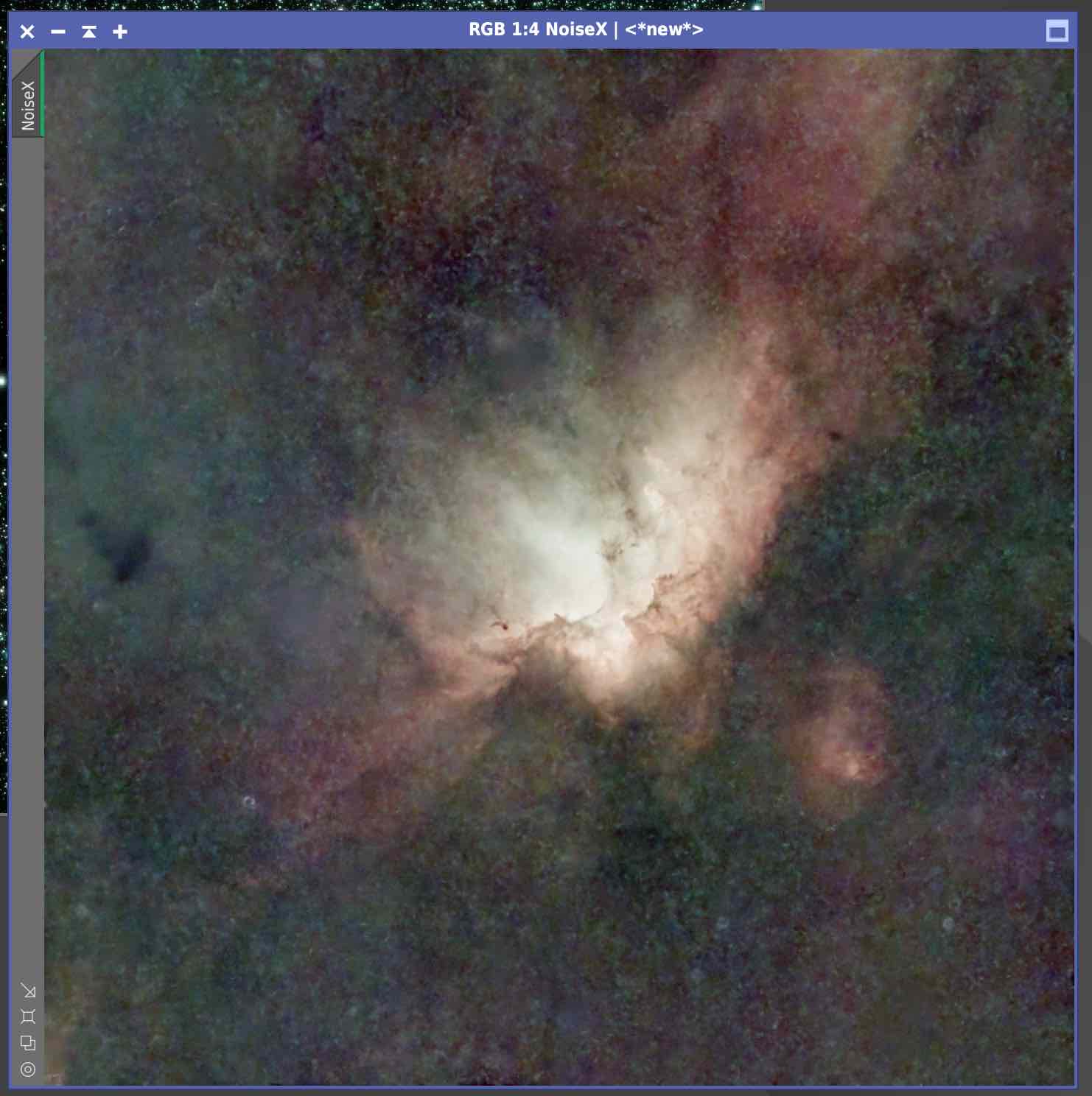

Craig Dixon:
Is anyone able to advise on why this image looks so mottled. It's still linear and has an STF applied. Here's the workflow so far:
Compare your image before and after applying NoiseXterminator, also by checking the histograms. Since new years I've been applying NXT after stretching because of this. The STF is over stretching things quite a bit anyway, but nxt done in the linear phase does seem to have implications on the histogram and bring out a whole lot of mottle in my experience. Doing it after stretching doesn't come with the same side effects.
Jbis29 8.59
Don't use Background Neutralization before Color Correction. Use it after. If you use SPCC/PCC you can run BN within the process.
Im curious, if you dont mind diving into this a little bit. It is my understanding that BGNeutralization should be run before color calibration so that if there is a bg color cast that is contributing to the target signal it is removed before calibrating target signal. Which would return a more balanced color calibration. The PI devs released this video that explains the methodology and logic: https://youtu.be/WYPVtmhXJYk?si=MvFIQKZrrdH2Mbor
Genually curious to hear your thoughts on this.

jerryyyyy 9.62
I have several changes I would recommend.
  • Stack in PixInsight using the Weighted Batch Preprocessing script. It has shown to produce a higher quality result in tests. Adam has some good videos on how to use.
  • Don't use Background Neutralization before Color Correction. Use it after. If you use SPCC/PCC you can run BN within the process.
  • Avoid any Color Correction for narroband images. Instead treat it as a mono image by separating out the RGB channels, lineafit Red and Blue to Green. Then name Red-->Ha. Then combine Green and Blue with the PixelMath formula Avg(Green,Green,Blue) and naming the result as Oiii. You can now combine the channels to create and HOO image and tweak subjectively to your wishes.
  • Try using some newer noise reduction methods such as DeepSNR and NoiseXterminator.
  • Try using Generalized Hyperbolic Stretch.
  • Try using this method for created synthetic RGB stars: https://www.nightphotons.com/guides/star-addition
Hope this helps!
This is close to what I do.  I have gone over to the dark side and use BlurX.  I could never get deconvolution to work well.  I depend a lot on GHS.
I have to try your CC for NB.
In WBPP I do use the 1X drizzle option... get larger star counts consistently.
