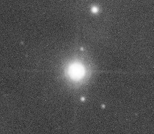

like I said we are stumped because for a few subs the other night the halos shrunk drastically and deconvolution in PI and blur x both worked correctly

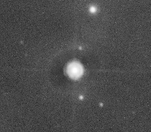

If this helps any here is the raw halo and and accentuating its features haloo raw.jpeghaloprocess.jpegin the raw if you look also close enough you can just make out the dark rings and that dark line , in line with the bottom spider vein I just processed it to make it more apparent

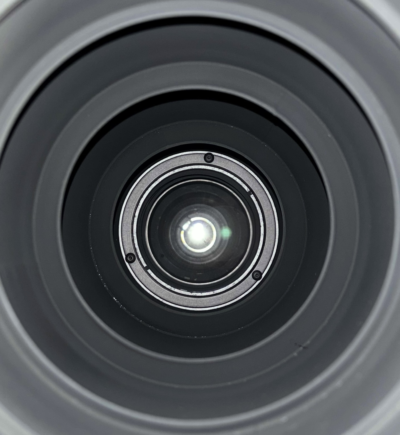

and this is straight down the baffle with my
phone.
It's thermal, nothing else could do that.
Whirlpoolm51 1.51
That explains why I was able to get rid of the halos the one night. If that's the case than I am going to have to come up with something to get better air flow. I noticed the one night it was really bad the primary would not get any lower than about 1.5 degrees above ambient and it was about -1c that night and I open the observatory and turn the fans on at least 2 hours before dark.
I'm wondering if the shorter lower tube of the ag optical scope helped with this, hence why I never had any temp issues with it and that was with only 2 fans blowing towards the back of the mirror.
I am going to completely disconnect the delta t next night I'm out I am almost wondering if it is turning heaters on when it shouldn't be because there is no way this scope is that sensitive to temperature.
Flipping the fans at this point is not an option because I really don't feel like taking the whole scope off the mount and apart so I'm going to remove those mesh filters and see if I can get any more air flow.

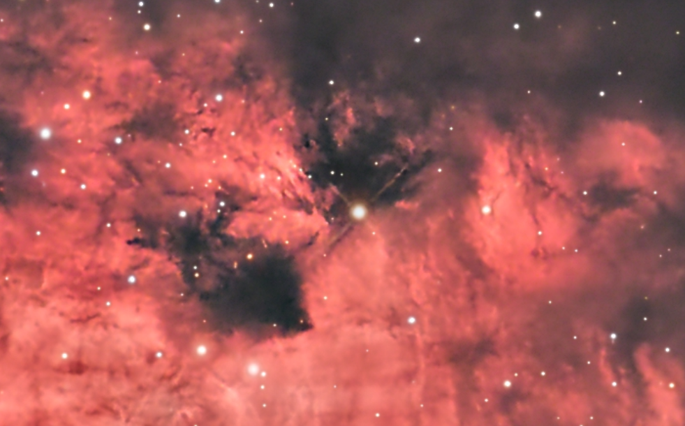

Yup, so after a bunch of testing I am almost positive its two issues. 1) crappy filters 2) That "demon star" issue that is temperature related producing the deconvolution artifacts. I still get some haloing with no filter, but it looks more normal now. I am going to try flipping the filter even though they are mounted, so I will probably have to unmount them. Even though this happened with both optolong and antlia , so it looks like I am going to have to shell out more money for chroma (anyone interested in a qhy268m with filter wheel and oag?? brand new!! lol)
Also think I am going to tweak collimation some more and hopefully that will help.
As for the spikes causing the artifacts I am not so sure what to do. It takes the cdk forever to even get the primary within 2 degrees of ambient with fans on all the time. Have the primary heater off all the time and the secondary set to either 30% or to kick on when the temp drops below 2 degrees above ambient and my stars still look wonky.
Yes, this is more than likely just me screwing something up but sheesh the only thing bad I can say about the ago idk compared to the cdk is that collimation takes a little more work.
