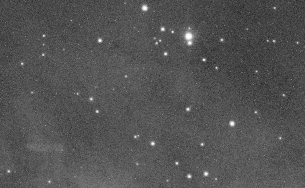

hello all!! About a couple weeks ago I received my new cdk14 and since then every time I have imaged with it, I have been getting these halos around Brighter stars. I have been discussing this with others, and it seems narrowed down to either reflections or temp related. They are in almost every image I take, and I only managed to get a few images without them the other night but last night they returned and would not go away at all. I have tried different filters, cameras, imaging at different angles etc etc. Figured I would give the astro bin forums a shot to see if anyone else here may have had this issue or has any ideas. When I run deconvolution on some of these images it produces star like artifacts around the stars with the halos. I really thought it was temp related but last night both mirrors were within 1 degree of ambient and I always open the observatory hours before to let the mirrors cool down. Another note is that this issue never showed up with our ago idk 14. Here is a raw sub with the halos HA2024-12-1710030600.00-10.00(8).fitsAnd here is one without testblue2024-12-1410030300.00-10.00(14).fitsSent a support ticket to planewave about 2 weeks ago with no answer and just left them a message today. I have also been talking back and forth with matt who used to work with them, and he is stumped also Any insight would be greatly appreciated

andrea tasselli: There is no halo and nothing out of ordinary. look at this one, you have to zoom in a little to see them. The stars should not have these halos. These halos are what is leading to my artifacts when running deconvolution. If you use PI, run decon or BX on the image and you will see. melotte15cdk |
Of course the stars have halos, even more so at your image scale and central obstruction, that doesn't come for free. You are at around 2" seeing so a little diffusion should be expected. I can't see sign of thermal plumes either. I just run BXT with the right settings and as expected very little difference before and after. IOW, the image doesn't show signficant aberrations, be it by internal seeing or optical.
Before:  After:  |
yea, now go around the field and look at all the star like blobs around the brighter stars. Even on the brighter on in the crop you sent
compare that to the last raw sub taken with the ago idk and neither the halos nor the artifacts around the stars are visible after decon HA2024-11-1210050600.00-10.00(2).fits |
I can't understand what you are saying. There are no star-like blobs or anything which shouldn't be there. Maybe point to me what you are concerned with.
You can't see the halos because the B frame has much worse seeing than the Ha, that's all.
 look around the stars where the halo is after you use decon , only on the brighter stars. those little spots should not be there, and neither should those large halos. In the images I linked, those large halos are not normal especially on the more moderately bright stars. The star like artifacts after running decon is a known issue I've read about but that still doesn't explain the large weird looking halos
They also change shape from image to image which had me thinking it was temp related to the boundary layer. One night I left the fans on all night and the halos eventually went away but last night they were still there and would not go away. Keep in mind, this has shown up every night I've imaged with this scope so far.
Now I can see what you're concerned about. Does a star test with a clean imaging train show anything? It's the star like dots in the halo that get my attention as truly weird. I would think that PlaneWave owes you ($$$) a timely response on this.
Now, the blobs as you like to call them will go away with BXT if you suppress the halo.
THe only thing I can think of is of a thermal layer on the primary. But otherwise I can't find any other fault.
andrea tasselli: Now, the blobs as you like to call them will go away with BXT if you suppress the halo.
THe only thing I can think of is of a thermal layer on the primary. But otherwise I can't find any other fault. This!! I really think I'm not getting enough air flow over the primary with the fans, enough to scrub the boundary layer for good at least. That would explain why the halos drastically shrunk the other night for a couple subs but then came back in full force the next.
