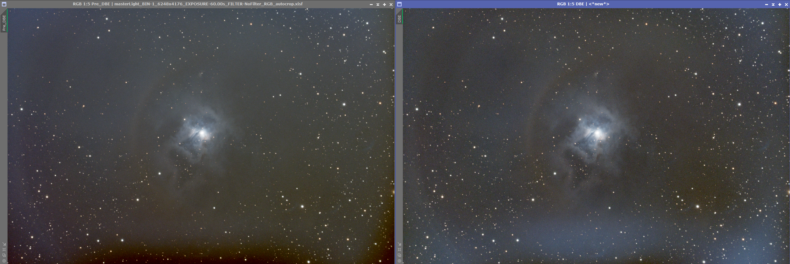

I've recently been trying my Edge 8HD for DSO targets with the Celestron reducer. I have now encountered an issue with calibration.
Flats are taken the same way I do them for my other rigs (flawlessly). Several layers of a white t-shirt and then an evenly illuminated sketchpad on top. The flats I used for this particular image were around 1-1.5 s long, using the Asiair auto-flats function, and they were calibrated with equal darkflats.
This has been working very well with lenses and refractors, but now I have rings in my image after stacking. Is this caused by internal reflections from the baffle tube?
There seem to be an issue with correcting the vignetting as well.
(Ignore the OAG obstruction):

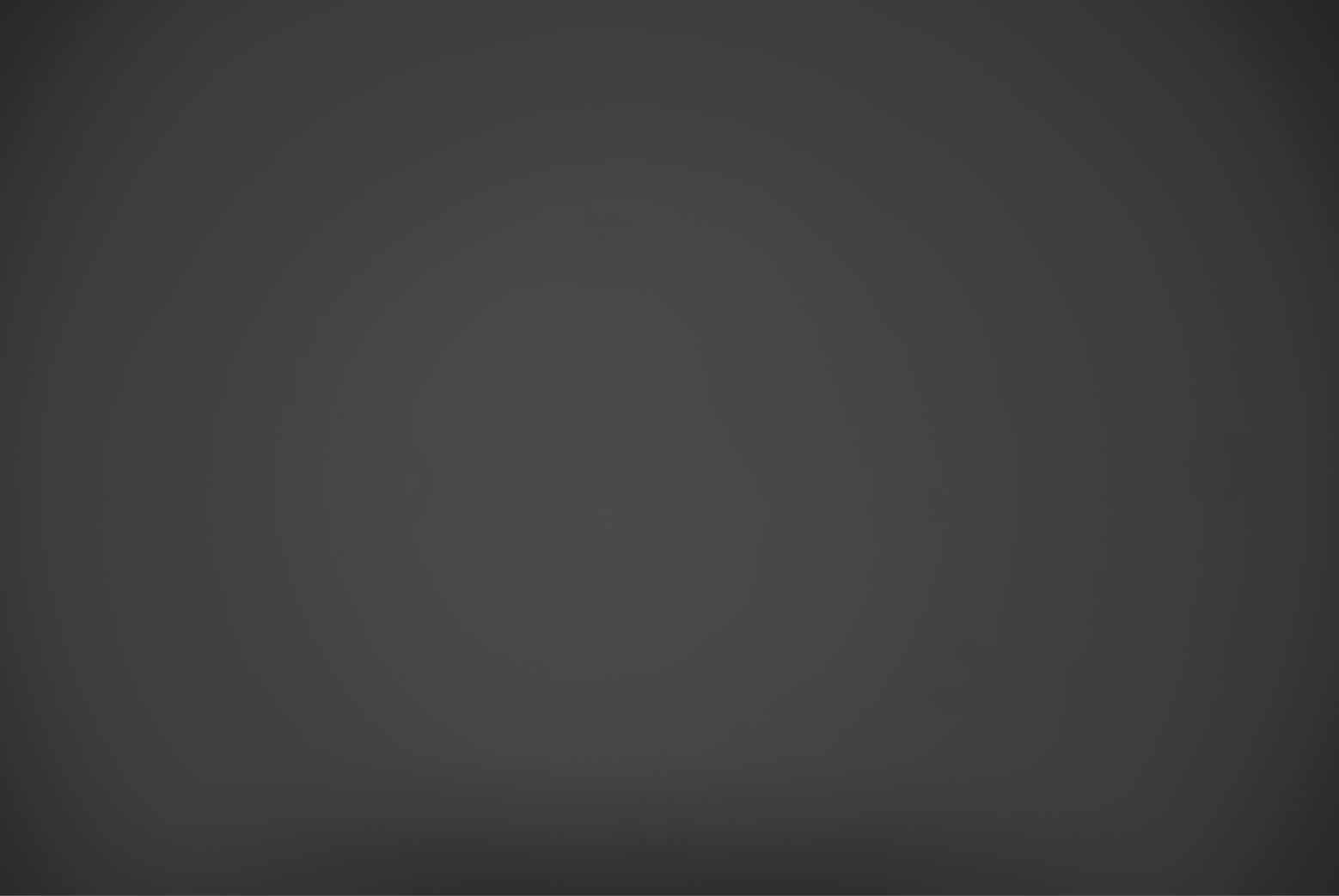

Here's one of the current master flats:

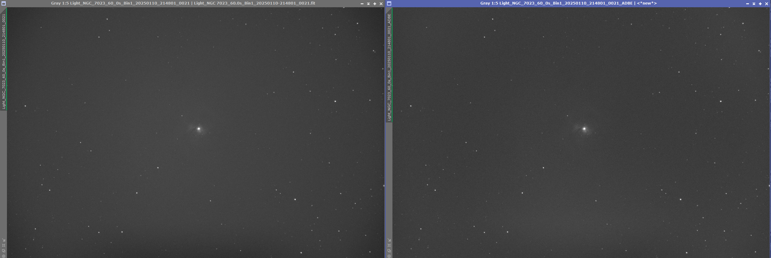

A single sub, original to the left and with a quick pass of ADBE to the right:
I might do a stack without flats just out of interest, although I do not expect much from it.
EDIT: The flats have not corrected the few dust motes correctly either it seems.
