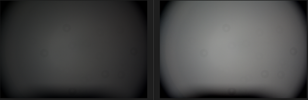

I just finished re-taking my flats now. Apart from adding the dew shield I also went back to my normal procedure for flats by increasing the exposure length. In the past I've had nothing but bad experiences using short flats, so I usually stick to minimum 4s.
This round I had just above 5s exposures and the dew shield, the difference in the single exposures are quite big. The new one is to the right.
I'll post an update after stacking everything.

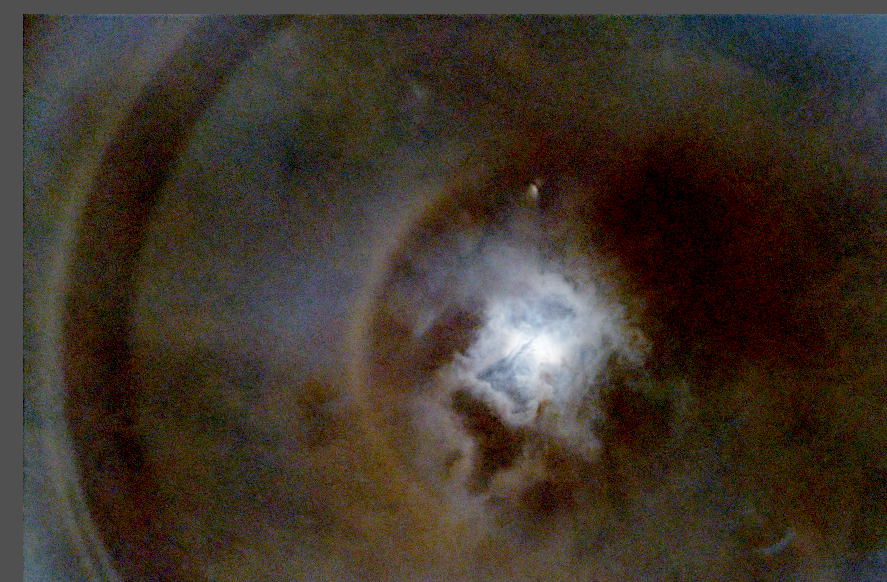

I've grossly overdone this just to highlight how bad it is:
There is very little correction going on at all, even with new flats, maybe the increased contrast in the flats even made things slightly worse. That being said - this is two sets of data so there is some shift from one day to the next as it was being phsyically moved. I didn't expect to see a full correction, but if adding the dew shield was the solution it should have shown a more encouraging result at least.

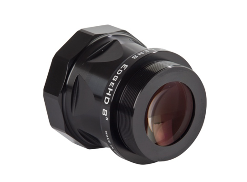

I'm going out on a limb here - Do you have the reducer specific to the EDGE and not the non-EDGE models?  Not sure whether that would be an issue or not.
I've had my reducer/OAG/EFW setup for 7 years with no issues.  This is quite baffling!  Hope a solution can be found.
Yes, I have the one labeled "EdgeHD 8", then the Celestron OAG behind. No EFW currently as I'm not using filters at all with my OSC cam. I was quite suprised too. I've been preparing quite a bit but did not expect these results.

Yep - that's the one designed for EDGE SCTs and the one I have.
