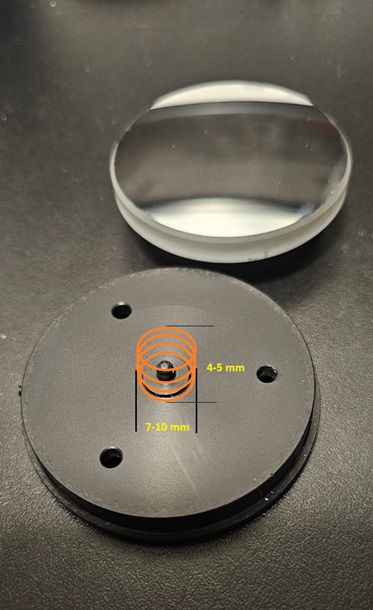

I disassembled both secondary mirrors, to see the differences. I attach photos.
Newton:
Celestron C8 EDGE. No tension.
The two huge differences are, firstly, that the Newton has a spring that tensions the secondary mirror and secondly, the mirror is held by a tilting screw.This has enormous advantages. The first, when under tension the screws are firmer and greater control is obtained when tightening and loosening. The second and most important, when a screw is loosened, the spring pushes the mirror, so we have total control without the need to adjust other screws. Finally, the presence of the tilting screw prevents accidents, since if it were not there, as happens in the Celestron C8, if we loosen the 3 screws too much the secondary mirror would fall on the primary one.

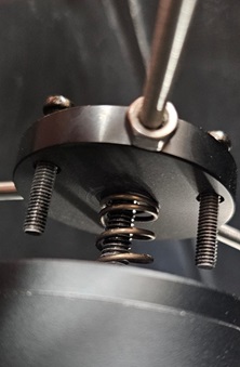

To obtain the advantages of the secondary mirror that appears in many Newton telescopes, I propose two improvements that are very economical.
The first is to place a spring 7 to 10 mm wide by 5 mm high on the axis with a blunt tip where the mirror tilts. It is an easy spring to acquire and find in a multitude of components that we have at home. With this we will have the tension that will help us in collimation. The second improvement is to change the screws for about 10 mm longer, which provides greater security.
Sometimes when the collimation is achieved, the screws are not firmly secured, so they decollimate when changing position. It is not for nothing that many users collimate with Jupiter's moons before pointing at Jupiter, so as not to move the telescope too much. This problem is eliminated with spring tension.
I have made these improvements and I can calibrate perfectly in less than 10 minutes, without stress, without problems. When I collimated without the central spring I spent 2 hours on it and never obtained the desired collimation. Of course experience helps and celestron owners acquire skill and achieve perfect collimations in minutes, even more so with the new accessories that are available to help.
I hope that helps.

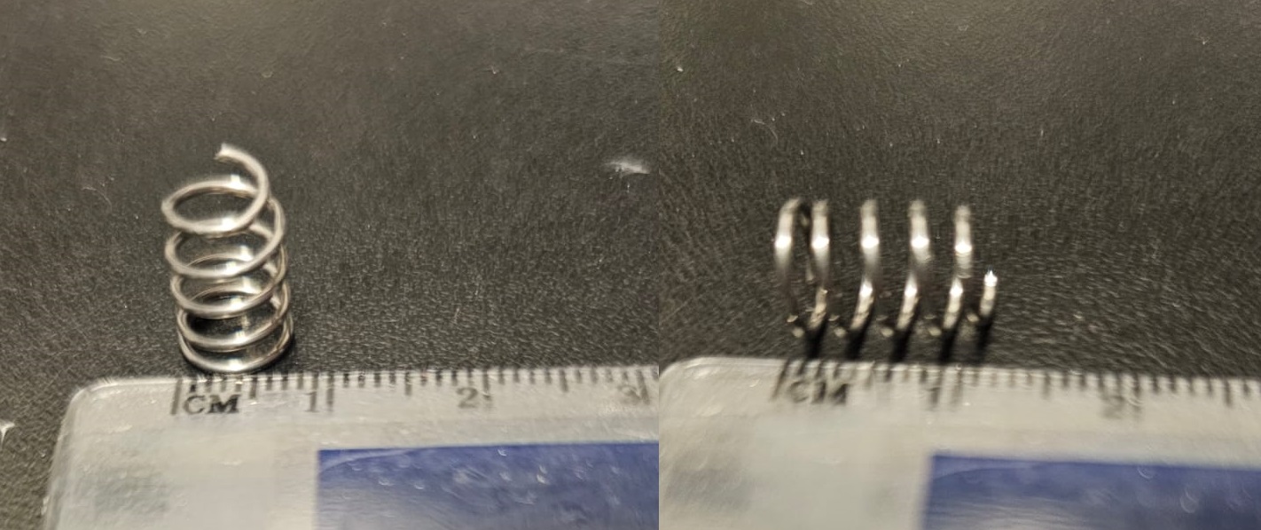

Hi Paul,
The important thing is that it is a compression spring and that once compressed it is not greater than 4 or 5 mm, since that distance is being removed from the thread pitch that holds the mirror and if you loosen the screws it can fall. That is why I also recommended replacing the screws with about 10 mm longer, to maintain the maximum length of the screw within the fastening.
I show you the screw that I used. I took photos, the length differs from the photo because I cut it and used the smallest part of 8mm and the photo shows the remaining part which is 12mm.

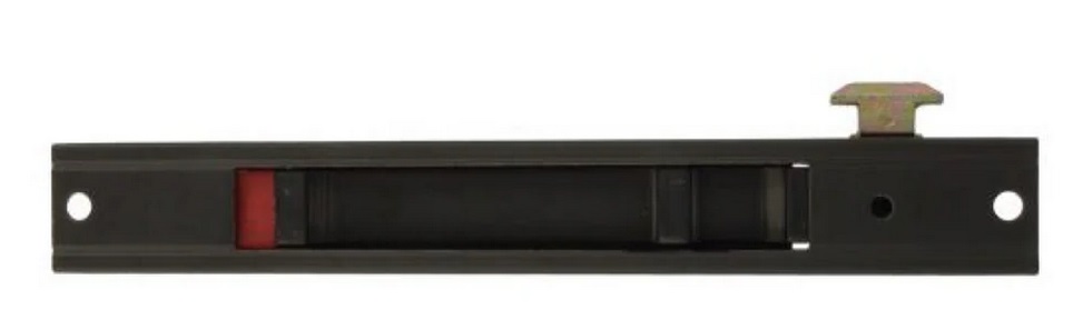

I used the spring from an aluminum door lock.
There are many compression springs available on Amazon. I'll copy you one, that is very similar:
Compressed Spring,Wire Diameter 0.03",OD 0.2",Free Length 0.39" Spring Steel Extended Coil Compression Spring 10Pcs
To install the spring, it is easiest to remove two of the 3 screws and loosen the third. With that, we get the angle, we turn the mirror until it is on top of the spring and we place the rest of the screws. It is very important that you leave the base of the mirror as parallel as possible to the support. With that you will have 90% of the collimation.
Then, with the mirror in your hand, loosen the screws a full turn and check that you still have a good grip on the mirror. If not, the spring is too long and you should cut it by 2 mm. If you have a good grip, squeeze them again and you already know that you can collimate by loosening up to one turn safely, but if you have left it fairly parallel, you will not need to loosen as much.

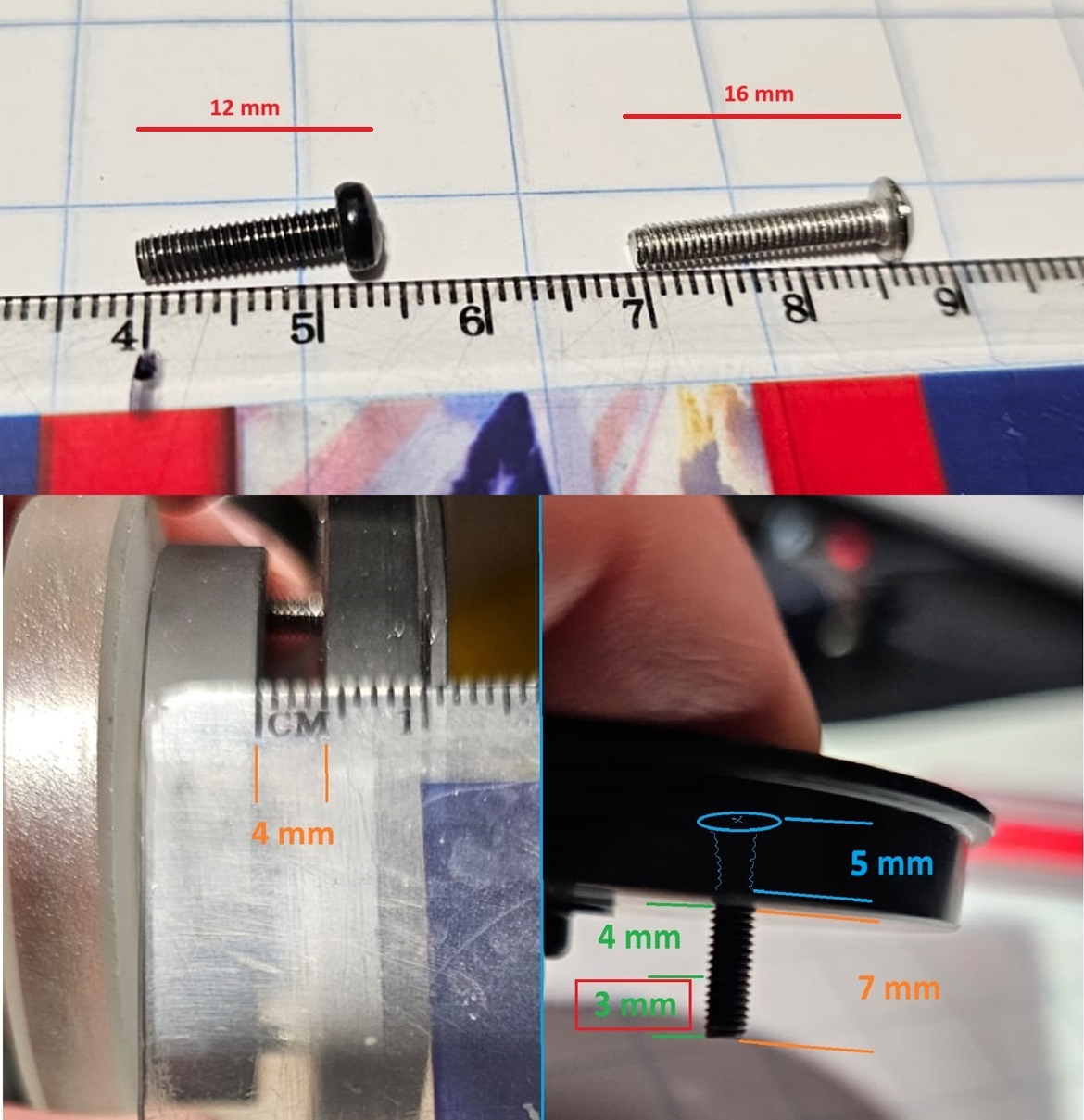

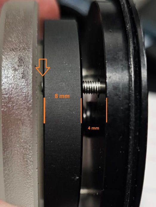

Hi, Ian.
I show you an image showing the secondary mirror measurements of my Celestron C8 EDGE.
The factory screw is 12 mm. 5 mm remain inside the upper support, 4 mm is the original spacing that I have not modified to avoid variations in the Back focus, approximately 3 mm is what remains pinked and is what maintains the secondary mirror.
The total thread of the lower support is approximately 8 mm, so if we want to have more security and support and take advantage of the 8 mm thread, the screw would have to measure 5mm+4mm+8mm= 17 mm long. I have used the 16mm screw which gives you 8mm clamping, which threads the entire clamping body and I can see when it goes through it. When it appears just half a mm from the screw at the bottom of the fastener, I know I'm at 4mm of spacing.
On the other hand, I measured how much the screw rose or fell when turning it one full turn and it is approximately 0.5 mm.
I adjust, with the mirror in hand, each screw until I have a spacing of exactly 4mm.
Once you have the 4 mm spacing on each screw, the mirror is level and when collimating it is already very close to the desired point, with less than one turn on each screw you reach the desired point, which maintains 8mm of support and together with the tension of the screw it maintains collimation.

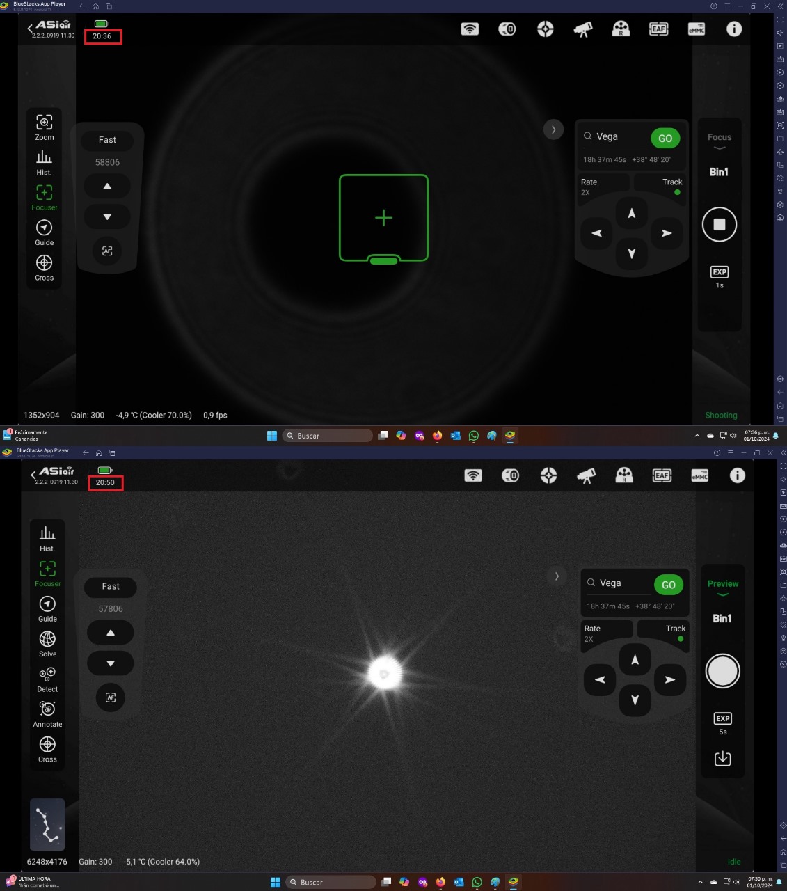

The clouds are finally starting to leave and yesterday it was perfectly clear for a few hours.
I was able to collimate the C8 EDGE like never before. I'll tell you how I did it.

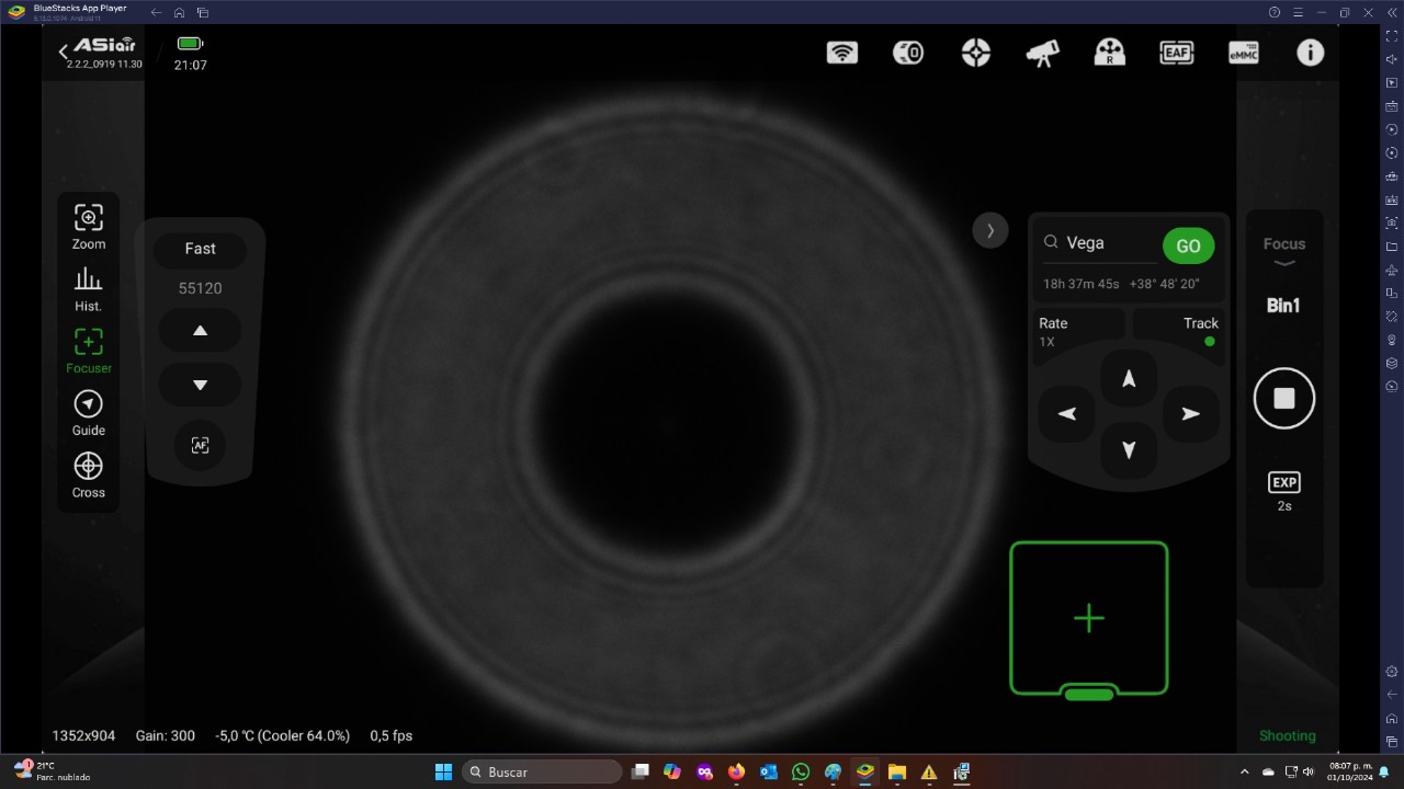

First, after installing the compression spring and changing the screws to M3 16 mm,I made sure the distance between the base and the mirror was exactly 4mm on each screw.
I placed the secondary mirror and defocused. Then I focused to see what it looked like with the Tri-Bahtinov mask.

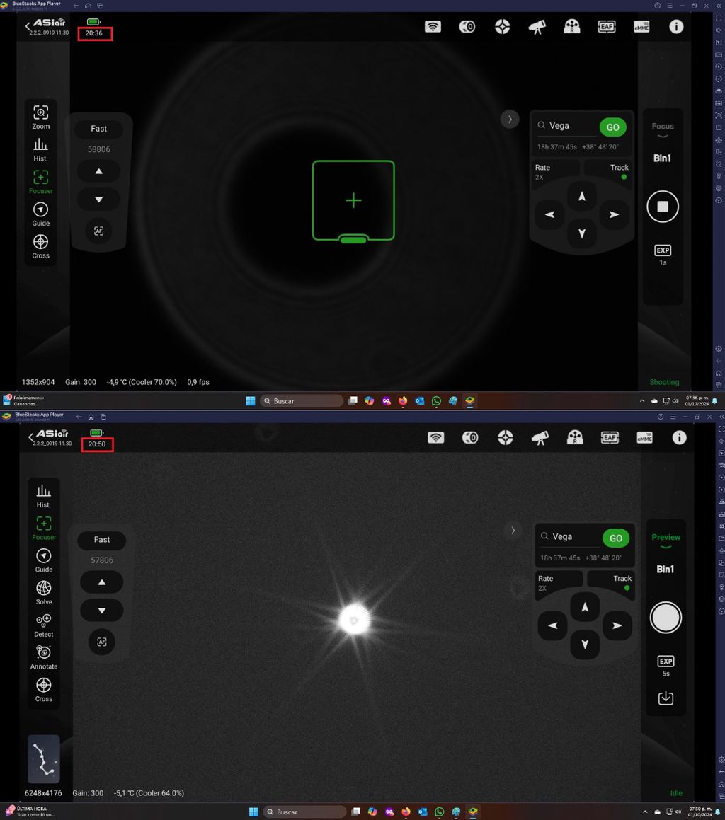

Now the collimation begins. First of all I used Asi Air Plus so I could have the phone next to the telescope. I chose the focus function as it allows me to take photos every second and I can see the changes in real time. The success of this collimation, unlike other attempts, is that the star occupies 100% of the screen, which forces me to make micro adjustments to avoid losing the field of view. I make a minor adjustment and re-center. Initially it seems inappropriate but the collimation is very sensitive and so you are very safe. To collimate I do as always, I tighten the screw in the narrowest area and when they are very similar, I use a transparent millimeter ruler. I measure each part and always compare and adjust to the narrowest part. When I want to go back I simply loosen the screw and the spring returns it, it is the same as tightening the two opposite screws.
The result after just over 15 minutes:
 I focus and put the Tri-Bahtinov mask on, to see how it looks.
I see that the mask is more precise than the blurring technique, so I do the first steps with the star out of focus and after putting the mask on,  the micro adjustment can be made.

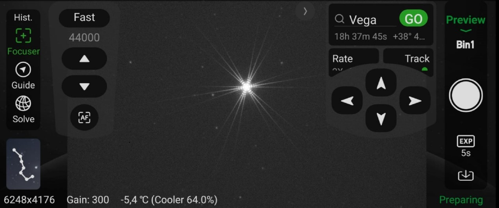

In my case it was almost perfect but I made some micro adjustments looking for the best approximation. The result:

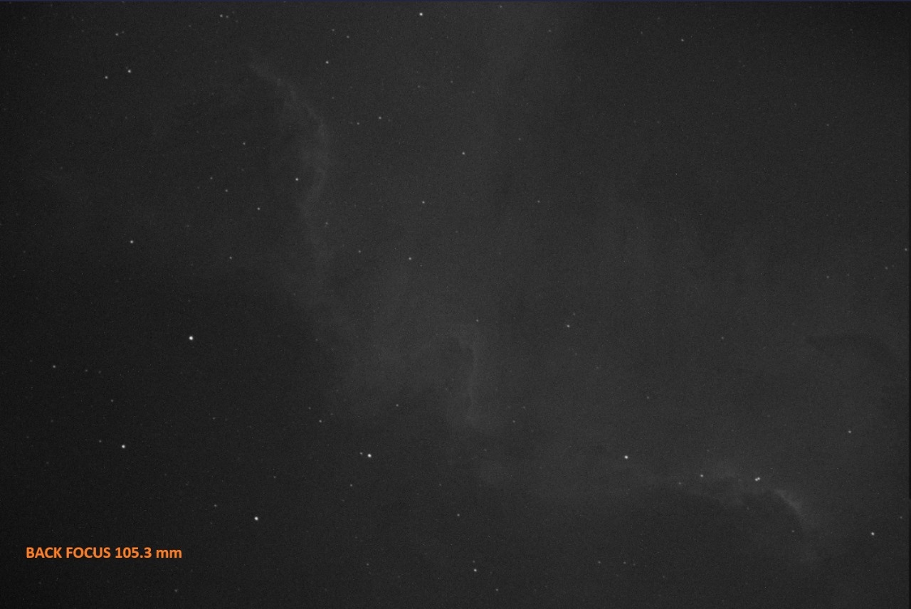

My problem was Back focus. When I used the manual filter holder the entire system was 105.3 mm, but when I put in the EFW it was 1 mm shorter. When I did the collimation everything looked fine, but the stars were very big.
I got a 1mm spacer and it reduced the size considerably. So the first thing to check is that you have the 105.3 mm Back focus and then start with the collimation.
I did a test to see the size of the stars and I loved the result, because with processing in Pix Insight we know that we can reduce the size of the stars and improve them if necessary.
The test, 300 s BIN 1 on NGC 7000, The Wall.
I hope it's helpful. Thank you for asking, because trying to find a better solution, I have perfected my collimation technique in a simple way and understanding how my equipment works.
