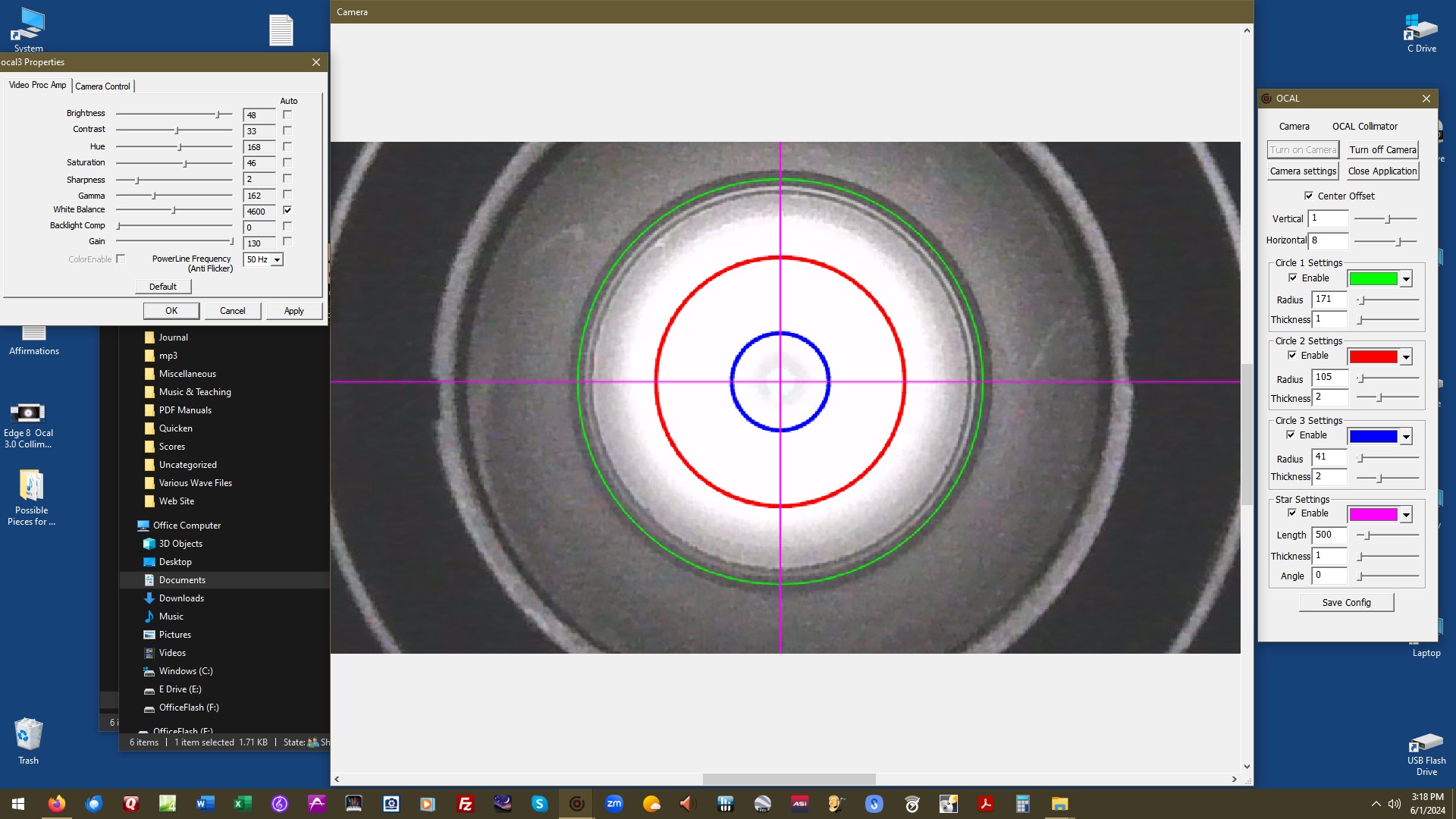

Using the OCAL 3.0 Collimator is proving to be more difficult than I thought.   I have tried collimating with and without reducer, with and without OAG and with and without the 21mm filter holder.   I cannot seem to get the red circle to line up with the white area.  When I line up the crosshairs, the blue circle and the green circle, the red circle is not fully concentric.
Does anyone have experience getting the Edge collimated and then taking it outside for a star check?   My stars are not good enough for astrophotgraphy and I am beginning to wonder if it's my lack of skill or the collimator itself just isn't accurate enough.  If it's not, what are my options for indoor collimation?  Standing outside and trying to collimate at 1422mm or 2032mm focal length while the star is moving rapidly out of the field of view is something I am not going to spend time doing.  I'd rather use refractors.  But if I can get this collimated indoors, I'd be happy.  Thanks!
See images: (bottom image is same as top image but the gain is reduced so the red circle issue is more visible)

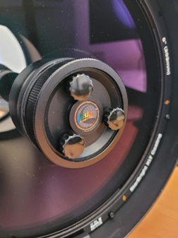

  • Install knobs instead of screws.  These are so much easier to adjust whilst standing beside the scope outdoors in the dark, and you have no risk of scratching the glass with a misplaced screwdriver.  I got some knobs from the local hardware store; the thread on mine is M3.  Fine adjustments are much easier too.

Knobs from the local hardware store.  Cheaper than Bob's and functionally identical.  You'll need three of course.
They are M3 on mine but I believe they can be imperial on some OTAs (perhaps USA).
Installed on the OTA.  Beautiful.

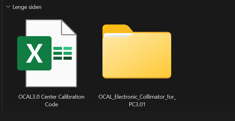

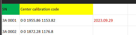

@Jerry Gerber  did you get a hold of your serial number for the software? It sounds a lot like how mike behaved before I got it set up properly. I'll have a look on my laptop, I think I saved the necessities permanently.
Edit: Wrote from my phone but will add a bit more now that I'm on my laptop.
I found the Ocal websites horrible as well, but luckily I knew someone ho had the necessary files in order to make mine work. I experienced the same as you at first, just slightly off no matter what I did. I have the software itself along with a spreadsheet you have to use in order to get your center calibration code.
Yes, I entered the serial number code into the "Focus" txt file as directed.
