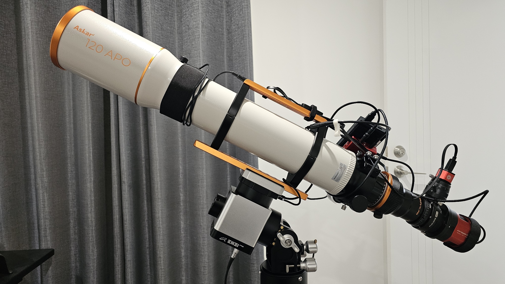

Only just read this post, but I think its certainly worth me mentioning that if you're a newbie, the Askar 120 APO is not really a 'newbie friendly' scope...
Whilst yes, a refractor has less points of failure than a 6 or 8 inch newtonian.. I really can't stress enough the number of complications that arise from having a 1.2m long moment arm... The 120APO is NOT a small scope. It is very long, and although balancing is not critical on harmonic mounts, trust me you will want to get this thing close to perfectly balanced, even on a harmonic mount. I balanced mine by putting a pencil on my kitchen bench top, and balancing the OTA across the pencil, then making a mark on the dovetail in the location where the OTA would balance on the pencil.... Then you need to consider, not only the moment arm and the amount of torque that is applying to the mount, but the length of the OTA and whether or not it's going to clear your tripod legs.
I'm certainly not trying to discourage anyone from enjoying the hobby in any way they would like to, but a 5" or larger APO will bring heartache to an unsuspecting user who's making the step up from a 60mm refractor or a camera lens, thinking 'well its just a bigger lens, how much harder can it be?' - because the answer to that is 'Much'. Askar_120APO_SetUp.jpg

Hi Alex,
Good point on balancing and the inertial moment arm. The early challenges with learning how to use my WO Z81 refractor are all still there.... but now amplified on the Askar 120 APO.
I went to the effort of hypertuning my EQ6-R Pro when I was trying to make my experience with my 8" Newt more user friendly. This made balancing a more accurate and quicker process as friction was significantly reduced in both RA and DEC axis. The other lessons learnt from that experience (e.g. careful balancing in 3-axis and positioning counterweights as close to the center of the mount as possible) definitely has benefited me with my Askar 120 APO experience.

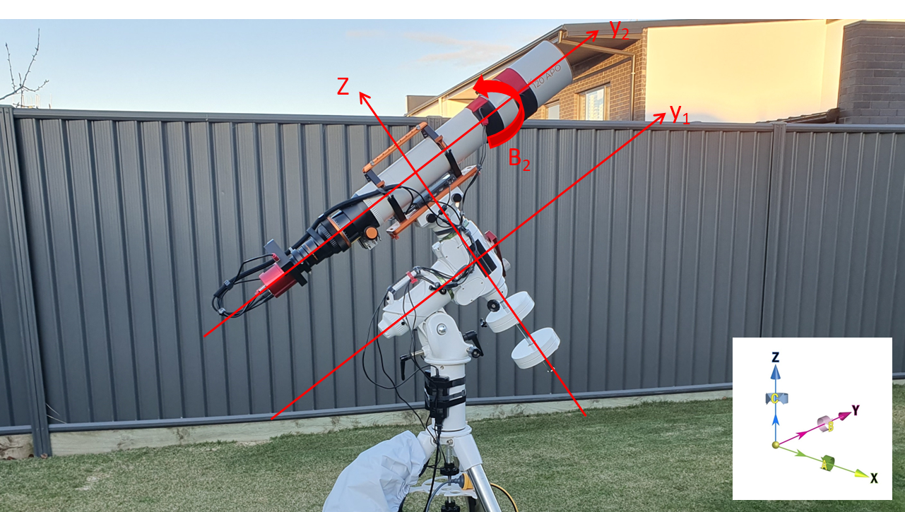

Adam,
I'd really like to learn more about 3-axis balancing.   How can you do that when there's only 2 axes on the mount and only 1 place to put counterweights and one place to slide the scope back and forth on the dovetail.
Very interested in learning more....

Hi John, I should of clarified when I refer to the third axis I mean the offset RA axis (Y2) of the telescope tube in its rings. I found it necessary to rotate the tube whenever my EFW was not aligned straight up or down in the 12 or 6 o’clock position e.g. when it is rotated 90 degrees to the 3 or 9 o’clock position in relation to the scope. Without some fine rotation in B2I would always have the scope pull left or right.
Cheers,
