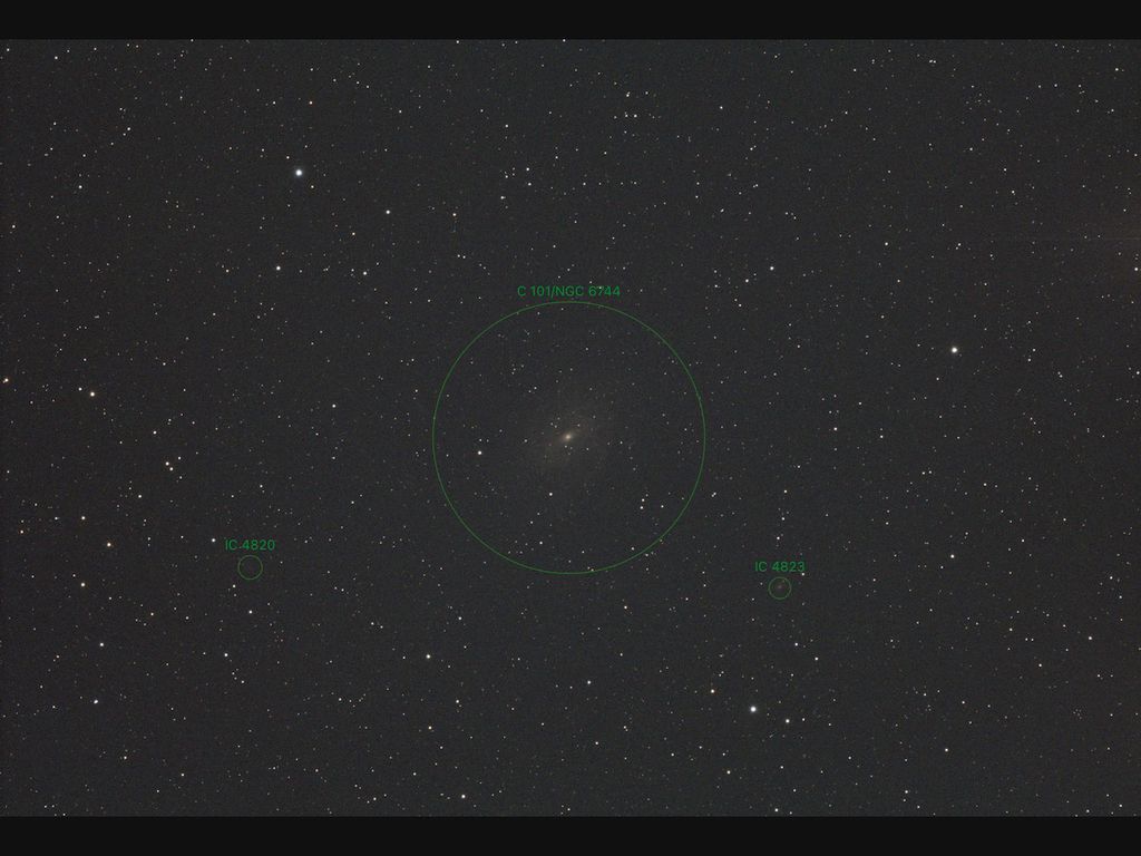

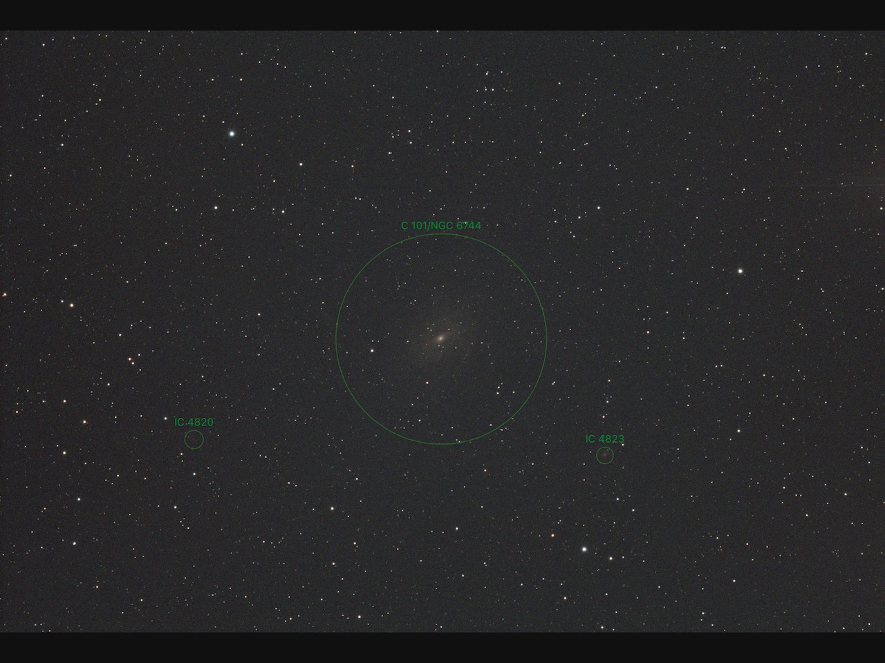

So finally a clear night and the scope is shooting!
The first light:
Googong_Observatory 1.20
Congrats!
Is your image with the 1.0x or 0.8x flattener? I haven't purchased the 0.8x flattener yet and I'm keen to see what people think of its performance.
Niels_L 2.39
Adam Cox:
I have the 1x on there at the moment.
My ASI294MC was acting up (with failed exposure issue) so have to throw some of the lights out... Will stack this weekend end see how it turns out!

Niels_L 2.39
The first light:
The stacked image: https://astrob.in/v1rlhh/0/
This was after just under 7 hours but I'm trying to gather some more data tonight and the next few days. It needs much more data to get all the detail out but overall I am happy with the Askar 120APO!

Niels_L 2.39
I now added some more data, 14h35m in total.
https://astrob.in/v1rlhh/B/

Looking stunning mate! My 120APO gets here tomorrow and I'm dead excited to get it out (though the forecast, as expected, is rain for the forseeable future.

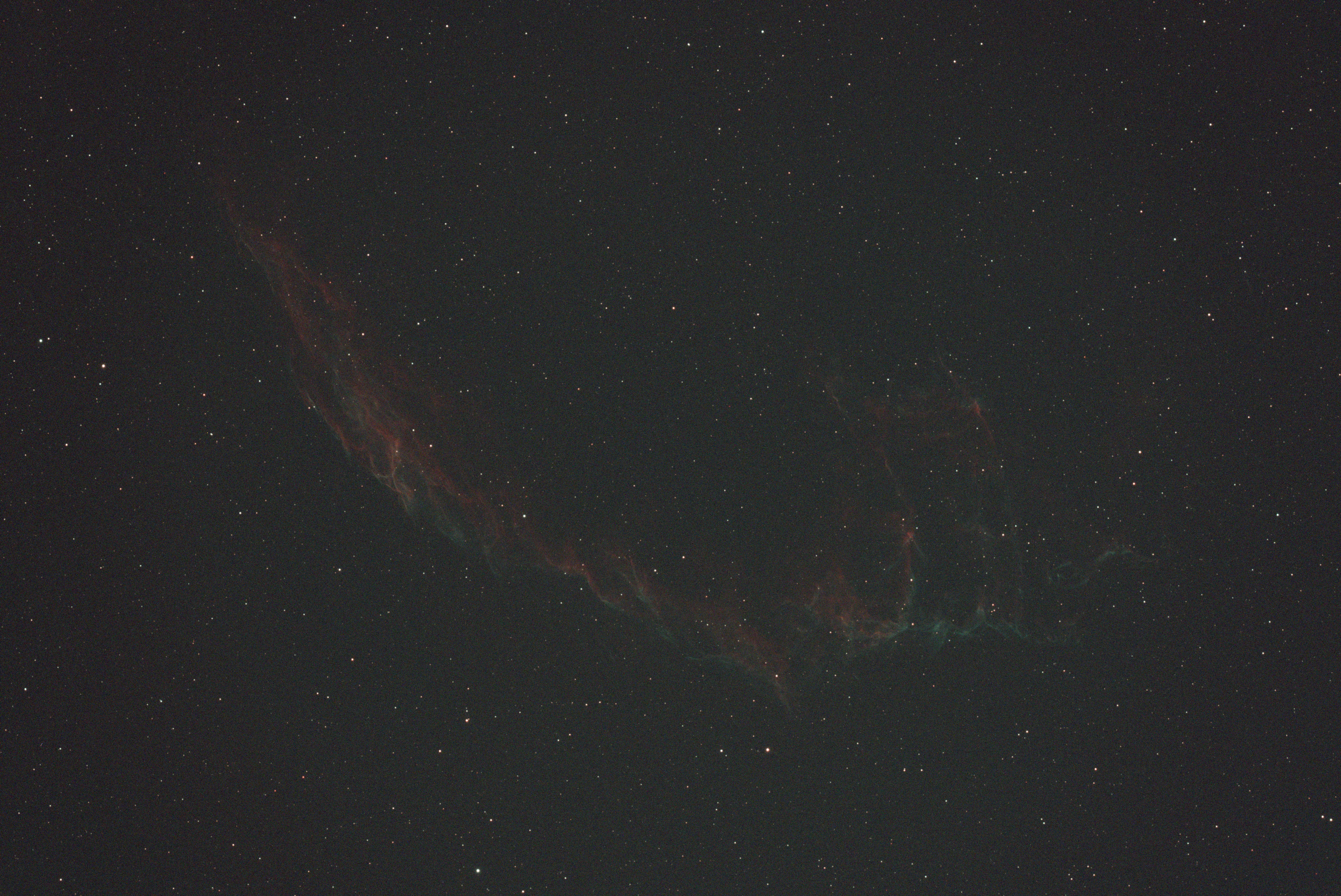

joe90605 0.00
Hi Niels,
I've had my 120 for a few months now, and I'm really enjoying it.  This is my 2nd refractor, the 1st being a Redcat 51 II.  Everything about the scope has meet my expectations, but again, I don't have much to compare it too.  Here is a shot of the East Veil I took recently: https://astrob.in/5ba2za/0/
GiffS 5.49
I am very pleased with my Askar120 APO. I have both the .8 reducer and the 1X Flattener and now have some reasonable time with both. I can honestly say I am very glad to have the option.  Here's a recent image with the 1X Flattener.
https://astrob.in/ile829/0/
And here's one with the .8 Reducer.
https://astrob.in/o1pgtf/C/
Any issues are my ham-fisted processing and not the Askar120. My scope seems very dialed in and a good example. It rides on the AM5 like a dream without counterweights and honestly, I wouldn't want to sling around anything much bigger. The 120 is a big scope.

That is a cracking image…👏🏻👏🏻
can I ask, first of all is the image cropped at all, and second are those Stars straight from the scope, or have they been through BlurX by any chance..?
as they look perfectly shaped to me, am interested as every frac I have owned has some amount of elongated strs in the corners with a 2600 camera..

Thanks.  Image only lightly cropped, auto-cropped using WBPP script.  I did use BlurX for the final image, but here is a FIT file converted to JPG so you can get an idea of the optical performance raw...Light_NGC 6992_180.0s_Bin1_20240806-214651_0006.jpg

Thanks very much for that, and wow that is excellent as far as star shapes go, better than my Esprit 100, as nearly twice the price, I see some CA, but of course easily corrected and not an issue at all when mono imaging…
is this at the native f7 with flattener, or with the reducer fitted…?
Super, thanks..👍🏻

Native F7 with 1.0 flattener...
