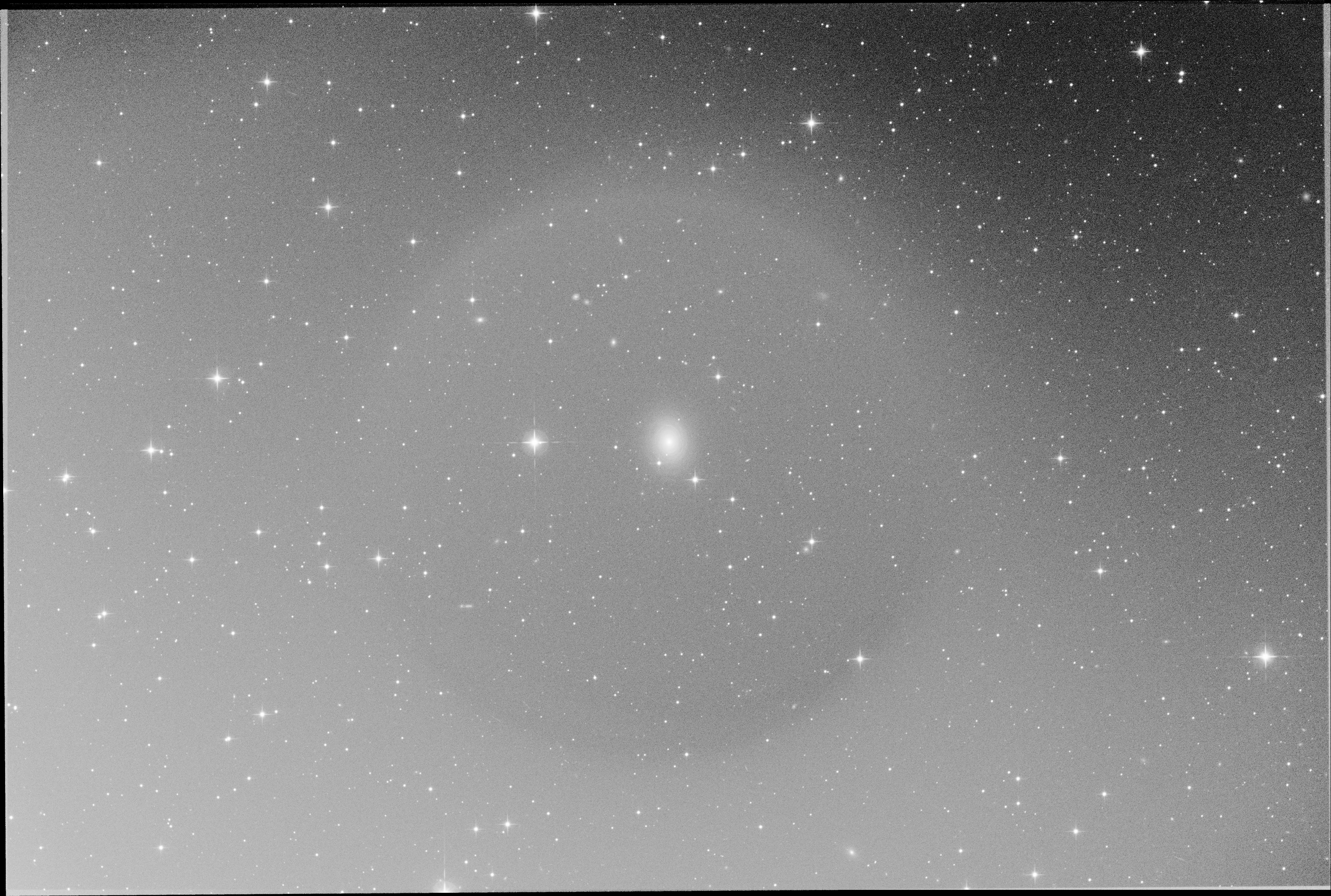

I am doing astrophotography for years now out of bortle 6 and had many telescopes. My largest 12 inch Quattro from Skywatcher is my main worry atm.
Here is the problem: My flats do only work very randomly, depending on the sky I look at.
The following images are from the same night, with no moon and Ive used the same flats for both. The one where the flats are quite working was the blinking nebula which stands very high in the nightsky, where less lightpollition hitting my sensor. Captured with the red filter.
Now look at this: As I said, same night but only 2 hours later I capture this one. Again, same flats are used and also the red filter, except this one is right in the lightpollution
I can say that my newton is probalby the most lightleak proof tube out there. I checkt everything. Also there is no direct light hitting my tube.
I did captured a 3rd object that night, also low on the horizon. Same problem...

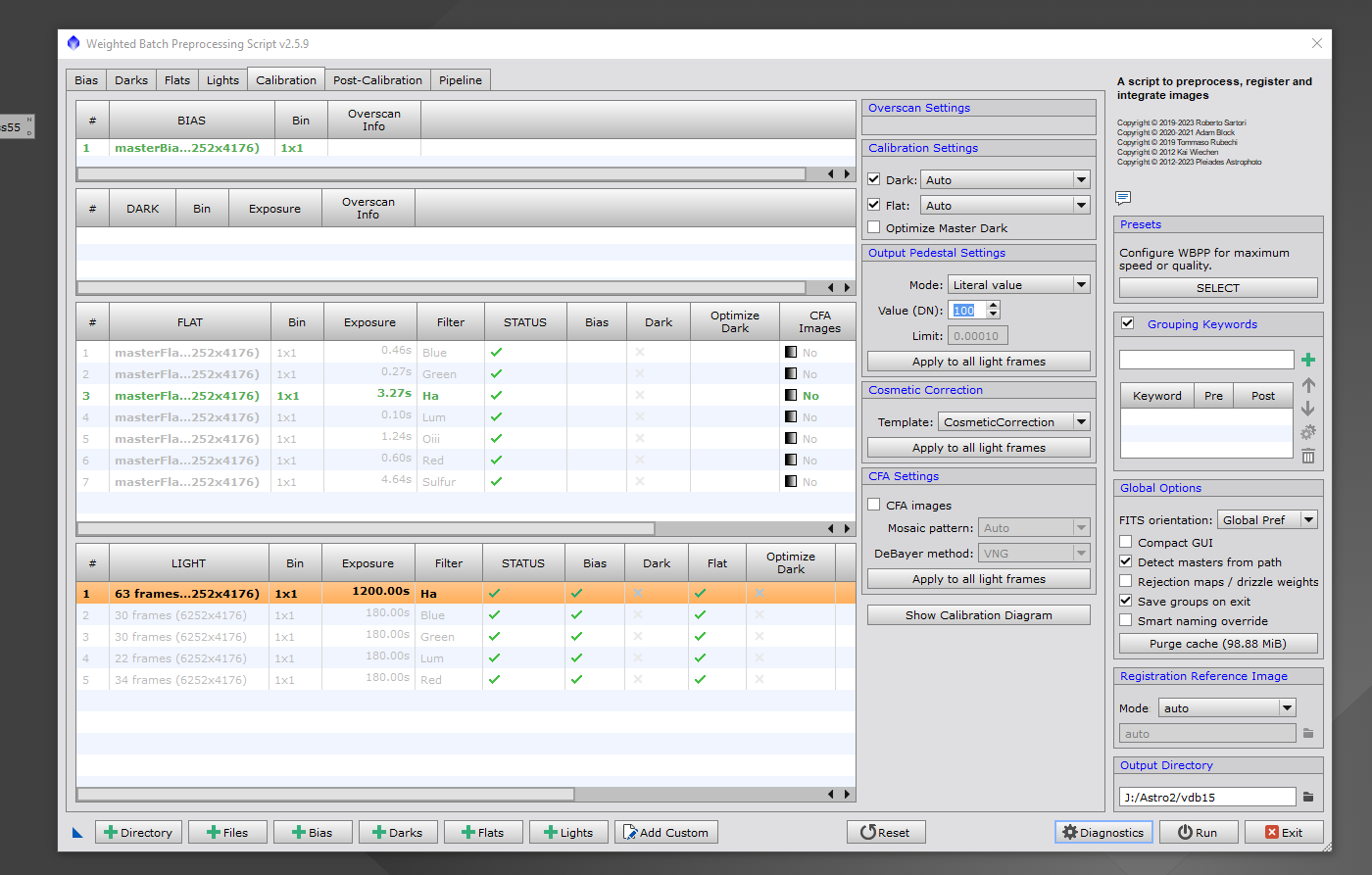

Yeah, again, I don't know all the science behind it.   I suppose by taking longer bias, you're essentially taking a dark flat... but it's all the same to me.  It's what fixed alot of my calibration issues in general, and I've stuck with it as gospel since.
WBPP - Weighted Batch Preprocessing in Pixinsight.

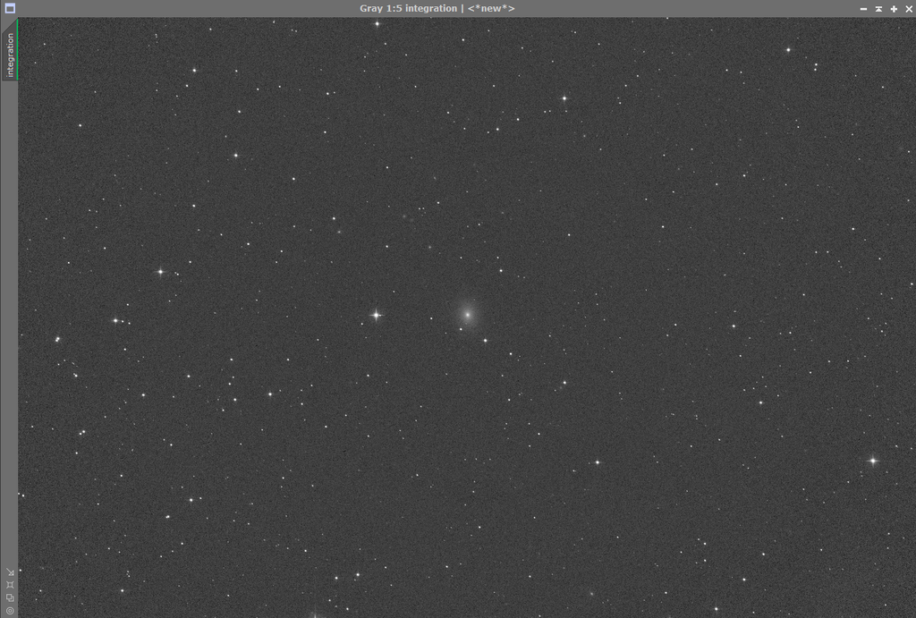

Here is my WBPP window showing where you add the pedestal (highlighted).   I presume you can figure the rest out.   If not, google is your friend.

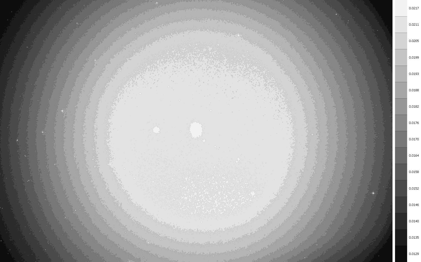

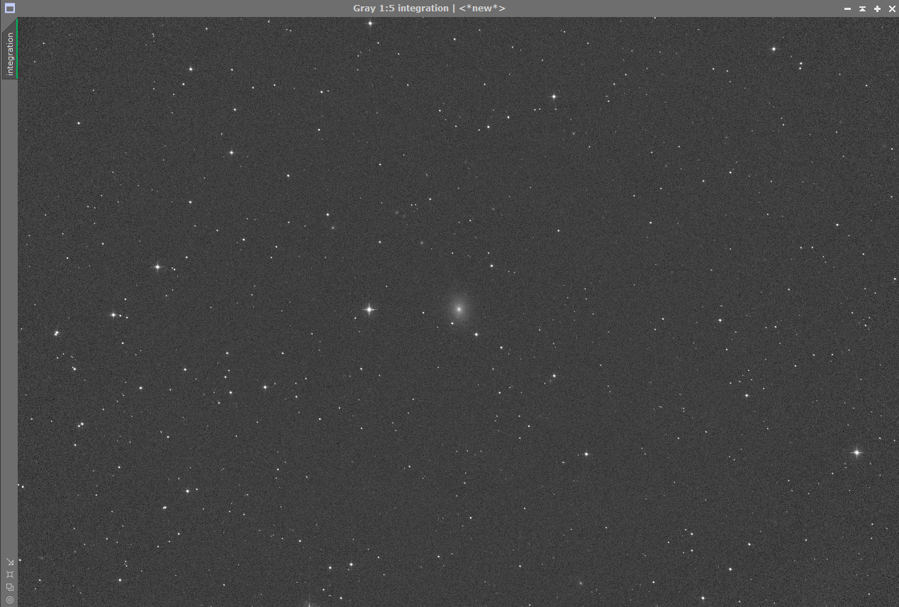

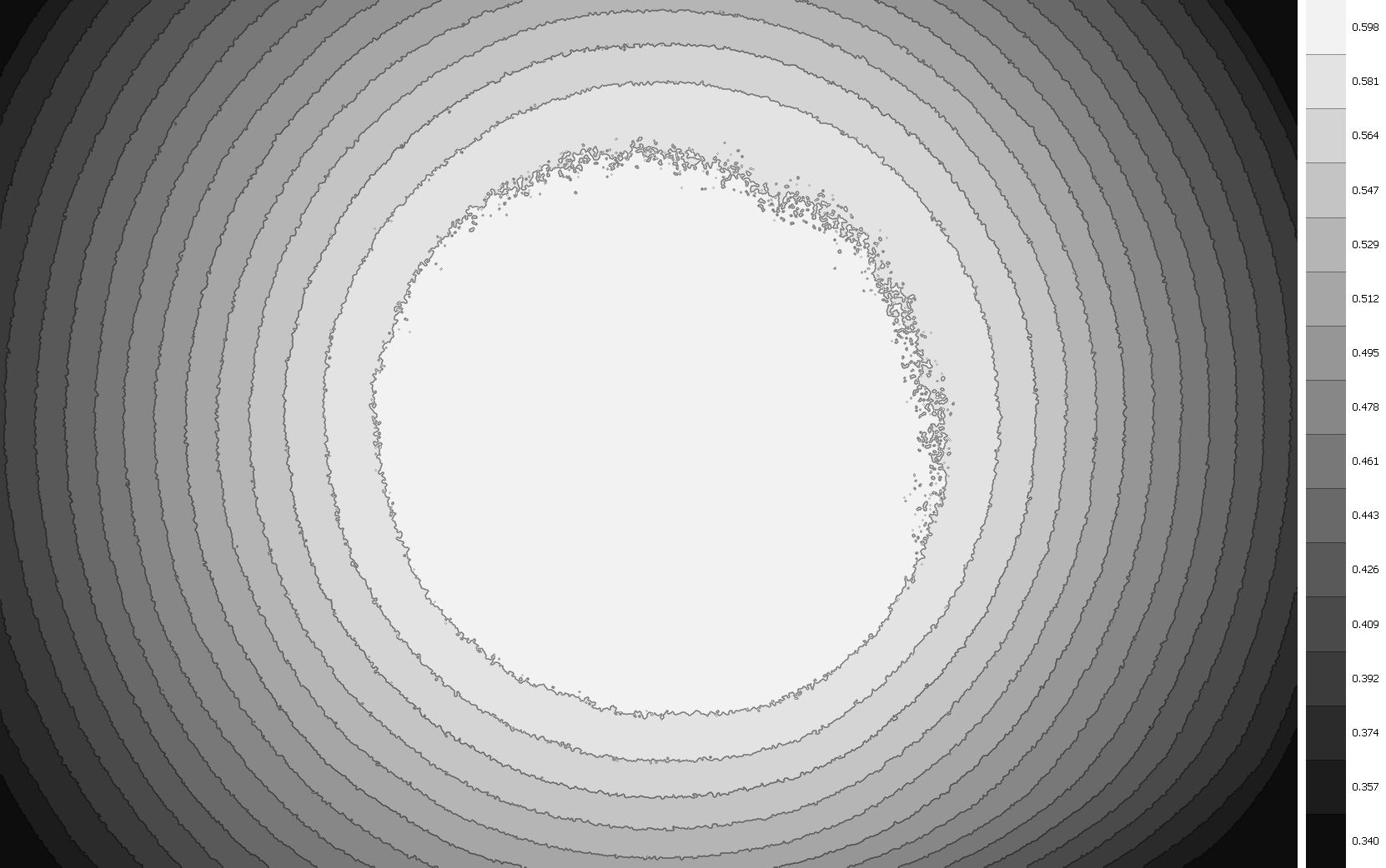

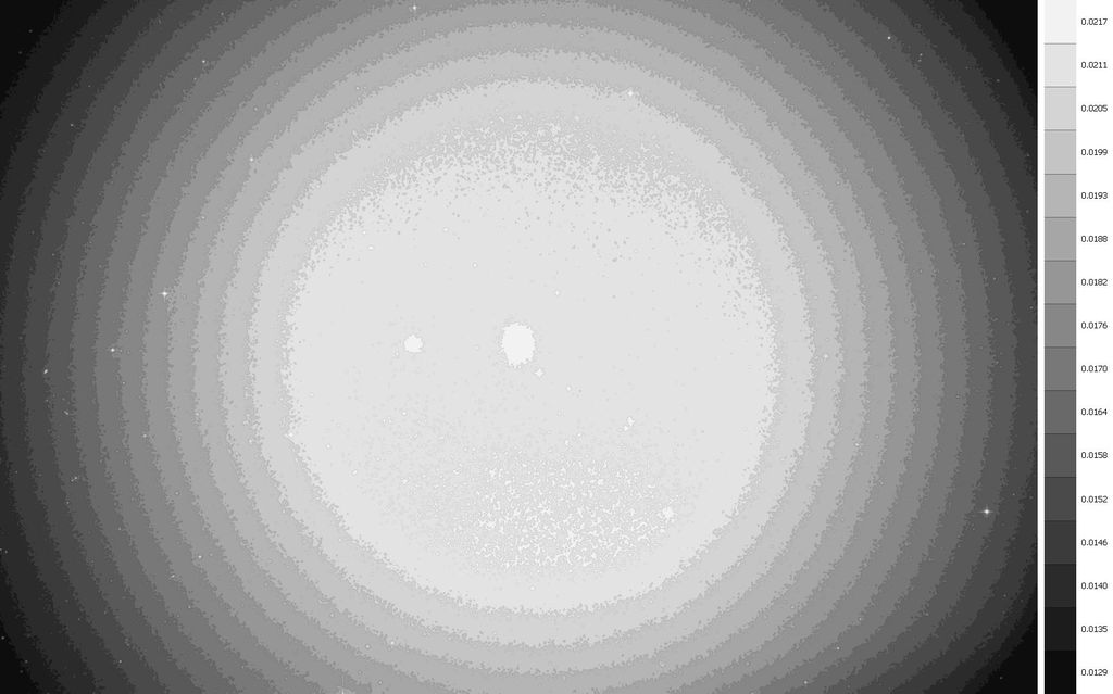

So, I've check what you made available and carried out few tests. The results so far:
1. Apparently (since you processed those I can only relay on what APP writes on the header) both bias and dark have a zero offset while all the others have 100, Gain seems the same (100).
2. The isophotes of the flats and lights are different (the ratios between max and min values is 1.682 for the lights and 1.759 for the flat) so potentially you are undercorrecting, at least at the corners, and overcorrecting in the middle, see below.
Flat Isophote:
Light Isophote:
3. The residual (1st iteration) is quite significant and it is a mix between that of the flattening operation and the light pollution, which I assume is quite significant in your locale:
4. By comparing the 2 isophotes above it can be seen that a shift has occured, potentially indicating mirror shifting (or camera, for what matters) between the two instances.
5. You have very significant light drop at the corners, of the order of 40%, which isn't good and clearly indicates that the illumination with the Nexus isn't great and you'll be dealing with noise issues unless you crop off the corners (about 15% either sides at least).
6. You also have significant light pollution and I'd venture to suggest that a LP filter ahead of the FW would improve things quite a bit, both in the final results and in the flattening of the lights. Note that significant light pollution worsen field flattening, especially at low focal ratios (e.g., f/3 like you have here).
After all is said and done I managed to get a decent image after all but with significant use of the flattening tools in PI:
