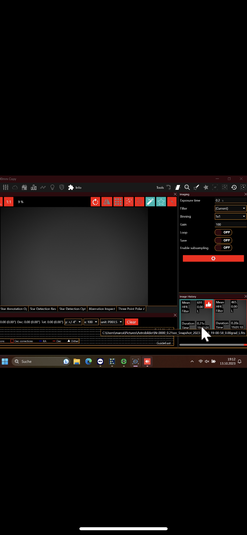

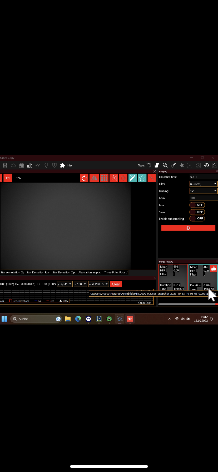

I did some testing tonight and tried my color camera (same sensor / size) I did noticed something strange, with both cameras.. when I am taking 0.19 sec exposures the vignetting looks fine and I got a ADU as expected. When i do 0.2 sec exposures, the ADU is increased like it should be. When I do 0.21 however anything goes wrong. The ADU is highly increased and the vignett shifts... I think both touptek cameras got a readout problem! IMG_7130.pngIMG_7131.png
I am testing if this is happening to the ZWO 2600mm too. If so there is maybe something wrong with cable or power management. This Problem also apears in other programmes. And on the sky! So no flat pannel here

Thank you so much for that information!!!! I was hoping someone has this proboem too... i was wondering if iam just dump or something. I will figure things out. Would be insane if many touptek cams got this problem
tosjduenfs 1.43
I dealt with this exact issue for years as well.  I chased every possible location for light leaks, 3d printed mirror cell covers,dew shields, electrical tape, laser cut aluminum focuser support brackets, flocking, Black 2.0 paint,  upgraded spider and focuser because I thought something was moving, etc.  The issue even followed me when I got a carbon fiber ONTC.  No matter what I did I always had the embossed donut artifact in my images.   I didn't have issues with SHO but only LRGB.
Like was said above, eventually I found a thread about someone dealing with the same issues that advised taking very long flats.  I started taking 10 to 15 second flats and the issue finally disappeared.
