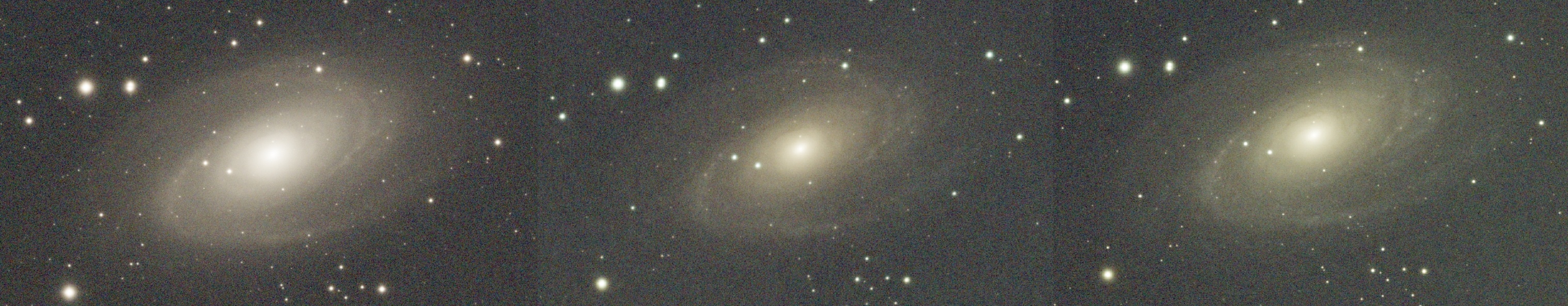

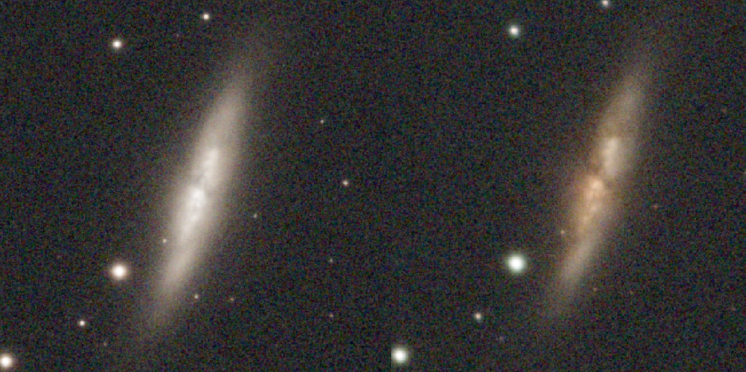

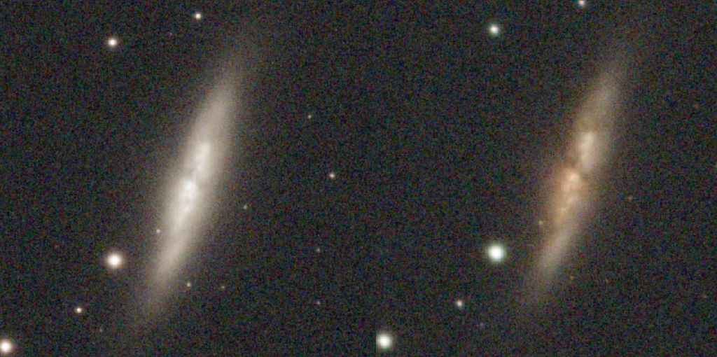

JoepsAstronomy 0.00
I tried IR Pass too on M81/2 but visually to me it feels like on the right (IR Cut) there is more fine detail. It's only a single sub compared, but I didn't take more than 5 subs as I was afraid I'd lose precious shooting time. IRpas-vs-cut.jpg
And on M81 IR Pass, Moon & Skyglow and IR Cut. I felt the last one still had the most detail. Maybe on the IR Pass I should lower the exposure time as it seems very much overexposed and maybe I lose detail because of that.
Each image is 5 frames of 300s stacked.
