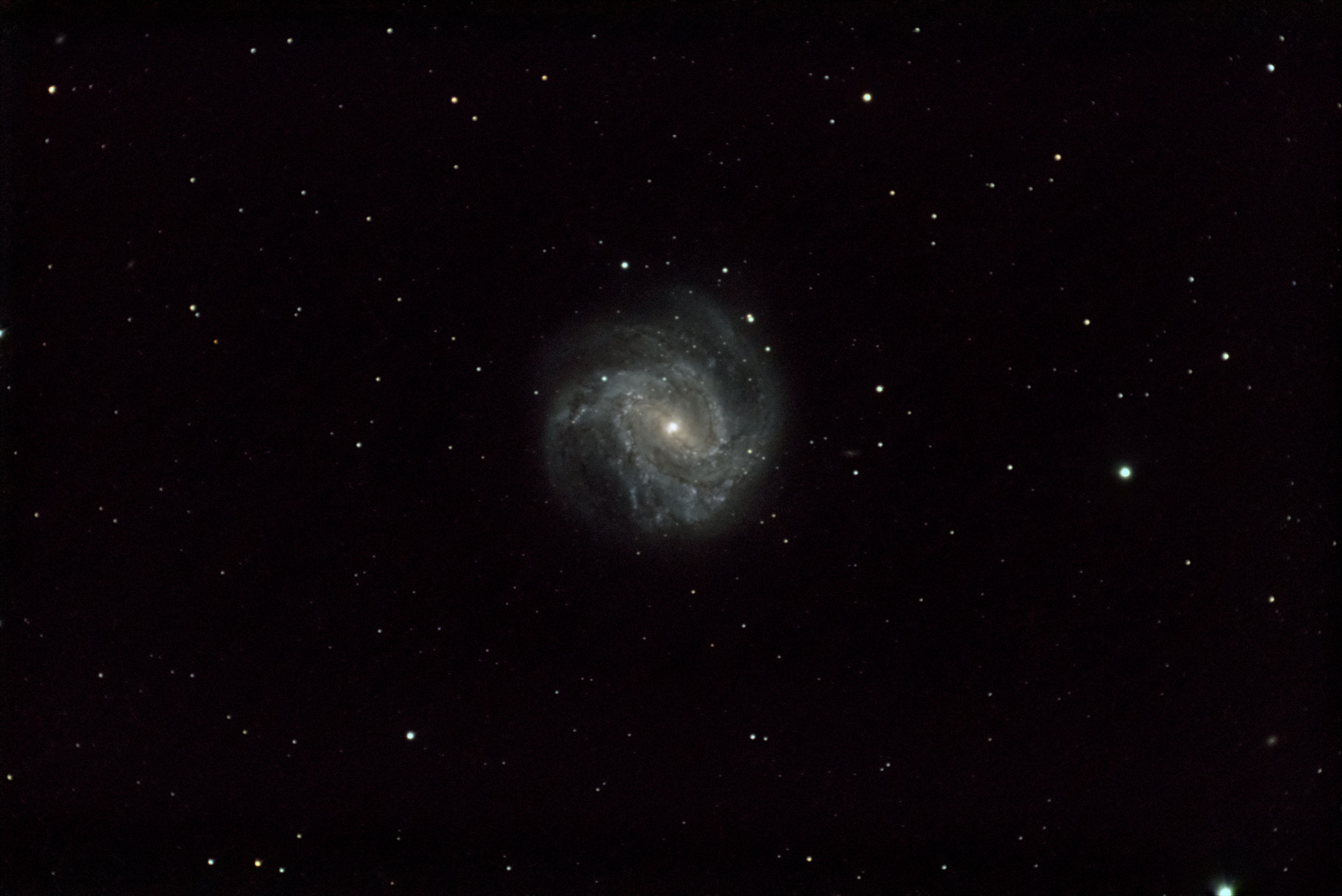

Preface: I apologise if this is in the wrong section of the Forums, I wasn't sure if this should be in RCC or here. Hey guys, I have been doing astrophotography for about a year now with a relatively unoptimised setup. Currently I’m running a Skywatcher 127 mak with a unmodified Canon EOS-7D mounted on a HEQ-5 mount. So far I’ve been really happy with the results I’ve gotten, but as with what I think many others think at some point along their journey, I’m always looking to learn and improve. I was initially just going to post an image and ask for peoples feedback, but I thought it could be more interesting to see other people’s edits of the original (stacked) data, regardless of the workflow used. It could be anything from basic editing to full Pixinsight utilisation, what I am mainly curious about is how far the data can be taken in post processing and at what point it is limited by my equipment. For reference, below is my favourite attempt at the data (compressed jpeg) using free software (DSS, Siril, Astro-sharp and Gimp). I took the image about 5 months ago with a stock Nikon D3400 (not the Canon I use now); about 4 hours of lights calibrated with Darks, Flats and Bias frames, 60 seconds per exposure. I should have linked the data here. If people want I can try and dig up the raw lights and calibration frames if people want to do their own pre-processing.  |

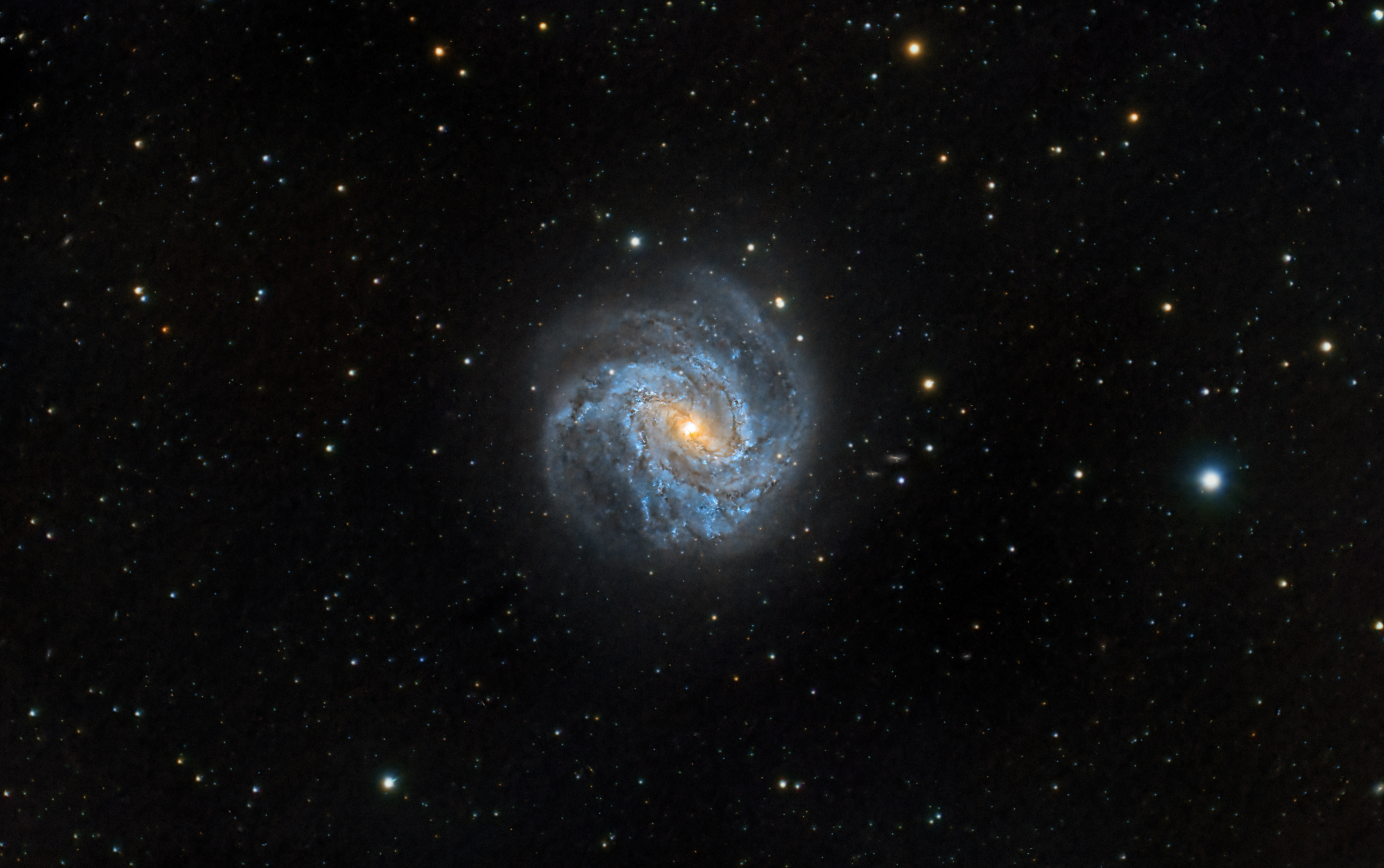

This is a quick process with PixInsight and the XTerminator suite, resampled 0.5x.  Daniele

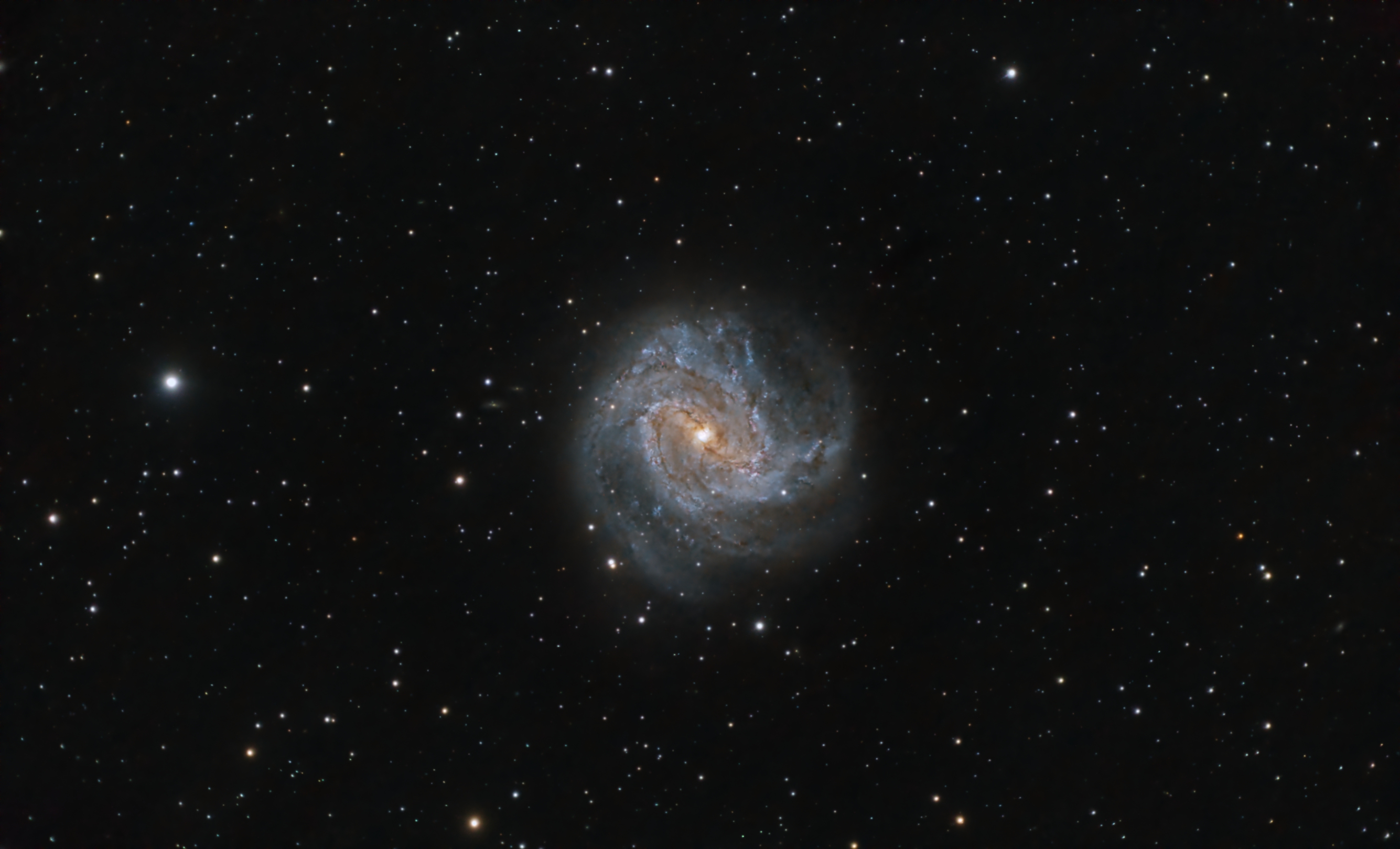

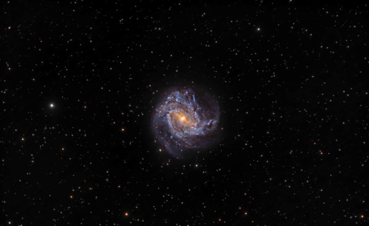

 My quick edit using Pixinsight.

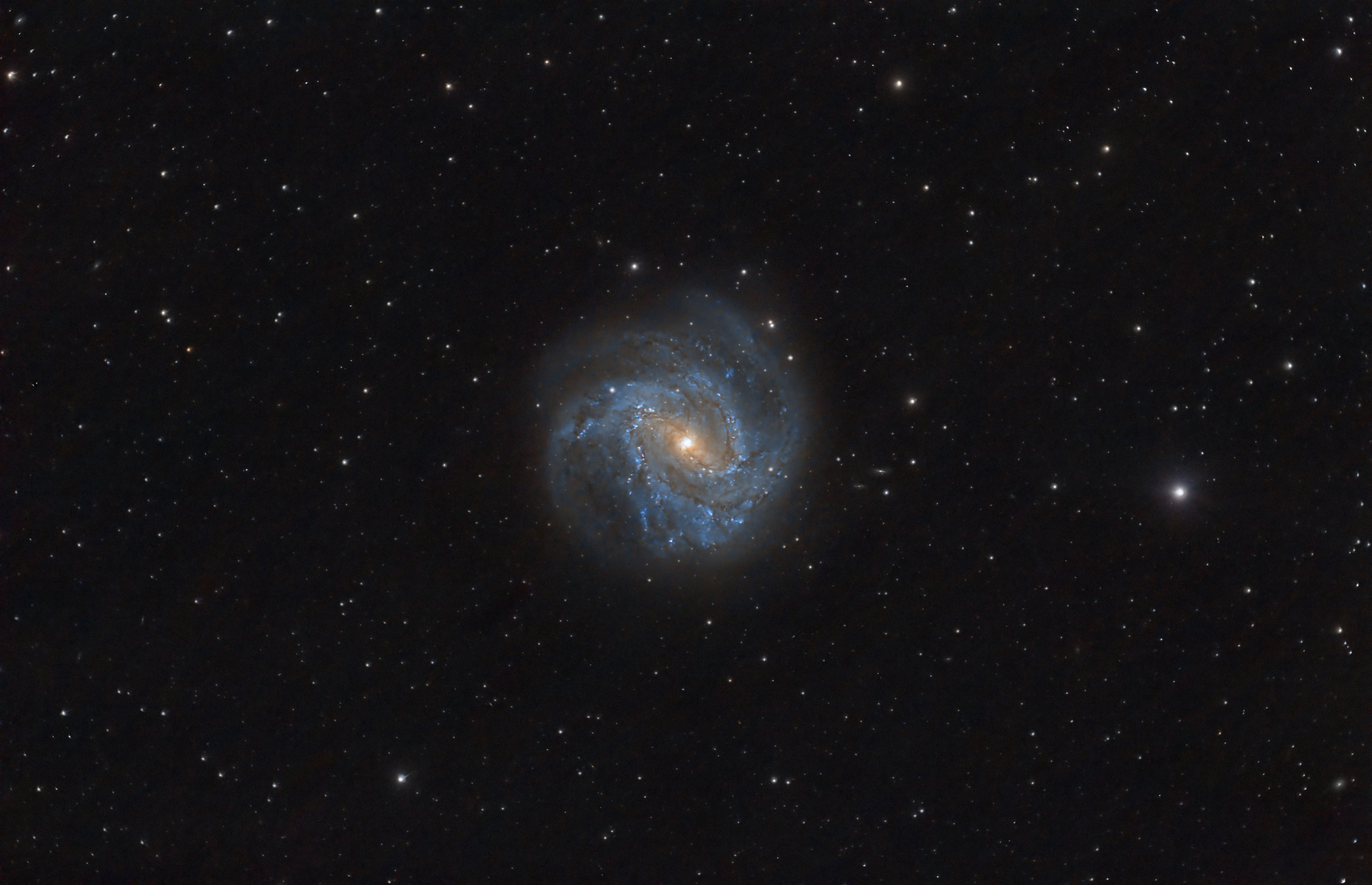

Quick run through Pixinsight. A bit of walking noise noticeable, but it can be hidden fairly well.  |
Daniele Borsari: This is a quick process with PixInsight and the XTerminator suite, resampled 0.5x.
Daniele Thanks so much for contributing! Wow… just wow. You’ve managed to pull out so much more detail that I didn’t think was even in the data, it’s incredible! As a non-Pixinsight user (at this stage, might changed after seeing this XD) and if you have the time, could you explain what you did in Pixinsight? Do you think it would be possible to achieve similar detail with the software I’ve used? I understand there’s a reason Pixinsight and the Xterminator suite are paid, but I am also not perfect at processing, not by a long shot, and always wonder what I could do better.
could you explain what you did in Pixinsight? The first thing I did was removing the gradients with Graxpert AI with smoothing set to 0.5; after that I used BlurXTerminator set to sharpen stars at 0.15 and sharpen non-stellar at 0.55; then I ran SPCC to calibrate colors. On the starless linear image (you can remove stars with Starnet or StarXTerminator) I did some noise reduction with NoiseXTerminator set to denoise 0.85 and detail 0.45. I stretched the image with GeneralizedHyperbolicStretch and made the core a bit dimmer with HDRMultiscaleTransform. I then did some Curves adjustment (S curve, saturation etc.) and a final run of NoiseXTerminator with slightly less agressive settings. Stars were also stretched with GHS and put back with the ScreenStars script from Bill Blanshan. Do you think it would be possible to achieve similar detail with the software I’ve used? I've never used Astrosharp, but I think that Siril is a great software. You may also want to try the 45 days free trial of PixInsight, but expect a steep learning curve. BXT is very easy to use and does a terrific job at deconvolution and NXT reduces noise without washing out the details. Daniele
Phil Wright: A bit of walking noise noticeable, but it can be hidden fairly well. Thank you very much for contributing! Yeah the walking noise is a pain, shows up in lots of my images to varying degrees even with dithering. Doesn’t help I’m not currently guiding.

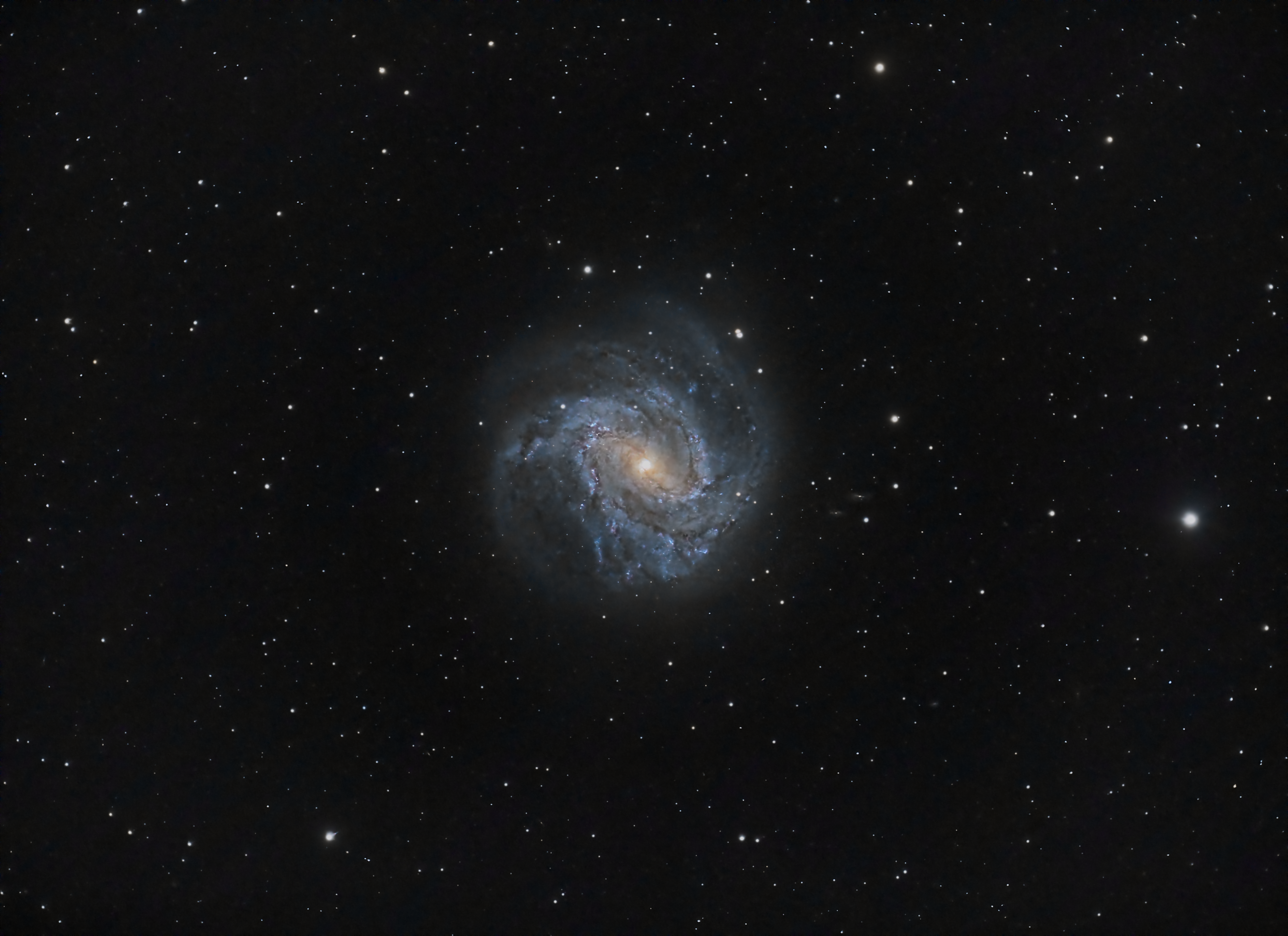

Completely done with SIRIL (Autostretch - Color calibration - Background extraction - Starnet - Starless stretched - Color calibration - Stars recombined with some stretch) then some Photoshop Camera Raw (Color noise reduction - Black point slider changes - Shadows slider changes) within 15-20 minutes Sorry guys, my processing is horrible when I compared it to the others. |

My quick edit using Pixinsight. Thank you for contributing, another great Pixinsight edit! Did you use Blur Exterminator or Noise Exterminator at all? If you have the time it would be great to hear roughly how you processed it!
Sorry guys, my processing is horrible when I compared it to the others. This is great, and thanks for the detailed workflow! I actually think there’s lots of detail in there that might come through a little with a High Pass filter or a little sharpening and contrast. I think at this rate it’s hard to replicate what people can do with Pixinsight, but that doesn’t mean anything else is bad!
