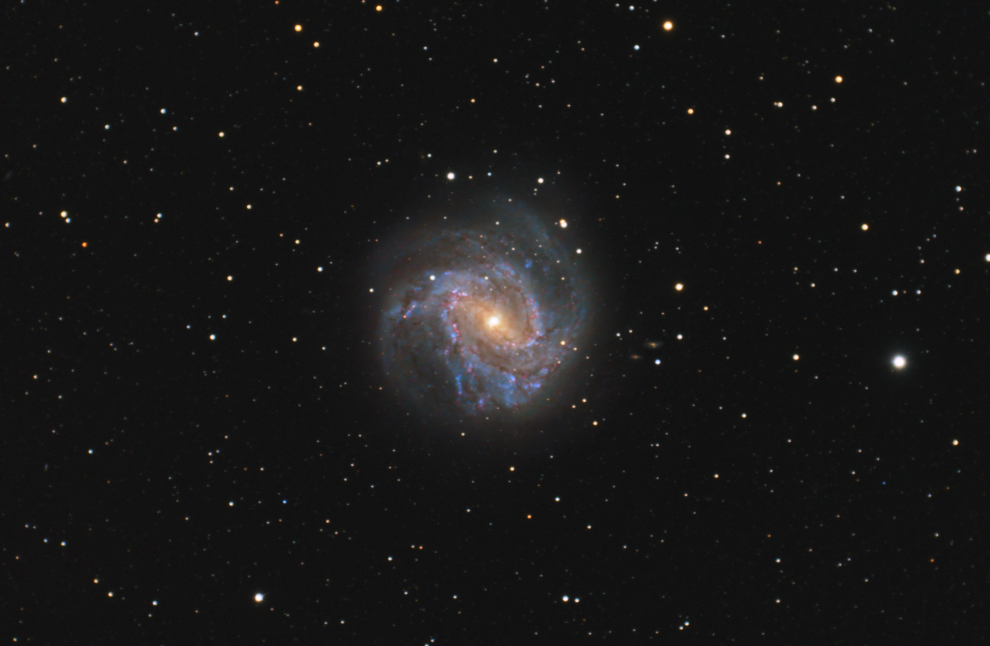

Complimenti per il contributo! Dettagli fantastici nel nucleo di questo e ottimo colore IMO. Ciò è stato fatto in Pixinsight o in qualche altro software? I used pixinsight and photoshop for some corrections once the stars were removed. The rc-astro suite and localistogramequalization . On Photoshop I used the camera raw filter.
Zak Jones: Here's my version of your data using PixInsight. Thank you very much for sharing your process, the result looks incredible! I do apologise that there is walking noise and it’s not in XISF format. I hope that wasn’t too much a nuisance to process. I’m really grateful for all of the results so far, it’s awesome to see everyone’s edits. I truely had no idea so much could be pulled from the data, it’s awesome to see. May I ask what pulled you to use Pixinsight? How long have you been using it for?
Pixinsight (LF, DBE, Color Calibration,Decon/Denoise, Masks, Curves Sat, Arcsinnstretch/Histostretch, De-star) PS Selective and combine
 Love the colour in this one, thanks for contributing! As someone that doesn’t use Pixinsight (yet) do you mind elaborating on some of the acronyms? When you say denoise/decon, is that using BXT and NXT?

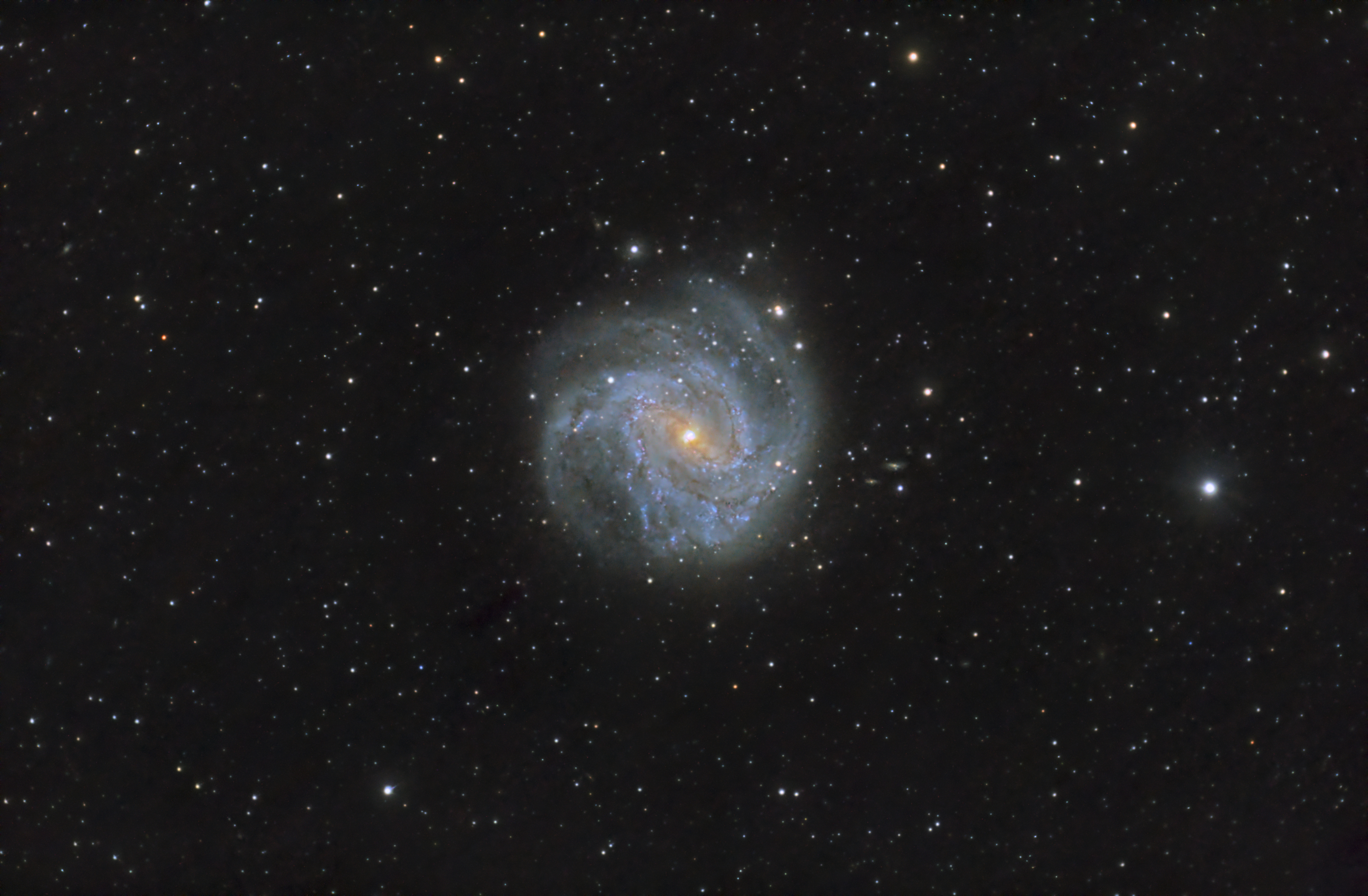

Hi, i just done a quick process with siril, astrosurface and gimp :  Clear skies!

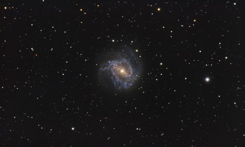

Quick go using PixInsight (plus the free plugins StarNet and DeepSNR).  |

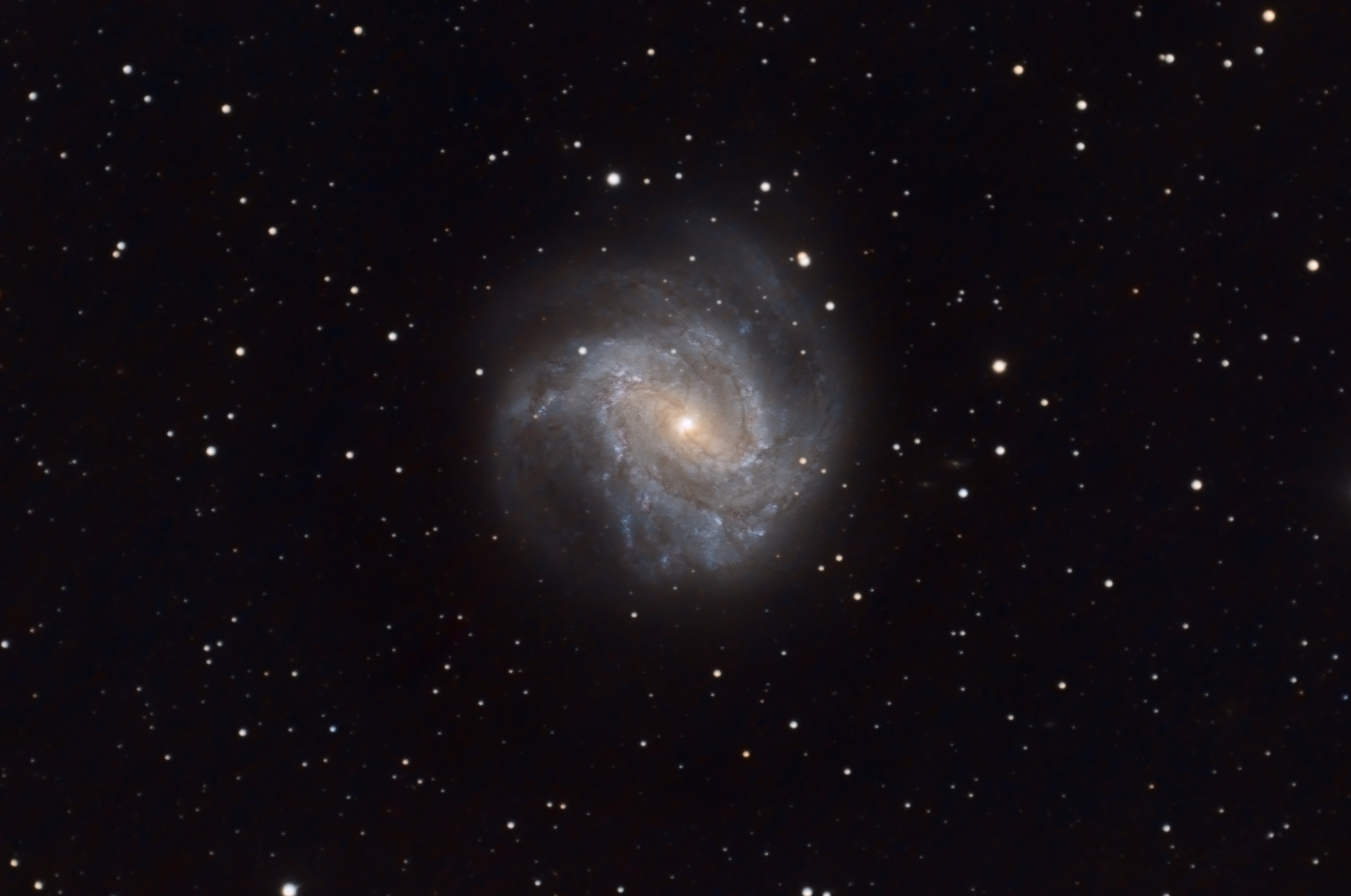

A fun dataset to play with. The background is a bit challenging but the galaxy responds well to deconvolution + MLT sharpening in PI  |
Yes, I do use RC for Noice Reduction and Star Removal. LF = Linear Fit for channel equalization, DBE = Dynamic Background Extraction for balancing background. Arcsinn and Histrogramstretch are stretching tools. Curve Saturation option tool for masked luminance saturation and star saturation. Glad you liked it and hope that helps. PI is well worth the investment and learning curve  |

Grégory Fabre: Hi,
Clear skies! Awesome to see what can be done with free software, thanks so much for contributing! I love the detail. I have never heard of Astrosurface before, after a quick lookup it seems to be useful for planetary image processing. What tools does it have that helped you process this image?
 Thank you so much! I think you may be the first to use Pixinsight with free plugins only. I really like the colour and core management in this version! I have never heard of DeepSNR before; do you mind giving a quick description of how it helped you in producing the image you made?
James Ross: A fun dataset to play with. The background is a bit challenging but the galaxy responds well to deconvolution + MLT sharpening in PI Thank you so much for giving it a go. Another fantastic and convincing use of Pixinsight. I do apologies for the walking noise in the background, Given the focal length of the scope and w/o guiding I am still experimenting with dithering to this day. Hoping to invest in guiding soon!
