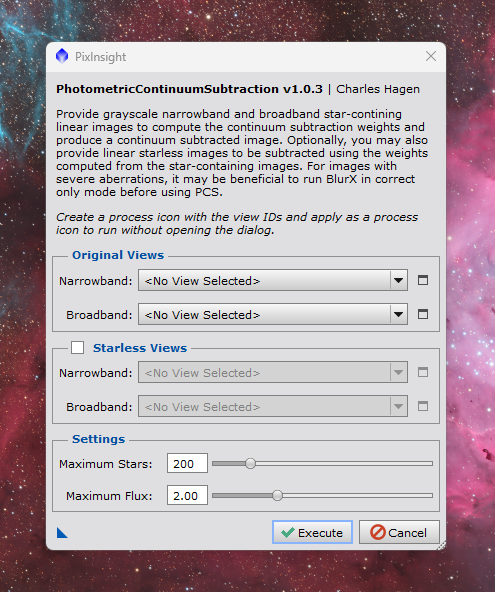

Description:
I have just released a new Pixinsight script, PhotometricContinuumSubtraction or 'PCS'. This script takes your registered narrowband and broadband integrations and using a photometric routine automatically calculates the ideal continuum subtraction weights and performs the subtraction, resulting in very speedy, perfectly subtracted images with no trial and error or manual adjustments. Additionally, you can feed it your linear starless masters and it will perform the appropriate subtraction using the photometrically calculated values. This supersedes my previous color calibration routine for continuum subtraction as it is both faster and more performant, especially in the edge cases with very bright targets or targets with a lot of continuum leakage.
You can also save out instances of the script with your nominal image identifiers pre-loaded. This allows you to apply the script without opening the script dialog. For instance, I always name my H-alpha and Red channels "Ha" and "Red" respectively. I can save off an instance icon and apply it to any image and it will automatically preform the continuum subtraction on images with matching identifiers.
The Pixinsight repository (available below) includes this script as well as one other currently (ApplySTF - I will be making another post shortly). I plan on making more tools in the future. You can find them under Scripts > NightPhotons > [ ]. I hope you all find this useful. Please let me know if you have any thoughts, questions or requests!
Thanks and clear skies,
Charlie

Graphical Interface

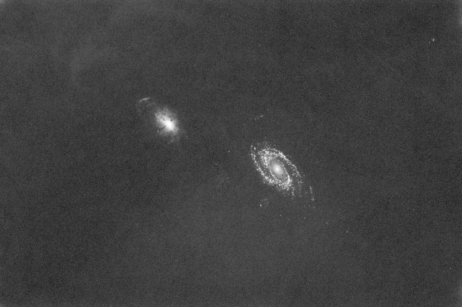

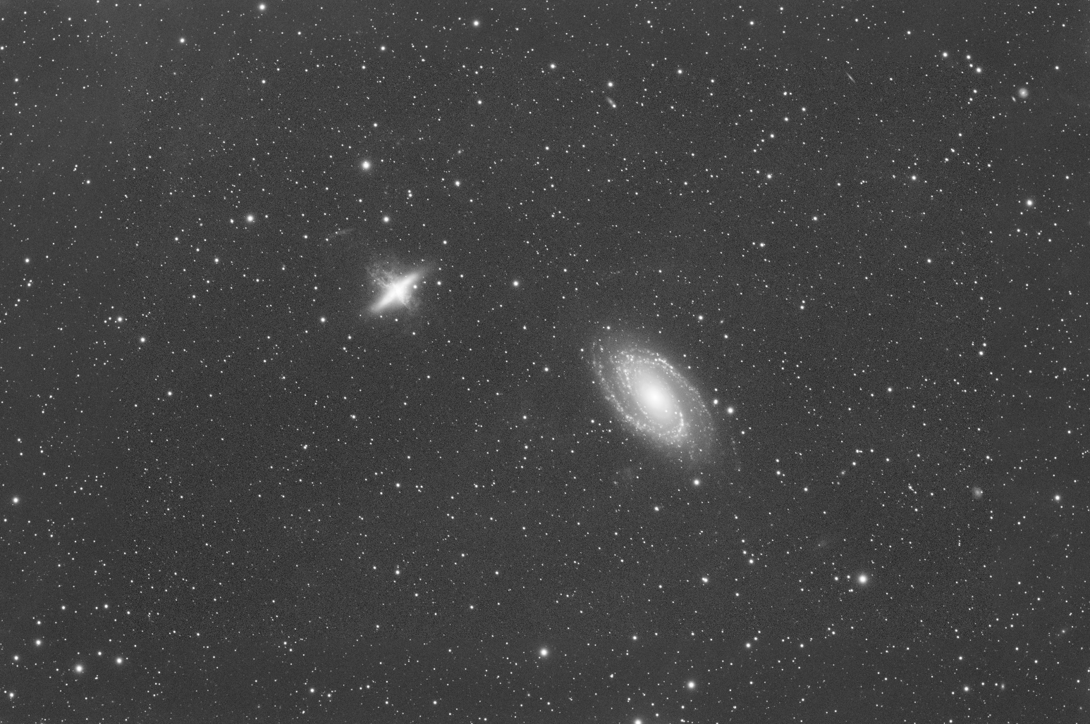

M81 & M82 Example [Before and After]

Would like to try it and PI "View installed updates" shows it as installed but there is no entry for Nightphotons under scripts and nothing under all scripts. Latest Windows PI version fully updated PI shows no updates available and restart does not fix it.
jimmythechicken 19.44
Bill McLaughlin:
Go to Scripts > Feature Scripts > Add , Then select the folder C:\Program Files\PixInsight\src\scripts (or wherever your pixinsight is installed). Press "Select Folder" and it should populate your scripts. Let me know if that works for ya!
-Charlie
CCDnOES 8.34
OK Thanks that got it. I guess I had forgotten that step in installing scripts.
