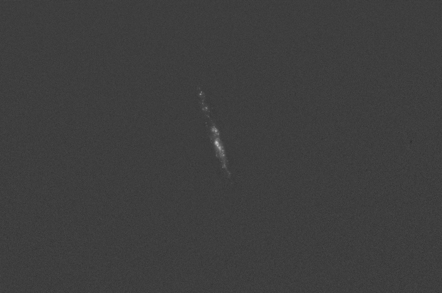

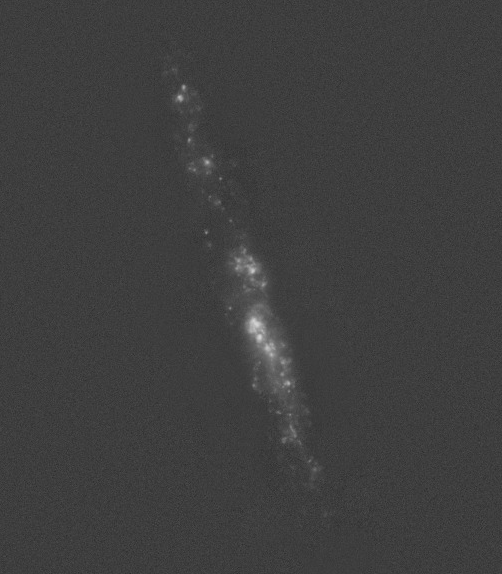

Alexandre_Fagundes 0.00
I just used this tool and found it amazing, and it's faster than the traditional method! Thanks, @Charles Hagen !
Nice results:
