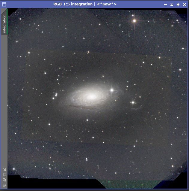

I wonder how to get the background lightness and color to match though, with different data
I tried getting some free data stacks from different people (including myself), of M63, to make a very long integration image, and after registering, easily saw the borders between the frames in the stacked image; it was so noticeable and I could do nothing about it; I redid my steps, this time tried LinearFit on all of the data stacks, stacked them, was no good; went back again, tried BGN, and Gradient Correction, and Automatic BG extractor, still didn't help; so I gave up and forgot about it.
Tried different settings in ImageIntegration too; like using LinearFit rejection vs no rejection vs Percentile, Median vs Average stacking, nothing helped as much as I'd like.
So I'll be listening to this thread.
This is what it looks like; not very appetizing:
(Median stacked, Percentile clipping; autostretched)

Unless someone else tells you a method that works in the software you already use, you can always try Astro Pixel Processor (it has a one month free trial) to do this. The Local Normalization process tends to blend these things when combining different stacks. You just add all the images (the minimum is 2 images) and integrate choosing Local Normalization. Start with 2nd degree, 4 iterations which usually works and go up from there if needed. Sometimes I’ve needed to use 4th degree but it usually works great with the 2nd. It matches the background intensities and blends the seams. The option “multi-band blending” supposedly helps with these but I havent had any good results with it although you might play with it too.

I think you said you acquired these from different public stacks...
Looking at the result here, I would first question if each of these stacks were properly flat calibrated? The fields do not appear to be flat or uniform, and edge artifacts don't appear to have been cropped out of several of these either.
If the goal is to create the largest field possible from integrations from disparate sources, I would say that flat calibration and really calibration in general, would become critical. Even with good calibration, due to dithering, there is often going to be border/edge artifacts, and I would think you would want to crop those out first, before trying to combine all the individual registered integrations into a single integration. Flat calibration in particular, would need to be very meticulously don to ensure that the field was as clean and flat as possible.
As for blending across the borders...there is bound to be some degree of difference between the individual integrations. You could give LocalNormalization a try and see if it is able to neutralize the differences between the backgrounds and eliminate (or at least minimize) the borders.
It's a good thing PI has Local Normalization too! Will try PI first.

Nope, no flat calibration; none were provided.
Yep, LocalNormalization is my new tactic, and I'll crop out the edges of each stack like you say. Thx.

alot of camera rotation within one of the data sets. Could be why PI WPPP is having difficulty.  I have used WBPP to combine various datasets without any difficulty. But each dataset was more "camera angle" stable...
I would follow the advice of others in this instance. Register each data set separately then Register(star-align) the two results.

thanks a lot for trying to help!
but I didn't use WBPP, and each dataset was already individually stacked by their owners.
and it's more than just 2 individual stacks; it's 8.
I'm gonna play around with LocalNormalization and see what that does.
