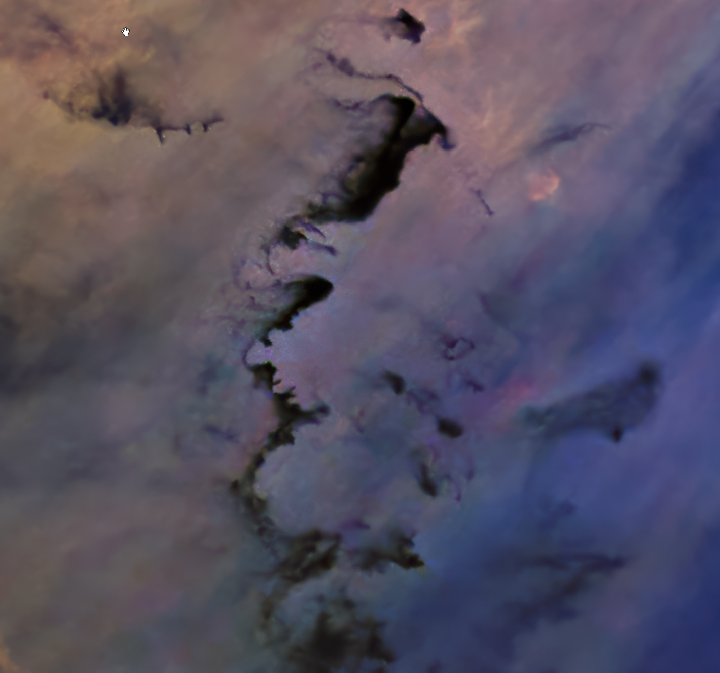

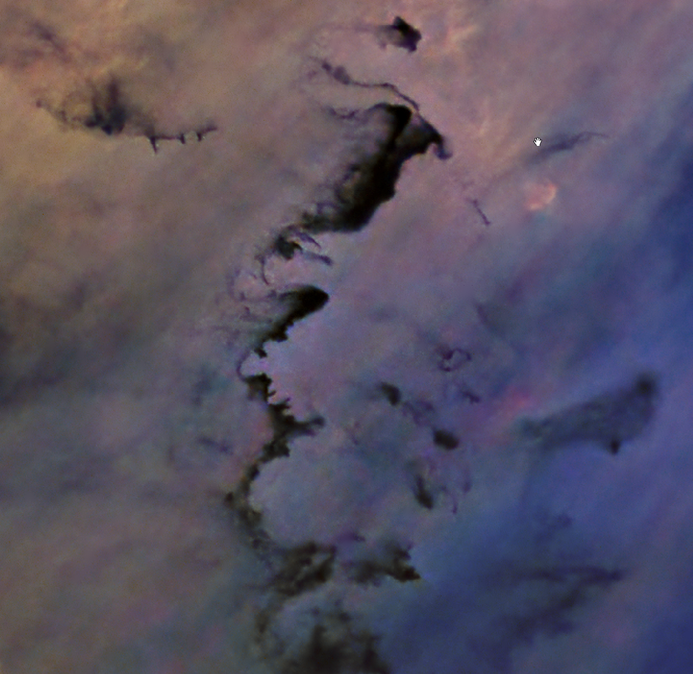

Just quick and dirty first test  but here is a  comparison of an original final starless image (top) and gigapixel processed original starless (bottom). Screen captures of a very zoomed in and very small part of a Clamshell Nebula image.  It is a bit sharper and cleaner but does not seem to have created any significant artifacts, at least on these settings.

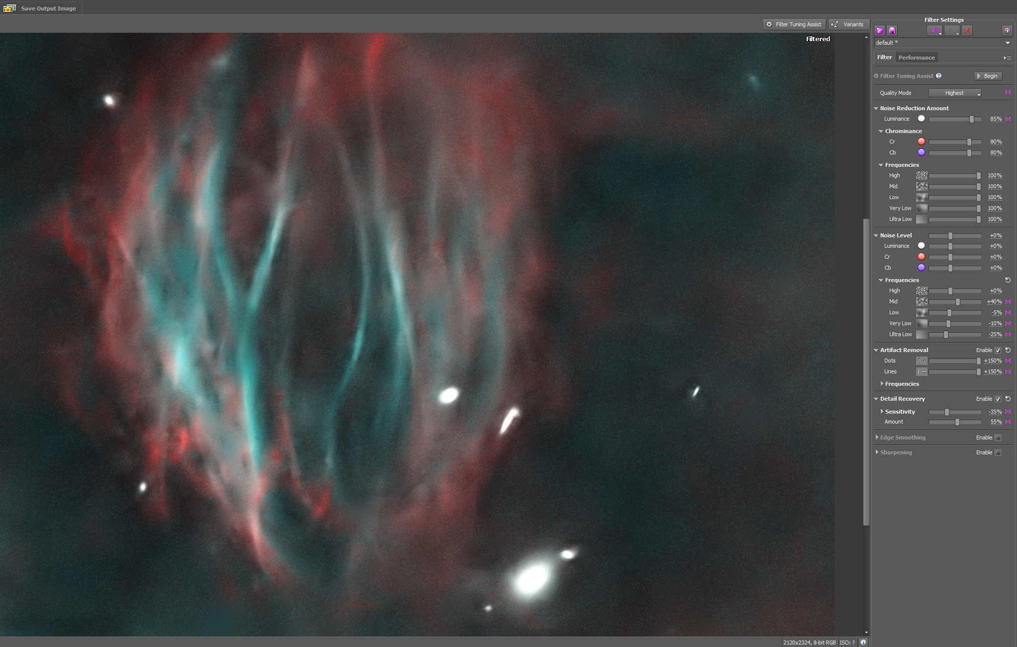

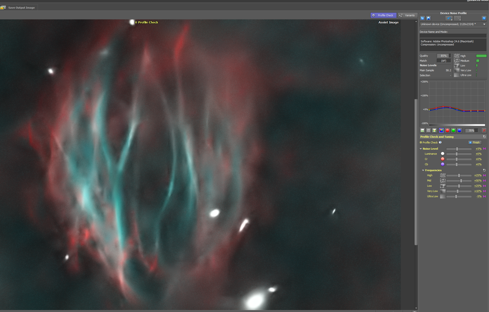

I had a go at the jpeg of StDr56 that Bray pasted here before the topic got ugly and I'm publishing the result here, with his permission. I'll describe the denoising in detail.
Most of the heavy lifting was done in Neat Image, with the following settings:
1. Noise profile creation and tuning
2. Final noise profile settings

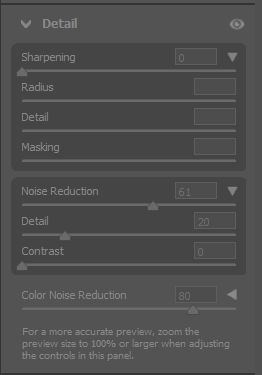

3. Camera Raw denoise pass.

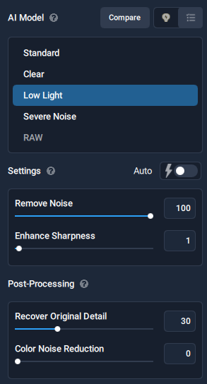

4. Topaz Denoise AI v. 3.4.2, after some artifact correction and cosmetics in PS. There was no need to mask anything this time. Topaz does tend to hallucinate in areas of small, sharp details with high contrast and there are none here. Sharpening at 1 simply makes it not blur the background completely.
I also did Highpass filter on two different scales, shifted the colors a bit, did some sharpening with PS Smart Sharpen, slightly darkened the background and got this. It's not pretty :-)
I hope you'll find it useful.

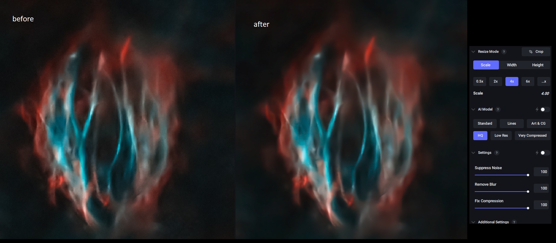

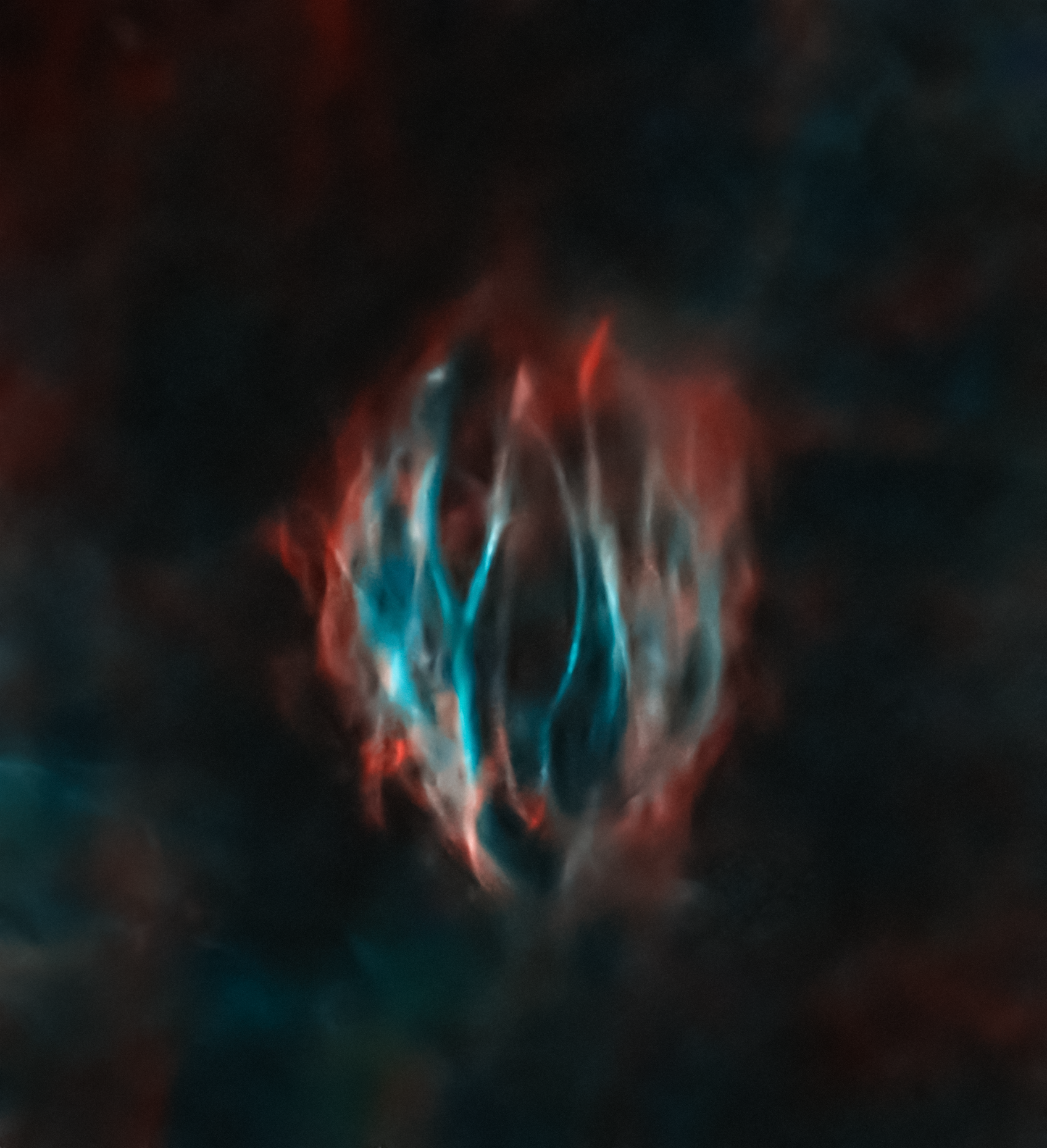

I downloaded your edit, and ran Gigapixel on it with the HQ mode
hopefully you can see, it's prettier
just a screenshot, I haven't bought Gigapixel yet, but I sure will buy it soon
I know it's upscaled by 4x, but I think the method is to upscale with Gigapixel, then downscale (like, with PI) back to original resolution

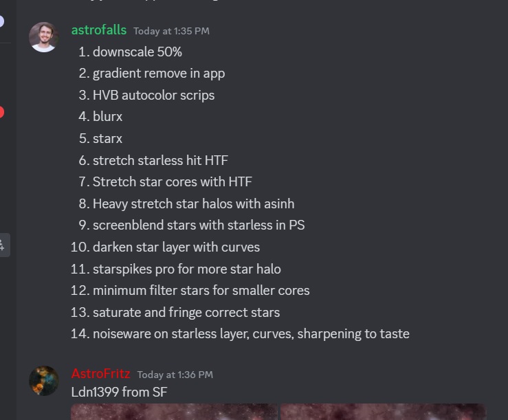

Here's a surprise; Bray's Starfront discord right now, in the astroimages section, shows this, his processing workflow he used on a Starfront user's dataset
It's interesting to see how heavily the stars are manipulated.
