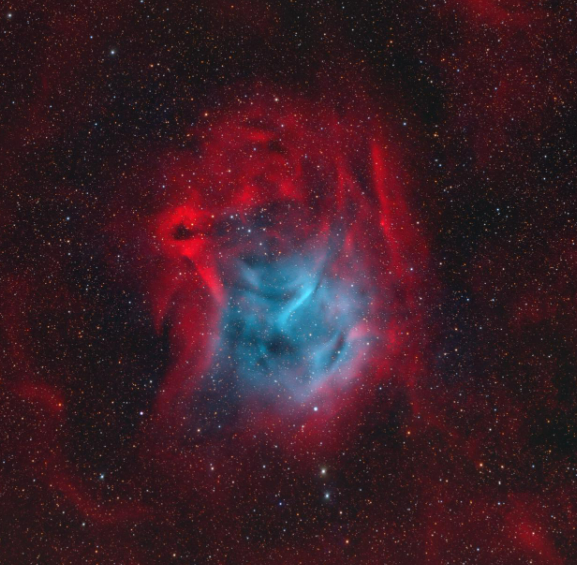

I'm really new to astrophotography. I had no idea structures changed or disappeared with longer integrations. @Oscar (messierman3000) I've had really good luck with the original Topaz denoise on my images but it should only be used on starless images. I'll run NXT at .4-.6 with the detail slider at .15 in a linear state after I've run MMT to target chromenance noise (NXT seems to have an easier time with salt and pepper noise). Then stretch however you like. For topaz, I recommend leaving the "recover original detail" slider maxed and the sharpen setting at 0. Typically, I'll use the severe noise setting and set the noise reduction to 1 (regardless of whether or not the noise is actually "severe") this seems to have little to no impact on structure and targets only BG noise. The other presets like standard and low light seem to modify/enhance/add structure. Then I'll continue my process in PI... stretch a little further/do color work and determine whether or not another pass of NXT is necessary or not. Hope this helps!

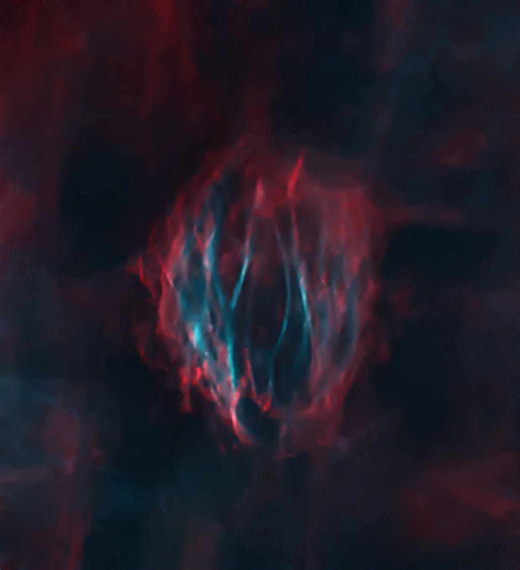

Rather than continue beating a dead horse, I decided to take a different approach to see whether I could take the noisy image that Bray posted and replicate a result that resembled what he accomplished. The original post was centered on how the noise reduction was accomplished so my intent was to see if I could figure out how to tame the extreme noise in that specific image. The low resolution image of the noisy version wasn't much to work with and I literally only invested 20 minutes into my non-scientific experiment. My workflow was as follows: 1) Did a channel extraction in Pixinsight to separate the image into separate RGB channels 2) Applied NoiseXterminator to the 3 seperate RGB channels using the default settings 3) Saved each of the 3 channels as a 16 bit Tiff 4) Opened the 3 channels in Photoshop and applied a very heavy application of Photoshops noise reduction within the camera raw filter 5) Combined the RGB channels in Pixinsight 6) Used a Range mask to isolate the brightest features within the goblet so that curves adjustment could be used to dial down the blown out features 7) Did a quick Red and Cyan color mask to do some color tweaks using curves adjustment 8) Clone stamped out the bright blown out objects 9) Brought the finished image back into Photoshop for some final tweaks (contrast, levels. saturation) This is what I managed spending 20 minutes with an extremely low resolution version of the "noisy" version of the image. So in answer to the original post, it certainly seems plausible to replicate the noise reduction seen with the original data. As far as any debate as to whether this level of data manipulation is appropriate, I choose to abstain from that discussion. I was more curious as to how the noise reduction might be accomplished and I was surprised at how easy it was. I would love to have a chance to take a crack at the high resolution data set. My imaging skill set is pretty basic but it would be fun to see what I could do with quality data and investing the processing time worthy of a 200+ hour data set.  |

No idea what noise reduction methods you're thinking of but the ones I use don't make structures magically change shape, placement or texture... all by quite a significant amount, not just by a couple pixels like you suggest I have had DeepSNR create a sort of Dust Halo around NGC 3953 in my NIR data, which I can say is probably not there. Albeit, the data being NIR there is always that .0000000001% chance it is something unseen.  |
@AstroSidivis , thank you, it does help ------------ Mathew Ludgate, a collaborator of one of Bray's projects has responded to me he told me his own NR method, the one he used for this:  (credit: Mathew Ludgate, PN Candidate Lu4) I asked him if he could come here and write and what he told me, plus any thoughts he may have about all of this IMO, it looks similar to Bray's nebulae in regards to NR, I mean it looks smooth, but not completely diffused like what would happen with just plain convolution I think Bray might be using a very similar NR workflow
@Bob RuckerI duplicated your image and inverted the duplicate, then added that as a mask onto the original, then added some convolution to the masked image, looks a little closer to Bray's edit but I think Mathew has the closest recipe to Bray NR workflow - I'm hoping he's willing to talk here
Arun H: Perhaps a lot of the friction comes from those of us with scientific backgrounds versus those with artistic ones. Maybe, as especially as some of us push the bounds of what is possible, we just need to make it explicit and accepted that many of the details are up to interpretation. Agreed! That discussion is as old as astroimaging and I can recall similar discussions way back in the 1990's at several imaging conferences. In those days some of the "science purists" were even more aggressively "pure" than these days.  They even objected to some of the then new forms of stretching!
everyone here is allowed to not fully disclose their processes LOL, sometimes by the time I finish processing an image I cannot even remember all the steps myself much less tell someone else what they were!  |
Oscar: @Bob Rucker
I duplicated the image and inverted the duplicate, then added that as a mask onto the original, then added some convolution, looks a little closer to Bray's edit
but I think Mathew has the closest recipe to Bray NR workflow - I'm hoping he's willing to talk here It's a given that Matthew has a lot more expertise than me so any processes he might share will be far superior to anything I did. I think that my simple experiment shows that it's possible to achieve a result similar to Bray even using basic NR tools. I suspect that the results of my experiment would have been much better using the original fits rather than the 365 kb JPG image posted with Bray's image. That highly compressed low resolution image really did not give me much to work with.
Oscar: @AstroSidivis , thank you, it does help
I think Bray might be using a very similar NR workflow Well, if he decides to open up about his workflow, you and whoever is interested on this, including me, will have the answers we are so much looking for. This image is very very close to what Bray and a few others do. Excited to have his word!

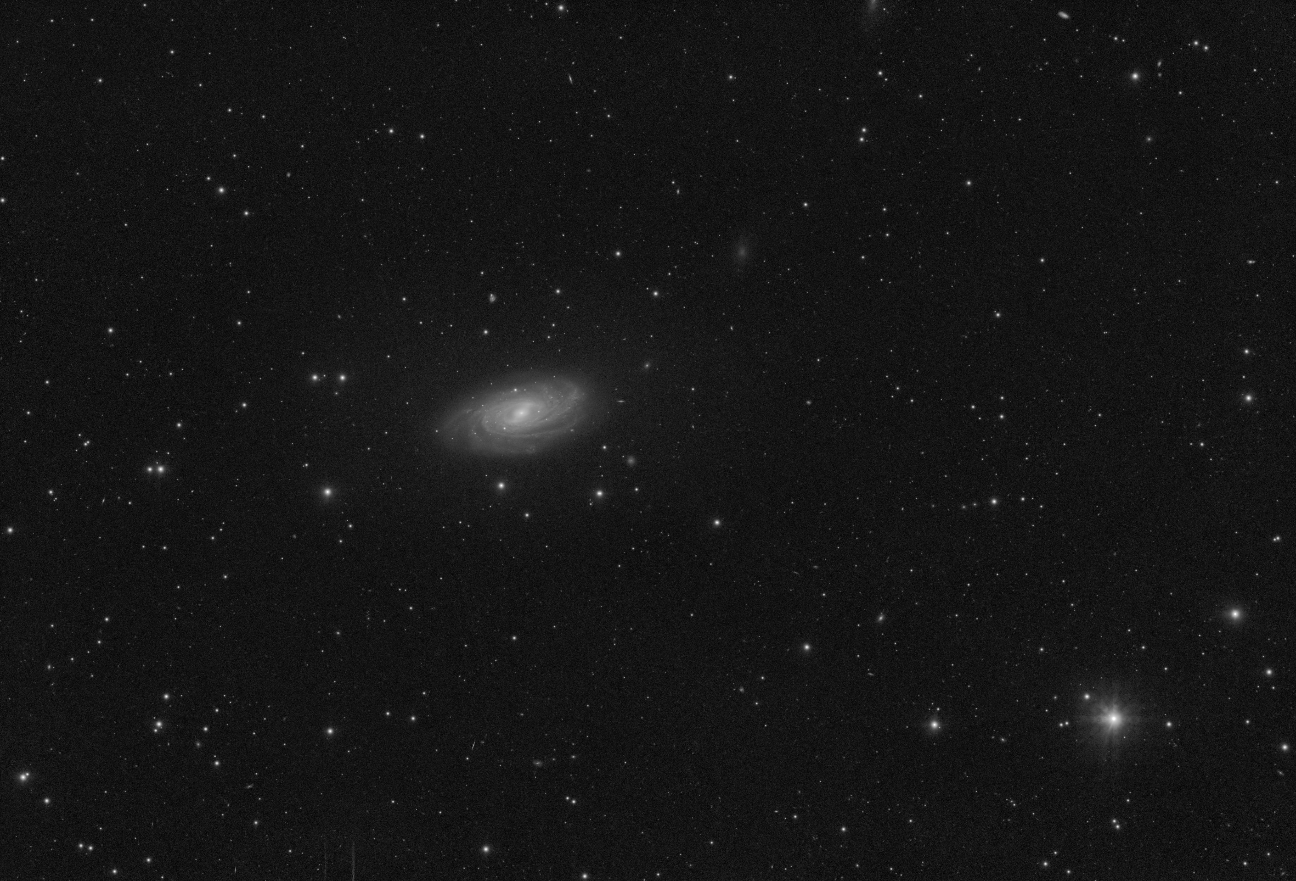

I'm just too excited, I lost patience with Mathew (sorry Mathew) and am going to tell you what he told me, but I also just found out something, no one told me about this, Mathew didn't talk about this, I found out accidentally
just try it on an image:
Gigapixel AI, AI model: HQ - I suggest experimenting with the slider values, but I put all 3 at 100% for the Jpeg Goblet of Fire that that last guy denoised with NXT - Gigapixel gave the nebula the "Bray look"
Mathew's NR is nothing too special or too specific anyway, I don't think Mathew will mind at all
for NR, Mathew uses "NXT, dust and scratches, sometimes a little gaussian blur, neat image and an old version of topaz. Topaz is usually the final NR step with the sharpening dialed down and careful checking to ensure no new structures are added"
those are his own words
by Topaz I assume he means Topaz Denoise, because he talks about an "old version"
what I can conclude is, the general workflow to get those Bray-quality images is NR first, like Topaz Denoise with NO sharpening, (NXT or DeepSNR, or just any other NR software could work also), then use Gigapixel afterwards
the Gigapixel test was done with a color Jpeg image, it might or might not work better with grayscale - I haven't tried that yet
