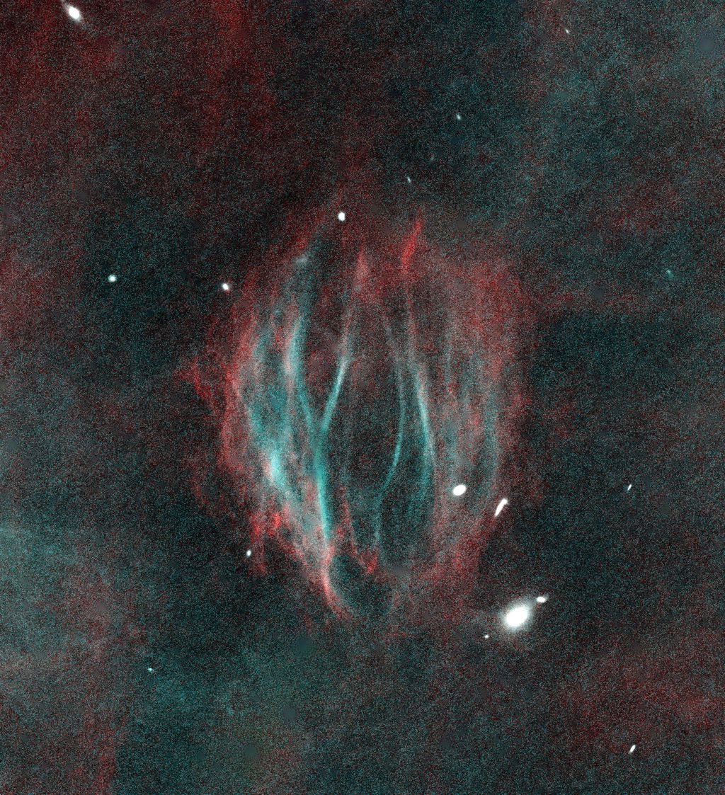

into this. like, WTH? how is this possible?:
also, doesn't it seem like the background OIII was turned into IFN? or maybe his example (above) was just of HOO, idk.

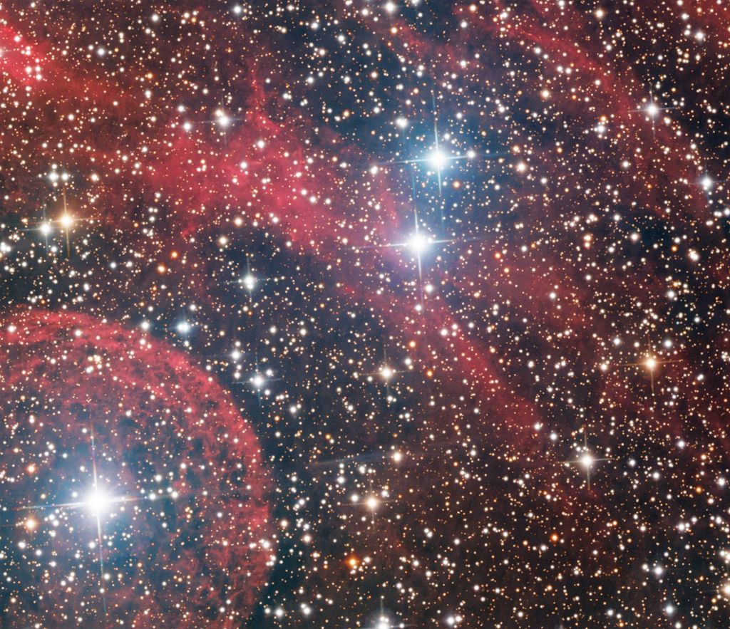

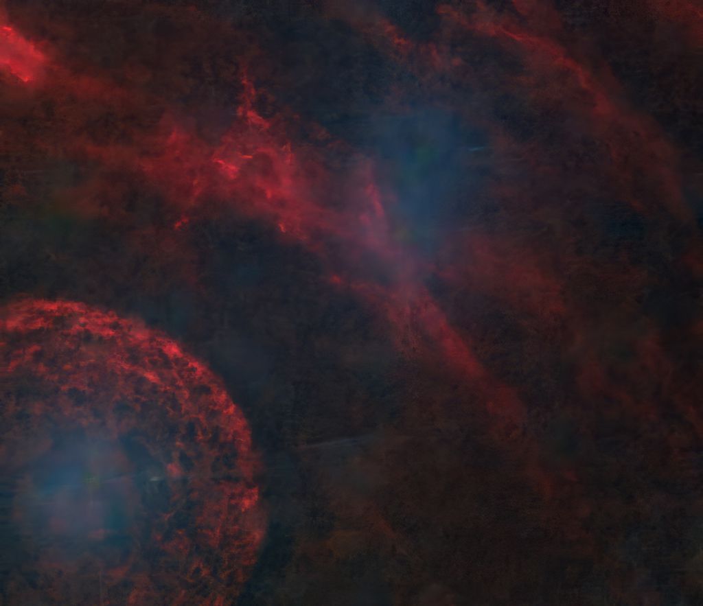

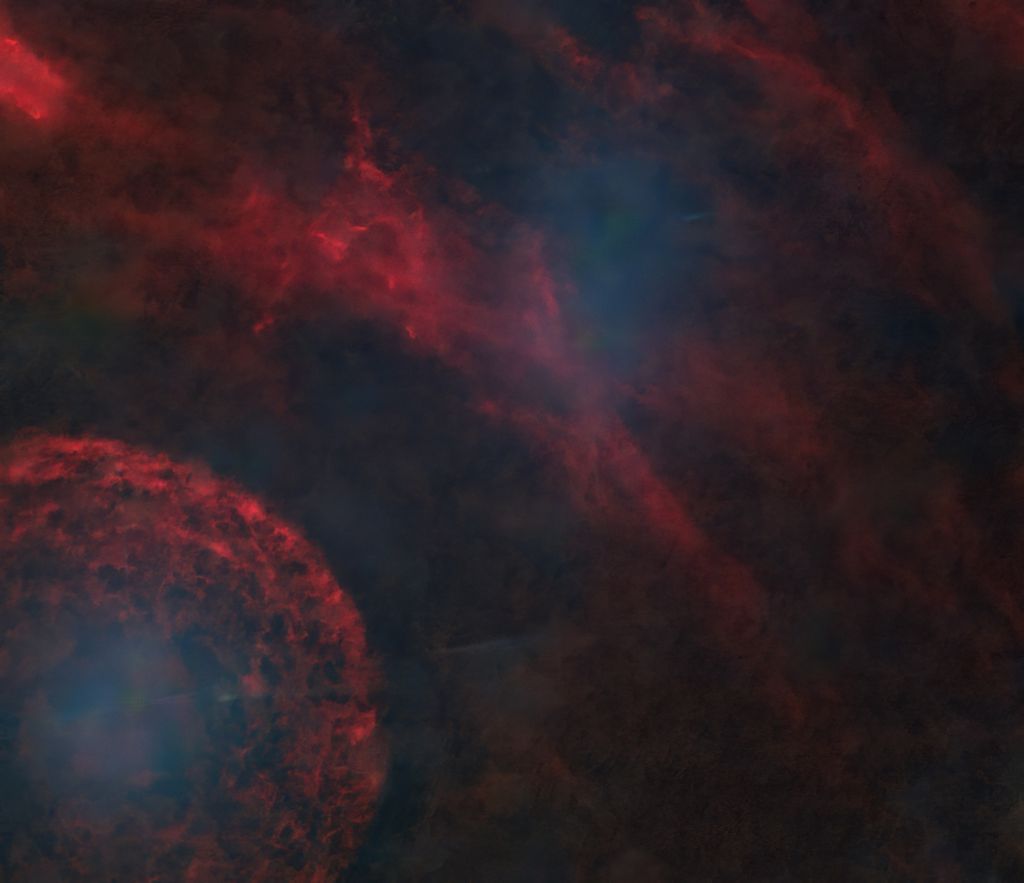

I did get the free trial of Denoise AI (the old standalone version), and did experiment with it with Bray's raw starless Jpeg data (top image), to try to replicate his final result, although Topaz did a very good job removing noise, I could never get the amount of detail and smoothness shown in his final image.
I tried my best to express my thoughts
I would appreciate any advice, guides, or anything at all; what do you do for denoising faint objects, once you've already gotten a lot of integration and can't add more? NXT wouldn't handle the type of noisy data shown at the top, that's for sure; it's gonna be all mottled up.

What you're missing here about the IFN is the continuum leakage in narrowband filters.
I assume that the raw HOO Bray posted is before continuum subtraction, so what you're seeing is not all OIII, but also dust that is visible in the OIII band.
After continuum subtraction there'll be no dust in the OIII and the dust will be enhanced separately with RGB/LRGB processing (hence the brown color).

The point of this thread isn't necessarily the O3 to IFN, which when viewing the data, looks like a creative choice to refuse to highlight the O3 emission surrounding the main PN. That is just an example of interesting processing decisions that would be nice to hear about from bray. The point of the thread is the Noise Reduction. That is what OP is interested in.

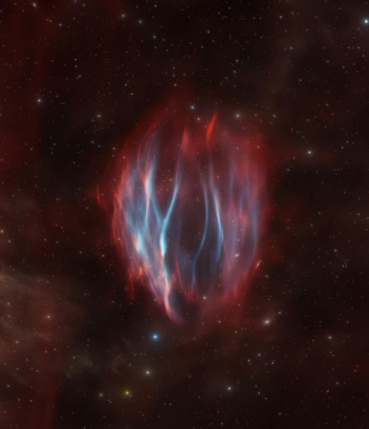

I agree, Honestly when comparing the data with Marcels data, there are some discrepancies. I am just assuming that with the amount of Noise Reduction that needed to be done affected the data. But that is just a guess.
Here is a aligned comparison:
Bray_Marcel_Gobletcomparison.mp4

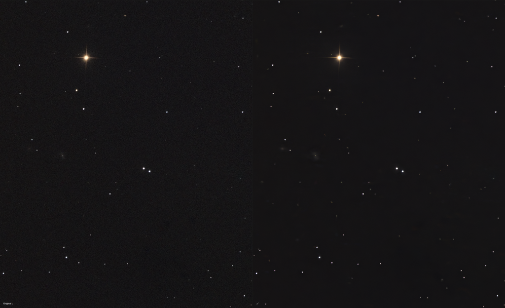

Unedited, for reference:
On the "Normal" denoise preset:
On "Strong" (which is what their algorithmically determined recommendation was):
And "Extreme":
I pulled up some other examples that I'll post in a sec.
ThisIsntRealWakeUp 8.35

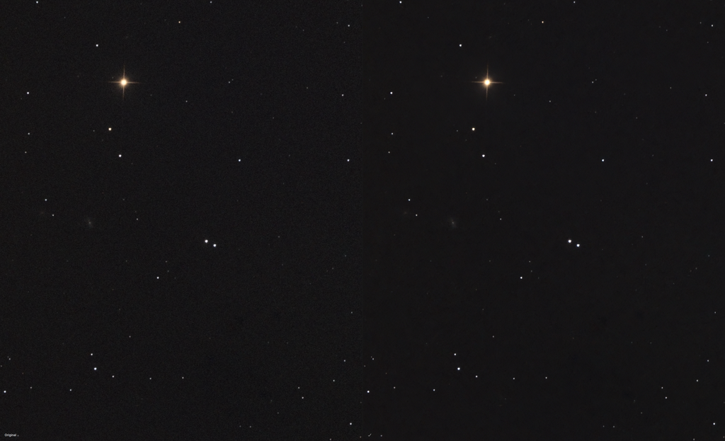

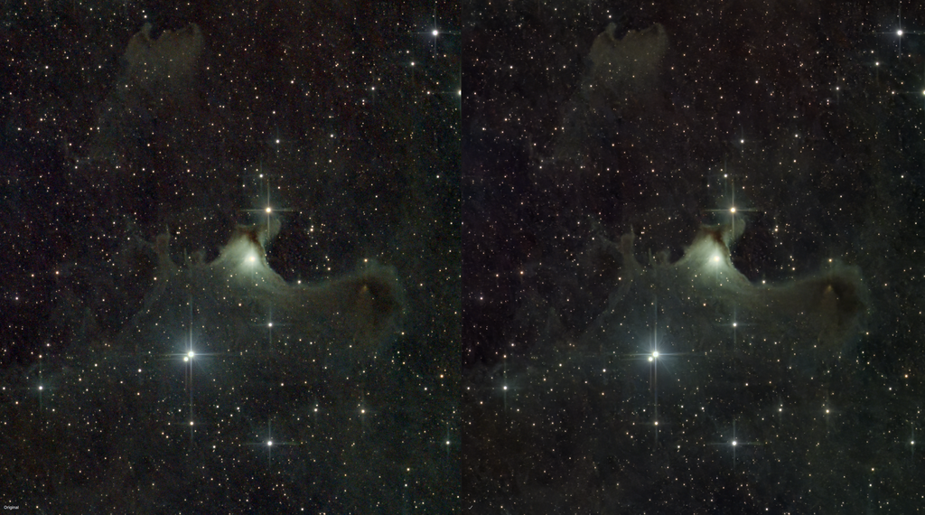

Here's some more examples of Topaz at work. Left half of the image is the original image. Right half is denoised. This is the low, strong, and extreme preset, respectively. These images are zoomed 1:1.
In all three examples it does a pretty poor job of maintaining star shape. And the second example particularly shows some weird artifacts around the galaxy in the middle-left.
And this is my friend's image ran through Topaz on its recommended settings. Again left is original, right is denoised, both are 1:1:
Overall I think Topaz does a bad job with large-scale noise, often misinterpreting it as texture that isn't really there. It also struggles a lot with preserving star profile.
