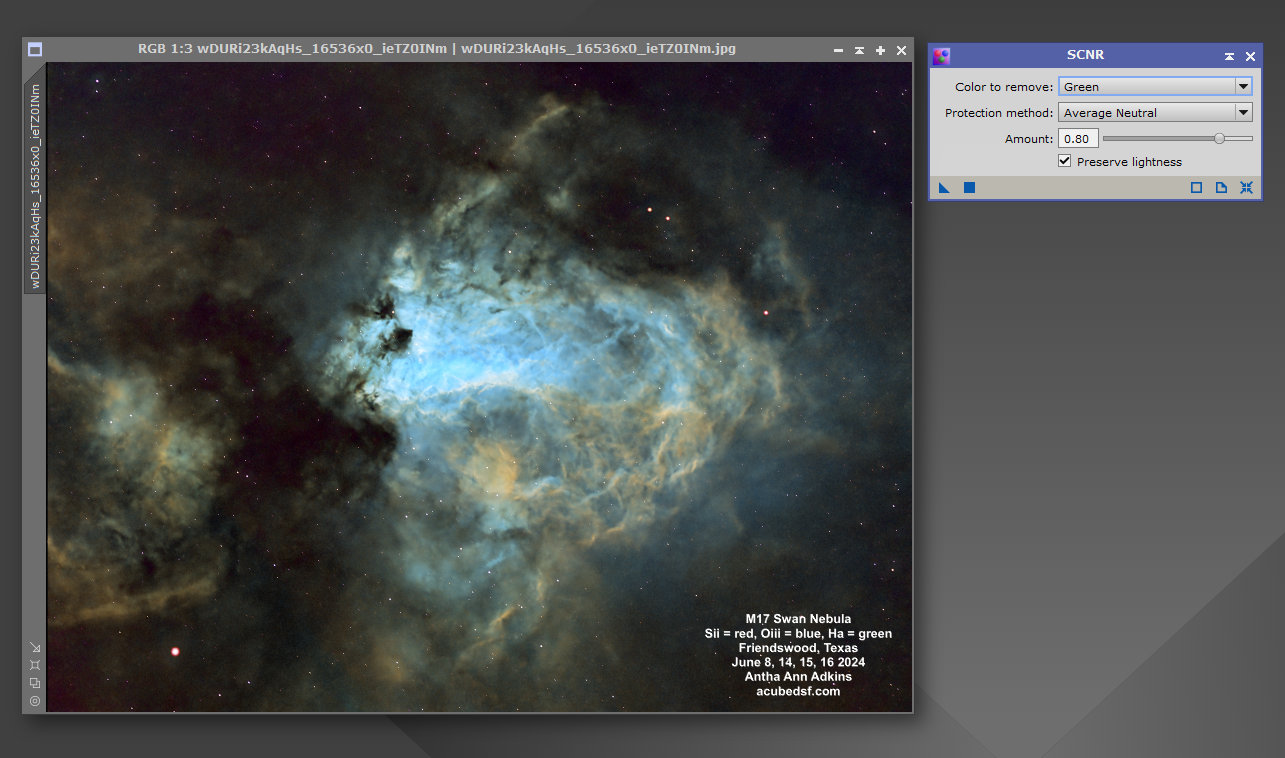

Hi all,
I'm working on learning narrowband processing.
My process:
- BXT/NXT on each of H, O, S
- NBColourMapper
     - Colors mapped to 0, 120, 240 with saturation = 1 (this may have been going overboard!) and adjusting the histogram to align each channel
- StarXterminator to separate nebula and stars
- STF/HT on stars
- STF/HT, HDRMT, and Curves on nebula
- PixelMath to recombine
I've tried GHS on this one but just couldn't seem to get it to look as good as STF did in auto.  This is my first time to play with HDRMT.
I'm happy for any advice for making this better.
Thanks,
Antha
iosifbodnariu 0.90
Hi.
With SCNR you can play with Green, and can remove some amount Green excess.
DavesView 2.39
Watch Sarah Mathews (SarahMaths) on youtube, SHO processing video and try her method for stretching the individual channels manually. https://www.youtube.com/watch?v=PfdOJZzyLEs&list=WL&index=2 Then switch over to PaulyMann Astro youtube video for Foraxx processing.  https://www.youtube.com/watch?v=cl3_r3bL8Ys&t=6s
Just a suggestion. You can incorporate the parts you need into your workflow... or not.
You state on your image page the following: "This is a narrow band color mapped image where H-alpha is mapped to green, Oiii is mapped to blue, and Sii is mapped to red.  I used STF/HT and HDRMT and curves to process the nebula in PixInsight."
If I'm not mistaken, Ha goes to red, Oiii goes to green and Sii goes to blue. If I'm incorrect, see disclaimer.  Also, if I'm wrong on that, someone straighten me out, please.
Disclaimer: This advice comes from a noob. I'm working on learning mono processing also.

acubedsf 0.00
DavesView:
Exactly the kind of pointer I was looking for, thank you!
acubedsf 0.00
Iosif Bodnariu:
Thanks for the hint!  So a general question ... since the Hubble palette assigns Ha to green, and there's a LOT of Ha, why are so many of the Hubble palette images I see not predominantly green?  Why is the green considered "excess"?
AstroDan500 7.19
Antha Adkins:
A good question and I don't know the answer except the the predominant of Ha and green is just visually not appealing.
I like to leave a slight amount but most people get rid of it. I think the edit by Iosef is more appealing than yours.
I also think you could experiment  with tools like localhistagramequalization with masks and HDRmultiscale to bring our more detail in the nebula.

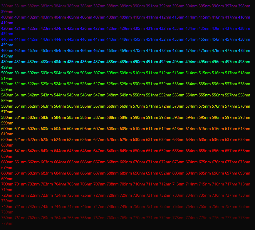

DavesView 2.39
Dan Kearl:
DavesView:
For typical SHO combination, Sii is red, HA is green and Oiii is blue. The OP used the normal narrowband combination.  The other typical use is HOO combination  which is HA to red, Oiii to green and blue.
Thanks for clearing that up for me. Although, this chart muddies it up again. If 656 nm is Ha, how can Ha be green?
From Wiki: "Hydrogen-alpha, typically shortened to H-alpha or , is a deep-red visible spectral line of the hydrogen atom with a wavelength of 656.28 nm in air and 656.46 nm in vacuum."
acubedsf 0.00
Dan Kearl:
Antha Adkins:
Thanks for the tips!  Exactly the feedback I was looking for.  I have another version using the Canada France Hawaii Telescope palette, now posted, and I think I like that palette better.  Thoughts?

acubedsf 0.00
DavesView:
That's a really neat chart!  The answer is this is false color mapping with the purpose of having more contrast in the final image.  I'm using the NBColourMapper script, which is really cool and allows you to map any filter to any color and allows you to see the result and tweak it before saving.  So H-alpha is red in reality, but can be mapped to another color to generate contrast.  If you look, H-alpha and Sii are very close on the spectrum, so there's not much distinction between them without false color mapping.

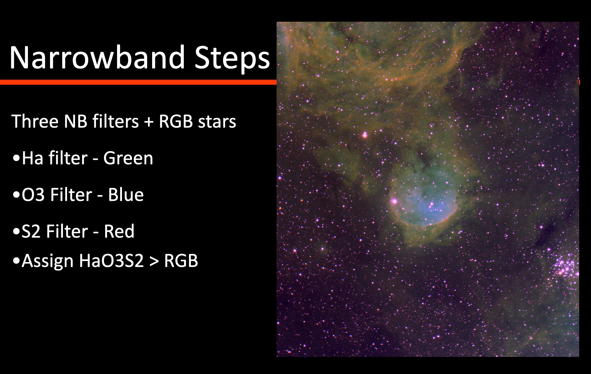

Andys_Astropix 14.17

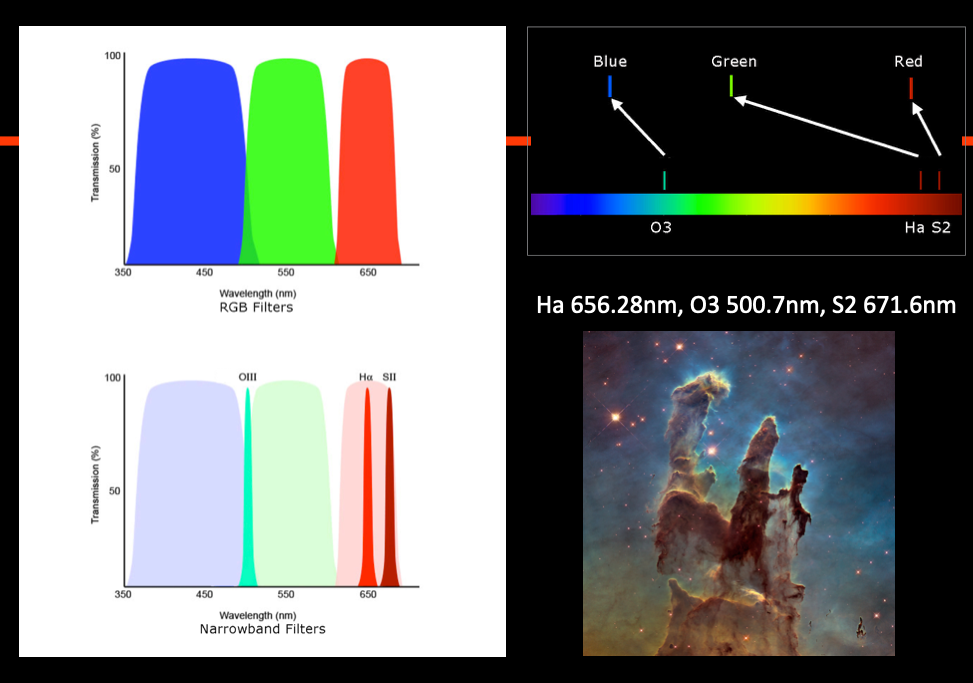

Narrowband colour mapping is highly subjective.
The Hubble team assigns these colours to easily (visually) determine the composition of the gases in the nebula. Otherwise, it would appear teal, red, and ultra-red, and it would be much harder to discern the difference between the Ha and S2 components.
This is a typical result when three filters are assigned these colours. It varies with the Ha component of different nebulae.

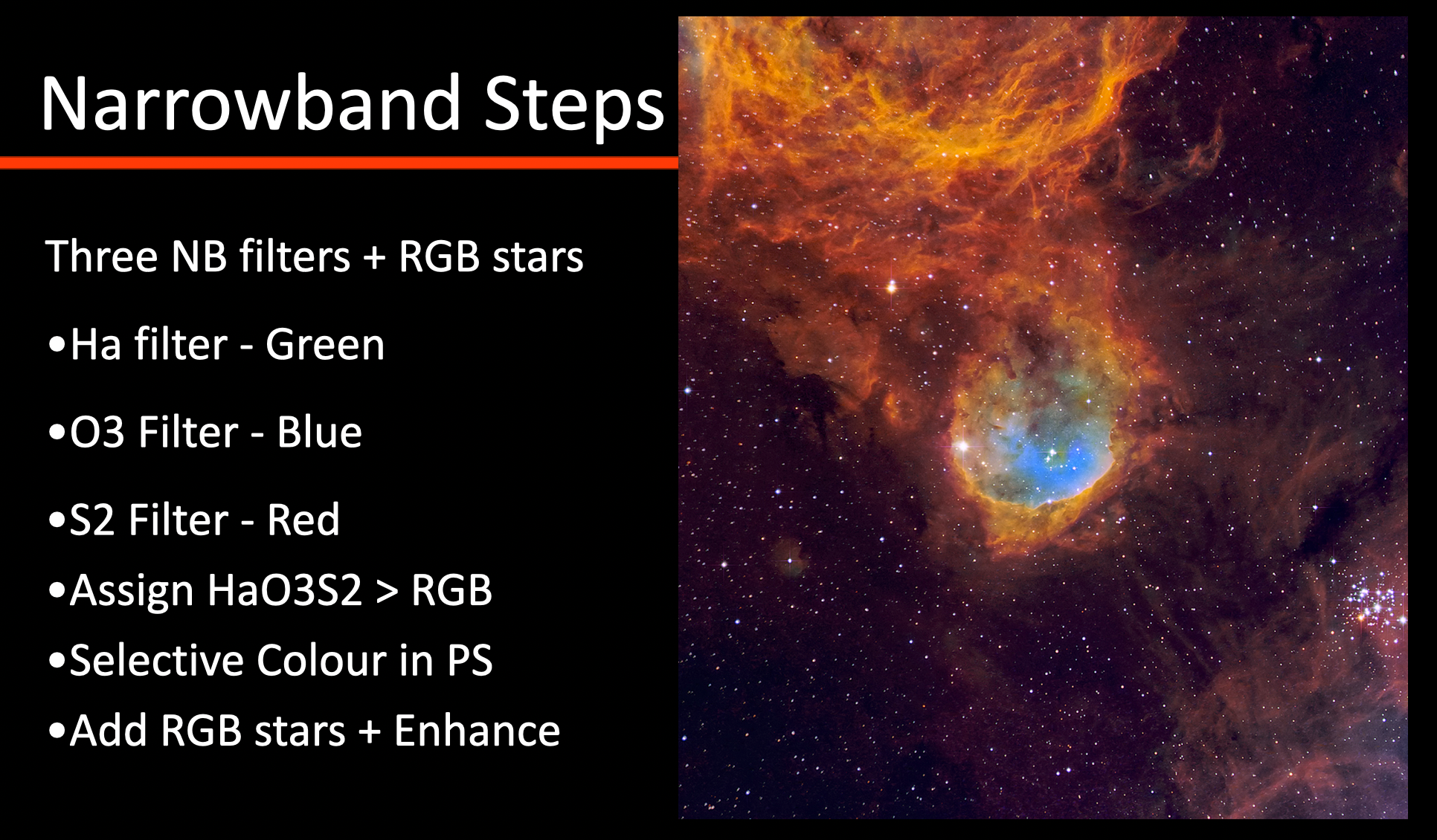

Most people would agree though, that for a pleasing visual aesthetic, 'blue & green should never be seen without a colour in-between', so typically the green is replaced with warmer tones, and pink stars have no business appearing anywhere except Disneyland!
I did this one in photoshop using selective colour. Here is a tutorial that may help. http://bf-astro.com/hubbleP.htm
