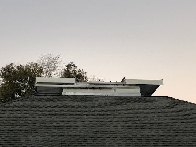

I have built an observatory on the roof of my garage and it works great.  Not exactly what you are asking, a deck on the roof, but this is an option that I think would work better.

Hi Bruce,
I like that idea! My garage roof is lower than the main house, so the latter would block some of my view, but I will investigate, nonetheless.  Thanks for the idea.
umasscrew39 13.55
Hi Lee- my garage roof is slightly lower than the rest of my roof but that should not be a big issue.  If you have any further questions, just shoot me a private message and I would be glad to help as best I can.
Best of luck,
Bruce
