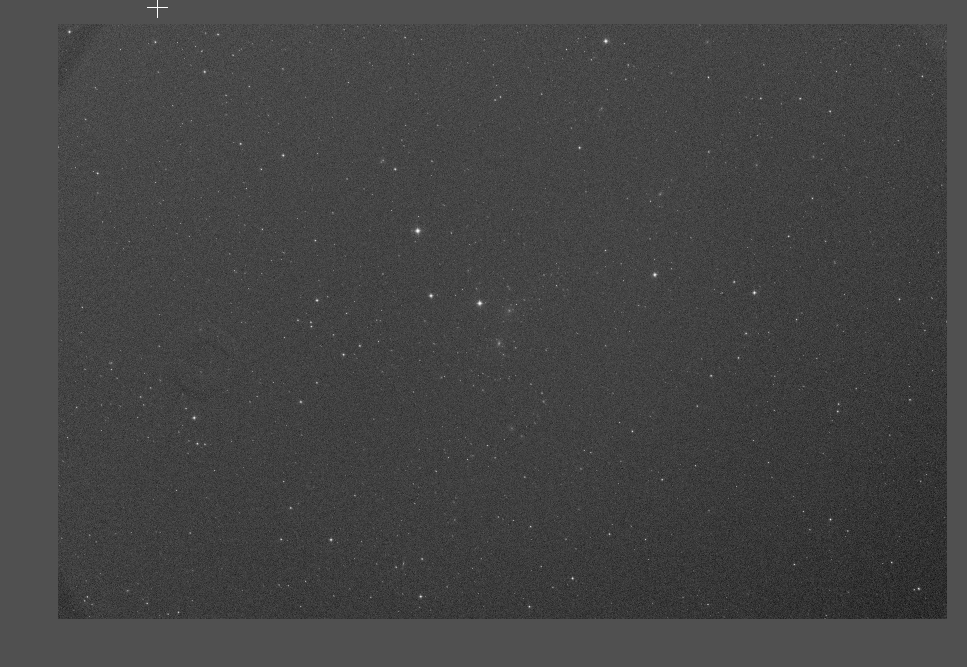

I moved from a Risingcam 571c with a 2" filter in a drawer to a 571m with 36mm unmounted filters on the 130D. My LRGB calibrated files are tending to look like this:  I'm not sure if it's explicitly a filter vignetting issue or a focus shifting between lights and flats issue but it would probably be avoided with either a camera with less focal flange distance or larger filters.
 I'm not sure if it's explicitly a filter vignetting issue or a focus shifting between lights and flats issue but it would probably be avoided with either a camera with less focal flange distance or larger filters. I would think flats would correct that. The vignetting doesn’t look bad at all in either case.
This is in fact a calibrated image - there's no clear hard vignetting in the uncalibrated file but there's clearly some sort of filter related calibration problem.
I haven't nailed down the cause but I suspect either shorter backfocus camera or larger filters would mitigate the problem entirely.
Or maybe I'm barking up the wrong tree and there's a entirely unrelated cause.
Your calibration isn't working right. See that embossed donut? That's indicating your filter is not in the same position during flats as it was during lights. Make sure you're using uni-directional on the filter wheel. That will eliminate the problem  .
I have exactly the same setup and both RisingCam 571. I think something is going wrong on yours. The donut is just a dust that can be solve by flats. But the top angle tend to prove some misalignment in the optical train. It could be a bad secondary miror positionning.
That dust spot actually showed up *not* on the filters, I think it landed on the back of the CC. Not the issue.
I'm fairly certain it's just the filter wheel misbehaving - Johnny Bravo's suggestion to "force" unidirectional filter wheel movement may have fixed it.
