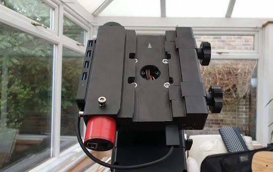

Also modded the mount head with a customised integrated guider.
30mm F4 with ASI174m mini - I get about 1 to 0.75 RMS on both axis

Nice setup! I especially like the modification of the mount's head smile Looking forward to seeing your pictures!

Nice setup! I especially like the modification of the mount's head Looking forward to seeing your pictures!
Frédéric
Merci,
It is possible now to purchase the mount with an i guider, but i wanted to save some money, so i put the lens of my old skywatcher 30mm finder into it and then added a mono guide camera from ASI, which is far more sensitive.
To get focus, i need to screw the lens in or out, but not so much of a issue as i have put a lock screw in place so it hardly needs adjusting​​​​​
​​​​​​i  am thinking of adding a barlow to improve my RMS on guiding.
