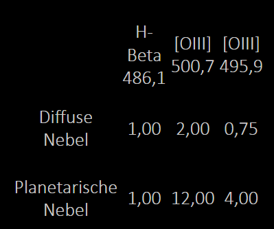

andrea tasselli: The question is why would you want to do that? There is no reason to remove the Hbeta signal embedded into the B channel, even if you could. With very rare exceptions (one being NGC434) the Hbeta is way weaker than OIII (usually an order of magnitude weaker) and hardly work the effort, never mind the pointlessness of the endeavour. For the question why you want to do that: Maybe because you want to show O(III) and not O(III) + Hb. For the second part: I would challenge the claim that Hb is always much weaker than O(III). For objects (or regions of a given object) where Ha is very strong and O(III) quite weak, I would be willing to bet that Hb can be ignored easily. I only have this source (german only, sorry) which deals with visual astronomy to support my claim: Nebelfilter visuell (svenwienstein.de) As a rule of thumb it provides these examples for intensity ratios:  So for planetary nebula you have a point while for diffuse nebula it's more like 1:3 with a significant dependency on a given object as they point out in their article. It would be interesting to learn about the APP magic for "extract Ha" and "extract Oiii". Clear skies Wolfgang
I only have this source (german only, sorry) which deals with visual astronomy to support my claim: Nebelfilter visuell (svenwienstein.de) As a rule of thumb it provides these examples for intensity ratios: It is a pointless endeavour and to what purpose? It is not like any of this is going to any scientific endeavour, is it? H-beta is important in PNs because gives a metric to estimate ionization temperatures but for emission nebulae I can't see a reason and in fact I can't remember ever having seen it mentioned in Simbad or similar databases. Besides, I explicitly said "with rare exceptions", so yes there are out there a number of them, but not many (and NGC1805 ain't one of them). I would challenge the notion you can estimate photometric quantities by visual means only and then in otherwise unknown manner and extent. I have a H-beta filter and I know for a fact that used to sit most uselessly except when I wanted to go for long integration in PNs. I've tried it before on a number of nebulae and making the usual exceptions the results are meagre.
