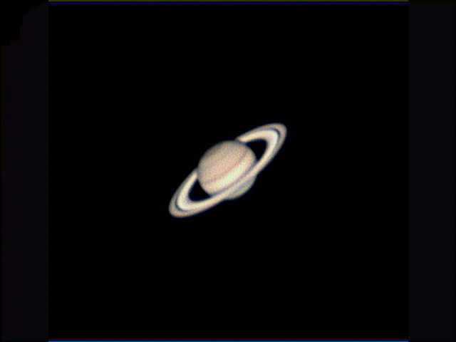

*Hello Andrea,  last night I tested without barlow and very good results with Saturn and Jupiter. One example here not fully optimized.
Thank you very much indeed.

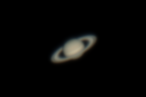

Dear all,
I did the collimation of my C11 and I have been trying to improve my images ( no barlow) and after several  weeks with my new zwo 462mc and different seeings,  I am afraid I am doing something wrong. Below you can see the results after astrostakkert ( Laplace 5, double stack reference, 55% of images, normalize stack 75, sharpened 25%, no RGB align, no close to edge, no multiscale ) from a video with these parameters:

These are the two images that astrostackkert gives as results:
#saturn 2_013826_Gain=291(off)_Exposure=10.0ms_Gamma=51_220821_lapl5_ap17 (2).png
#saturn 2_013826_Gain=291(off)_Exposure=10.0ms_Gamma=51_220821_lapl5_ap17_conv (2).png
Please, what am I doing wrong?
Thank you very much indeed in advance.
I suspect seeing is the issue there. And there is no way you can improve upon that. I suggest you take a short video of a bright star, in focus, to see what kind of seeing you have and maybe report back.
astropical
Hello jcac68,
The 462MC is a fine camera and your settings are looking good.
This the best result I can process with your AS!3 output (unsharpened) using Registax6 wavelets and Photoshop:
Thin clouds or haze in addition to poor seeing is the likely cause.
Large scopes do not only gather more light but also more turbulences.
When seeing is poor stacking 55% can be too much. I usually go for 10 to 20%.
Cheers,
Robert

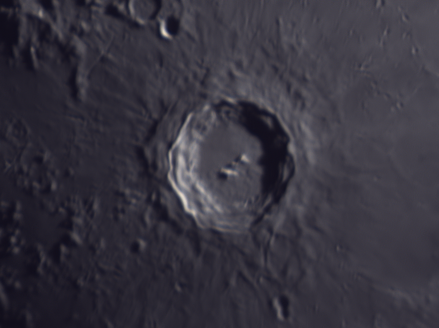

here another example of Copernicus after processing with astrostakkert and registax
Thank you very much. Cheers

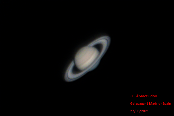

Dear all
Last night finally good seeing. Tried many different settings with Saturn , Zwo ADC and even Barlow x2.  As all of you said the issue was the seeing. Below two images processed wth astrostakkert and registax.

I tried also with a Televue Barlow x 2 but bad results , probably better seeing is needed. In conclusion as all of you told me , seeing is critical with this FL and settings depend on the seeing.
Thank you very much indeed and awaiting for better seeing and will try with these and also new settings.
