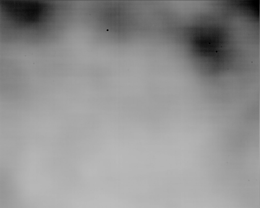

- - Steve Solon Steve, Sorry if I missed this, but did you mention what camera and filters Martha was using. A few months ago, one camera I tried briefly would not yield any usable flats in SII, and OIII and Ha had some strange sensor patterns. This was with my C925Edge and I had ghost imprints of my secondary mirror which could not be phased out, no matter how short the flats exposure. Regards, John

Just another interesting experiment for cold winter nights: Many of us have calibrated monitors and use a colorimeter like a Spyder to adjust it. These colorimeter can precisely measure the luminescence and color. Try that on your flat  I did that on some and immediately returned them to the vendor. It turned out that many of them had huge surface luminescence deviations. Some up to 15%. Additionally very often unevenly distributed, so it matters in which position you use it. One was even so bad, the gradient of the flat panel was worse than the vignetting of the scope. So asked them: How should I calibrate my images, if the calibration device itself has a 15% deviation over the area? They all accepted the returned devices without any discussion. My conclusion: The quality of the flat devices is really ranging from unbelievable bad and useless to acceptable. Perfect was non of them. Either uneven, or missing (resp very weak) the frequencies required for NB filters (e.g. Red in Ha), which is a consequence of using LEDs with discrete spectrum. Conclusion: Try your colorimeter on your flat (but only if you are still in return period). This avoids frustration.  Cheers Rüdiger
