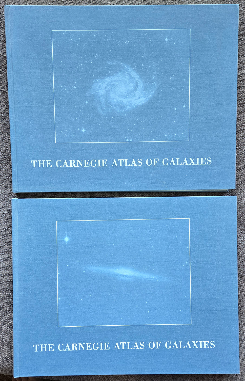

I recently had dinner in Montana with a couple of my former grad-student buddies from "Optical Sciences". As we were finishing dinner, the subject of my telescopes came up and like many of us, one of my buddies had gone into optics by way of astronomy like I did. His wife, mentioned that she had worked at the Carnegie Institute for something like 17 years and that she had some old Carnegie atlases that I might be interested in. She pulled out three volumes. The first was the "The Hubble Atlas of Galaxies" by Alan Sandage published in 1961 (#618). It's a coffee table size atlas that covers the Hubble classification of galaxies with plates taken by the 100" and 60" telescopes on Mt Wilson along with the 200" Hale telescope on Mt. Palomar. The second was a two volume set of the "Carnegie Atlas of Galaxies" by Alan Sandage and John Bedke published in 1994. This is a monster 13.75" x 17.5" atlas probably intended for reference libraries. The high quality plates are mostly images mostly from the 200" Hale telescope and it's printed on heavy duty, archival quality paper. Together the two volumes weight 23.6 lbs! It's not something that you take to bed for some light reading before turning off the lights! This atlas has been out of print for some time and these copies were in very good condition (mostly just dusty) so when my friend's wife asked if I wanted to buy this stuff, I just said "sold."  You can find this atlas on line here: https://publicationsonline.carnegiescience.edu/publications_online/galaxy_atlas_1/default.html and here: https://publicationsonline.carnegiescience.edu/publications_online/galaxy_atlas_2/default.html. They aren't easy to copy but you can look through the plates fairly easily. The images in these books provide a look back in time at the leading edge technology that Edwin Hubble and others had available in June, 1949 when Hubble published a paper in the Astronomical Society of the Pacific showing the first images from the 200" Hale telescope. Remember that back then, images were made using photographic plates. The plates were often cooled and specially treated to reduce reciprocity failure (i.e. nonlinearity) and to increase sensitivity. Each image was taken with a single exposure. I think that many of us take for granted that we can buy a relatively inexpensive cooled digital camera that is FAR more sensitive than what Hubble used on the 200" scope. With modern digital processing, backyard amateurs can easily calibrate their data, stack up exposures of tens and even hundreds of hours, and produce images with small telescopes that astronomers even in the 1970s and 80's could only dream about! The comparison below shows the difference using Arp 271 as an example. The atlas image on the left was taken with the 200" (5-m) Hale telescope using film and a single 40 minute exposure. You can see that the level of noise due to photon noise and film grain is pretty high. The matching scale image on the right was taken with my 24" telescope using a modern, cooled CMOS camera. The complete LRGB data set was captured in 32 h 50m and processed digitally. This is a very clear demonstration that relatively small amateur telescopes are capable of taking images that far exceed what could be done just 40-50 years ago. It is even difficult to distinguish between some of the small background galaxies and the stars in the 200" image. It took a while to develop high sensitivity, high resolution solid state sensors but it's obvious why they very quickly replaced film for virtually every form of imaging.  These atlas's are full of other striking examples like this one . Regardless, I'm really enjoying looking at was was done with these legendary telescopes before the age of digital sensors. It's not hard to think back to a time when it was almost inconceivable that telescopes could be made larger than the 200"...and now a 5-m telescope is almost considered to be a "garden-variety" instrument! During my early career, I was very lucky as a grad student to be around as Roger Angel worked on spin casting his first mirror and developing the warped lap figuring technology that were two critical technologies that would enable the production of his pioneering 8-m mirrors at the Large Mirror Laboratory (that he later founded at the University of Arizona.) That was the genesis of the next generation of large telescope technology now incorporated into so many new observatories in Chile and elsewhere around the world. It is also pretty cool that the dynamic interferometers that we invented and produced at 4D Technology were critical to making these mirrors as well. Our interferometers were used to test all of the mirrors made and delivered by the Mirror Lab...but that's another story. John

Thank you John for the good read. That's the kind of content I come here for. Regardless of the great advances made in the field, one can be charmed by the pictures made at the time…and frankly, impressed. Manual everything, single frame, no hardcore digital processing, and yet, there is some quiet, delicate fragility, alongside great detail in these galaxies depictions. I envy your books  |
