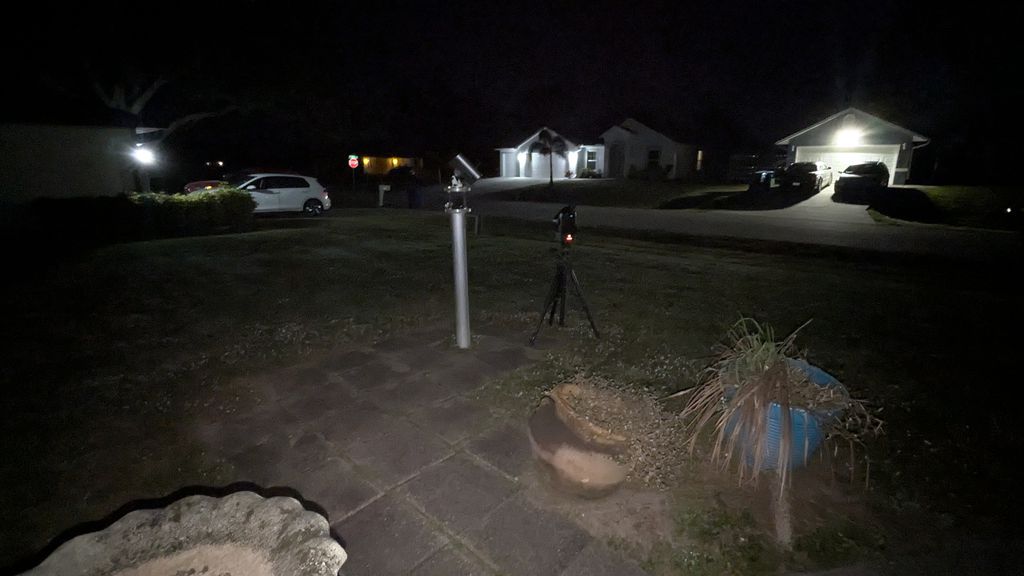

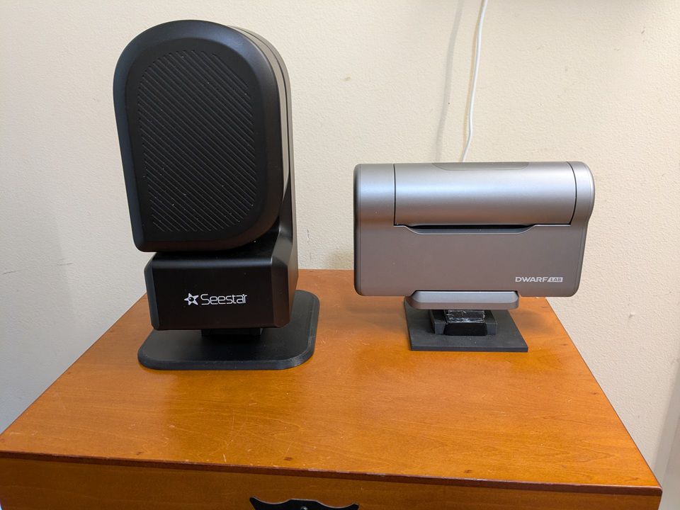

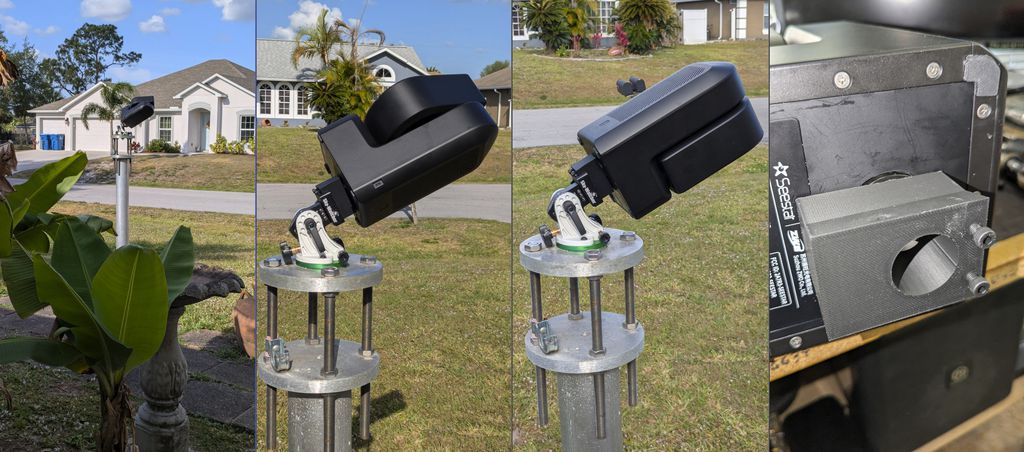

I'm using a Skywatcher but I also have it mounted to a pier and I'm using a 3d printed dovetail extention to raise the S50. You can do this with any post in the ground which speeds everything up. The Skywatcher never changes this way. I drop the Seestar on the wedge and it's always aligned. I just do the standard alignment before imaging but I have nothing to adjust. I do the same with my Dwarf 3 just using the Skywatcher Dovetail. And yes the Skywatcher is rusting and that happens in Florida so I have a spare if I need to replace it some year. I have 2 stands that I use to hold the scopes in the house.
The main reason I do this is where I live I never get 2 nights in a row to shot let alone 2 hours and sometimes it's as much as 4 months without being able to shoot. I have to be able to setup very fast. This allows that.

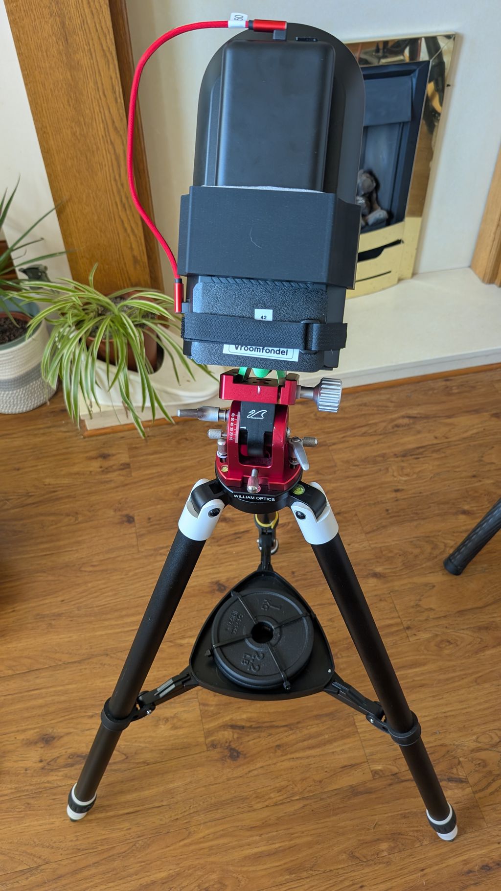

Vroomfondel 0.90
I use the William Optics wedge. Quite expensive but a quality piece of kit. Easy to use.
