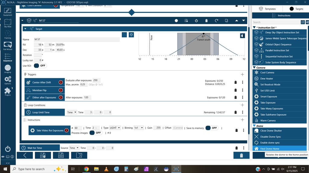

Does anyone have any experience with the Lucky Imaging plug-in for NINA? I have what I think is a reasonable sequence but would love any additional pointers. Here's the main seq. loop:  Ignore the wait for time at the bottom. Basically what I think I'm telling the system to do is: Plate solve to target Take 60 ser video frames of 2 sec. each Check trigger conditions Continue until 3 am I'm not sure if it will consider each video frame as an exposure or the entire take video command as one exposure.

Tony Gondola: Does anyone have any experience with the Lucky Imaging plug-in for NINA? I have what I think is a reasonable sequence but would love any additional pointers. Here's the main seq. loop:
I'm not sure if it will consider each video frame as an exposure or the entire take video command as one exposure. Will 2sec swamp your read noise? Maybe if bortle 9?

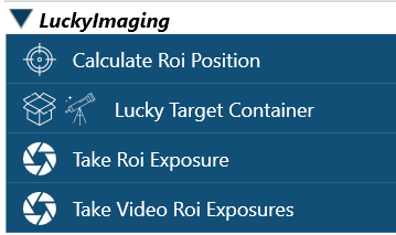

Hi Tony, you have to use the Lucky Container. good luck  from the plugin description: --- You will need to add the 'Lucky Target Container' and within that add the 'Take Video Roi Exposures' for taking images. Please add these imagepath variables to your filename: $$LUCKYRUN$$ $$FRAMENR$$ This way your filenames will be unique. The LUCKYRUN variable will increase everytime you run the 'Take Video Roi Exposures' instruction and you can view/set it in the container. Also note that one run of the 'Take Video Roi Exposures' instruction will be seen as taking one image. So if you want 500 images of 1 second, it will be seen as a 500 second image. There will also be some overhead, so it's not completely accurate. But if you want to dither or autofocus or things like that, don't create a very large instruction.

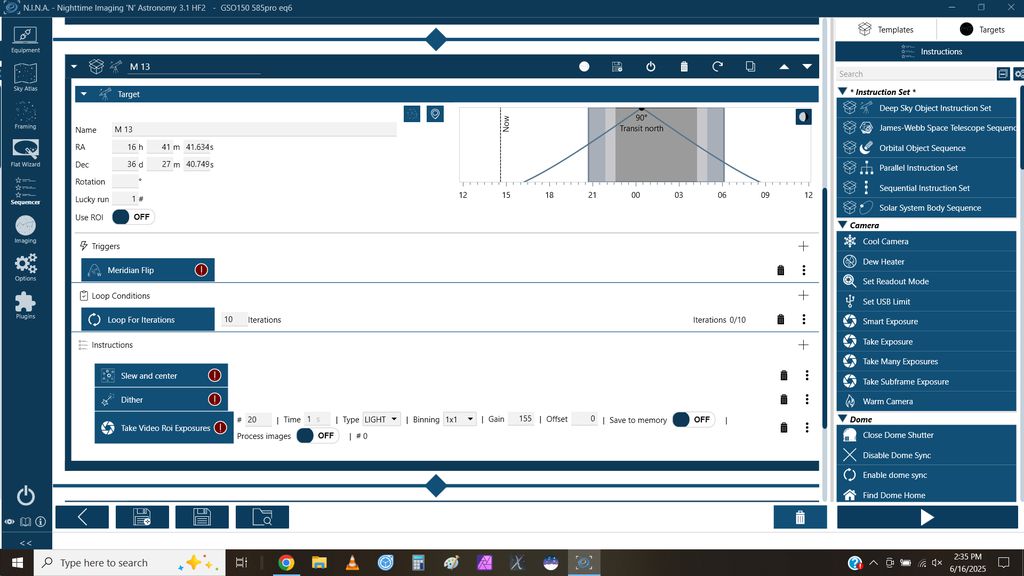

I got a chance to talk with Nick Holland, the result of that is a new sequence that I'll experiment with this evening. Here it is if anyone is interested:  This is between the usual beginning and end sequences. In this case the slew and center command is taking the place of the usual center after drift although I suspect that the number of frames captured while taking video should be a lot higher for that approach to be efficient. I'm not using the ROI option yet as I'm just testing for basic functionality and see how more effective it is compared to a standard sequence. If it works well it will allow me to stay within NINA for this kind of work which to me, is a plus.

Actually, the Lucky container only saves the images as standard fits files. According to Nick, he's planning on adding the ability to save the data as a ser file sometime in the future. The advantage I would see is having one file rather than several thousand making it easier to process in Siril or other programs like Astrosurface. That said, I'm perfectly happy with fits so I'm not sure it would help me at all. The plug-in does have the ability to specify ROI so that's already implemented. The main thing I'm looking for is better efficiency when working in the realm of very short exposures of just a few seconds. I tested it last night with 2 sec subs on M92 and it worked well giving me an efficiency of about 82% as compared to using a standard NINA sequence which gives me closer to 50%. I haven't tried just turning off all of the processing in NINA yet, I might get the same gains as using the plug-in, we'll see.
