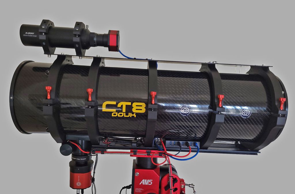

John at OOUK made me a CT8 with no finder scope holes and no rings. With that in hand Rouz and I went to work. We designed a 5-ring system and Rouz did what he does best and I couldn't be more pleased with the results. My goal was to maximize optical train stability. The 1st ring transfers stability from the forward metal OTA ring. The 5th ring transfers it's stability from the rear metal plate. Rings 1 and 2 sandwich the focuser mount plate to add stability to the imaging train. The top carbon fiber plate and the lower full length losmandy form a cage to lock in the rings and provide a stabilized cage system. I used carbon fiber rings from Rouz Astro for the finder also for light weight stability, no puny 3 point rings allowed. This finder is stable to compliment its host scope. I must repeat I couldn't be more pleased with how the project turned out. With state of the art technology such as this we all should be using carbon fiber rings from Rouz Astro. Carbon fiber is both lightweight and exceedingly strong. This rig is both stabilized and light weight letting your motors work less and thus more accurately. Dale P Carriere  |
Is that for a fighting tank?
Could double as one. it ain't gonna bend today or tomorrow. And it's light enough that my 87lb wife can pick it up. She did it.

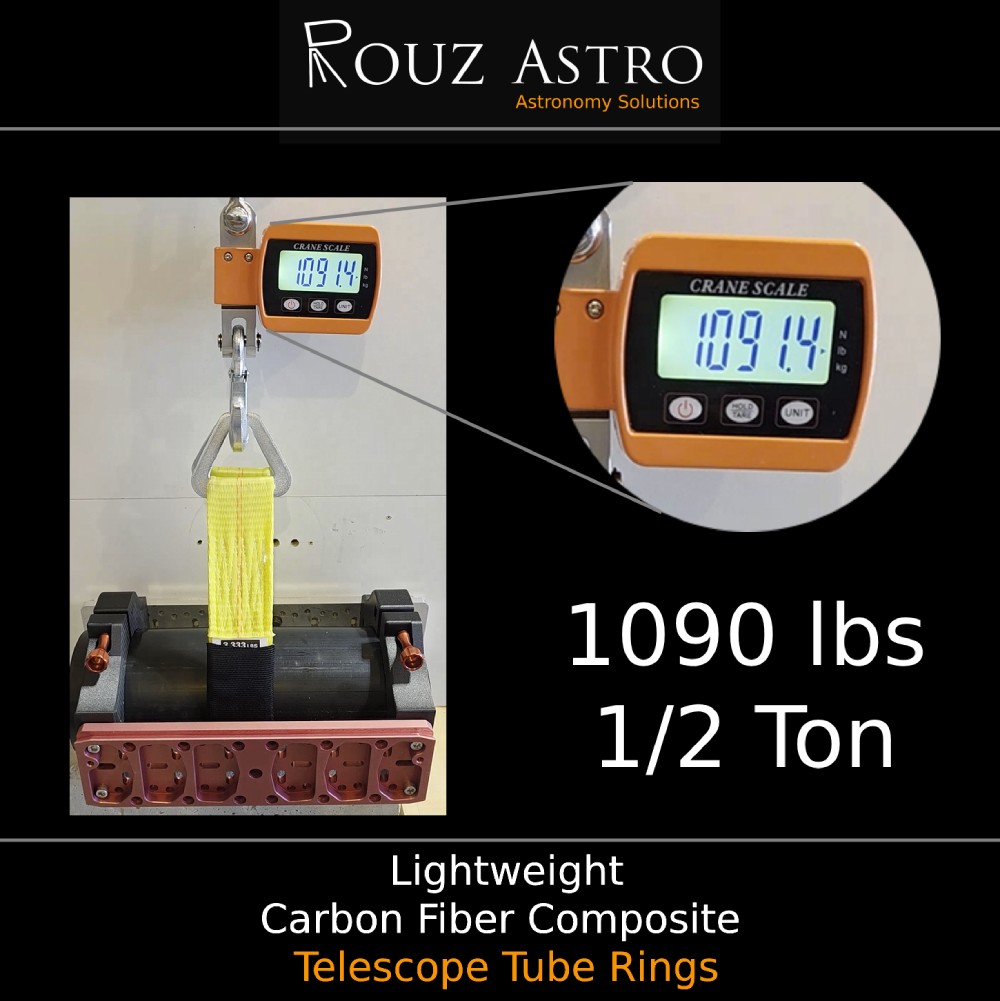

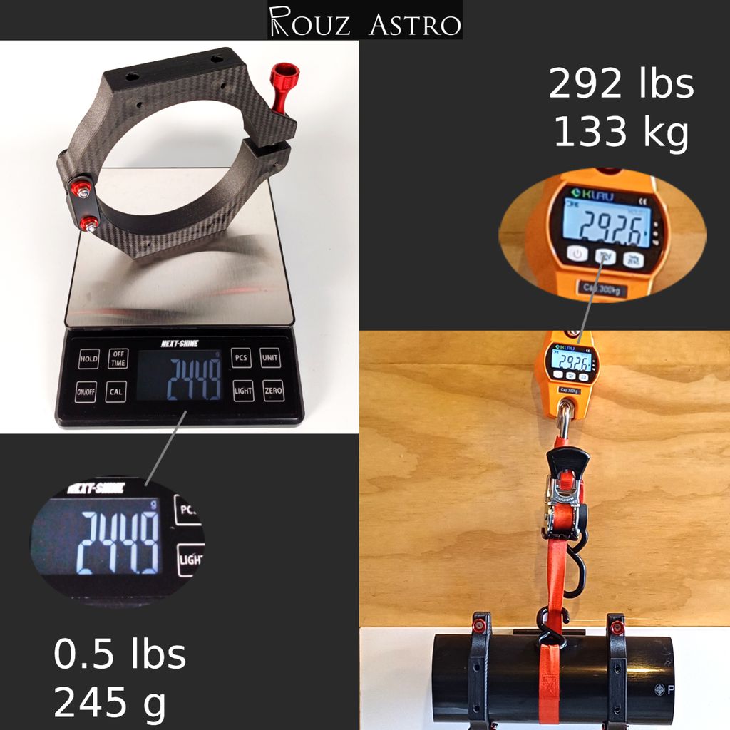

Here is a test of one off our smallest and lightest rings. We use engineering grade materials as well as design and manufacturing techniques that allows these parts to carry hundreds of pounds with ease: Video of a sample test: https://youtu.be/mv38p-yuD-c?si=zs1j5cG3Y6CRDl_x |

I must say, that is a very well done setup. Very clean and neat!
I must say, that is a very well done setup. Very clean and neat! Thanks JayBac. I try to keep cable runs as short as I can as that can lead to poor signal return. Dale
Here's a short clip with another test of the rings: That should be enough strength for the average telescope! Each ring is made of 35 individual parts. After countless iterations an simulations, we are very happy with the current design. YouTube Link: https://youtube.com/shorts/wTsIifWYCy4?si=MVPjQdOntBixRfBT
