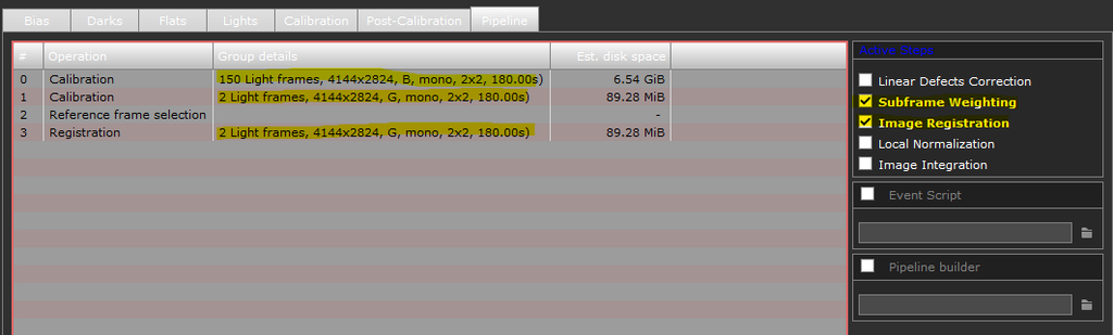

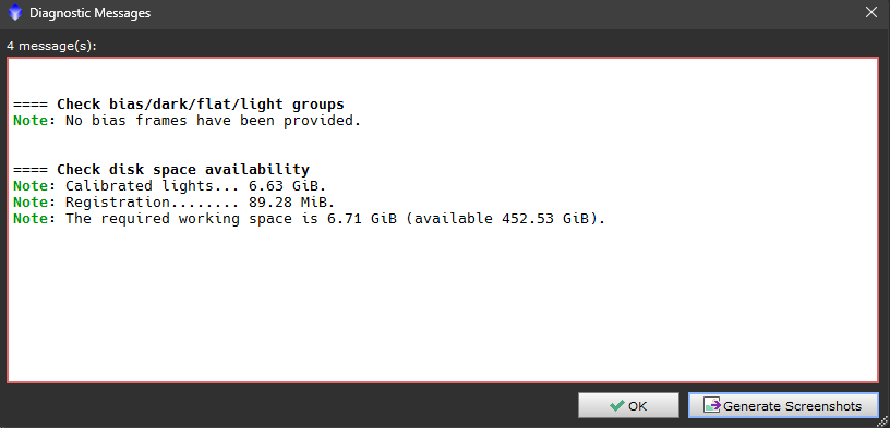

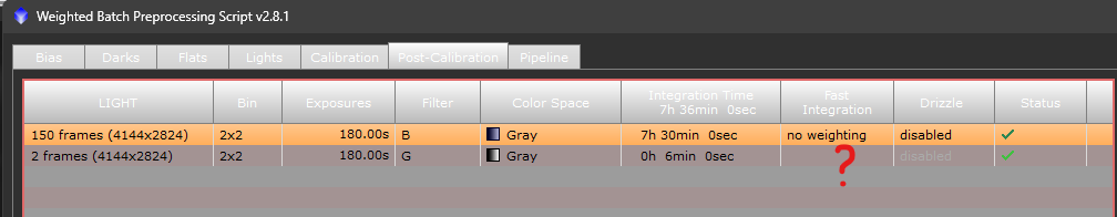

Hello all. I'm facing a problem I don't understand why is happening. WBPP (v2.8.1) won't show in pipeline or diagnostics the registration of B frames but will register any other filters of the same target. It seems like it happens randomly for some filters for some of my targets. It shows no errors, no warnings, no nothing. It just refuses to register. I don't know if it is a bug or if I'm missing something really important... I never had this issue until last month. It also seems that it won't weight images as well, making it harder for me to use the NSG script for gradient correction, as it relies on subframe weighting to sort frames. Subframe weighting and registering boxes are checked. I also tried using both auto and manual registration reference modes. Below is 2 frames of G to show that other channels will work, except one specific. It is not a B problem, it happened to L the other day on another target. Had to use star alignment to register my frames for stacking, but I don't like this workaround.    |

I notice that the reference frame selection is blank. What settings are in WBPP for the reference frame? Is it set to auto or have you provided a specific reference frame?
Rodney Watters: I notice that the reference frame selection is blank. What settings are in WBPP for the reference frame? Is it set to auto or have you provided a specific reference frame? It is blank because I tried resetting to 'factory standard' settings. But didn't work as well. I provided a specific reference frame earlier and also tried auto. Both times WBPP didn't generate the registered frames.

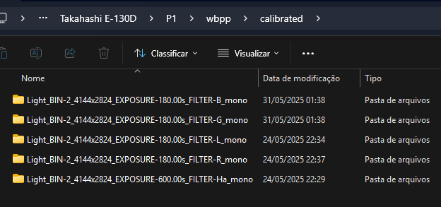

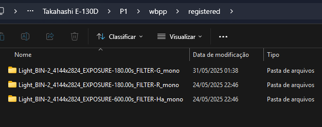

Charles Bradshaw: You only calibrated two frames. You need three or more to register. Why are your frames not calibrating? The prints are for illustration only, I have more frames to register, 150 B frames to be exact. They do calibrate but won't register. calibrated folder:  registered folder (195 L frames and 150 B frames missing):  |

I found a way to quick fix my issue for people experiencing the same:
In the lights tab, click on the registration settings (gear icon), and change any registration parameter you wish. This will make WBPP allow your frames to be registered and will work as it should.
So, for me this is clearly a bug that probably came from the last update. I will try to report this to PixInsight developers and hopefully they will fix it.
