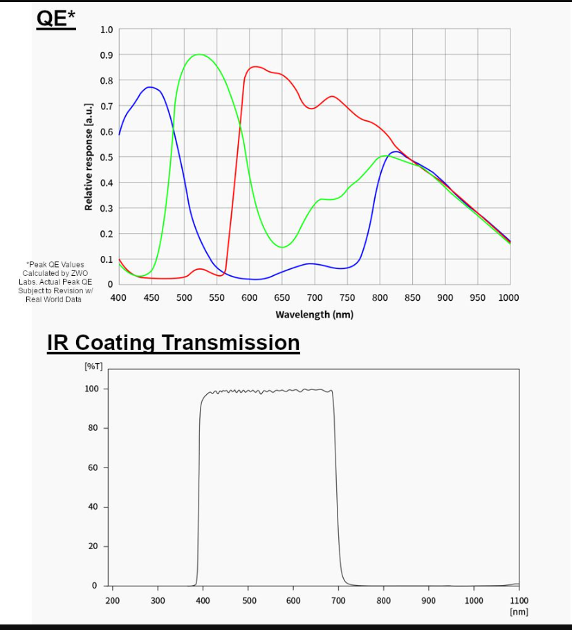

AstroÅmazer: IMX 585 Who has added a uv/ir cut window?
That link doesn't work but I looked at the listing on HighPoint and it says nothing about the 585mc-air having a uv/cut window which wouldn't make sense anyway on a camera that is sensitive beyond 1000nm.

1. I read that the asi585mc air changed the glass and now includes an IR/Cut filter on the camera. I cant validate this, but it seemed reasonable. 2. I know for a fact that the camera is an m48 connection, they include a m42 to m48 step up, but looking at that guide sensor in the images, I question if you can actually guide if you are using an m42 connection 3. For the life of me, I cannt understand why the guide senor is next to the main camera sensor instead of above or below it.

That would seem to be very counter productive to do that on a cooled astronomy camera. I can see where it would be a feature for the kind of setup you're talking about but it would be a non-starter for a lot of imagers. I agree on the placement of the guide sensor but I don't know what the boards the sensors ride on look like. It might very well have been a layout issue.
Tony Gondola: That would seem to be very counter productive to do that on a cooled astronomy camera. I can see where it would be a feature for the kind of setup you're talking about but it would be a non-starter for a lot of imagers. I agree on the placement of the guide sensor but I don't know what the boards the sensors ride on look like. It might very well have been a layout issue. The asi2600mc has the IR/Cut window glass, and that camera is 3x the price of the 585. I owned a standalone 585 for a long time, the (extra IR sensitivity) is super over blown as far as being a benefit in my opinion. I got to the point I was always putting an l2 ir cut in front of the 585 anyway, (or something stronger if I was doing nebula), so I dont see it being counter productive, but thats just my opinion. I have to put an ir/cut on my asi533 to make it usable at all, so I would have preferred that ship it with the glass already

I have to put an ir/cut on my asi533 to make it usable at all, so I would have preferred that ship it with the glass already I think it depends on what you're doing. If you use reflecting optics which won't loose sharpness at longer wavelengths you would be throwing a lot of energy away by cutting off everything beyond 700nm.  It can be very useful to work in or include wavelengths outside of the usual uv/ir cut range. By making the camera window a uv/ir you are eliminating the option.

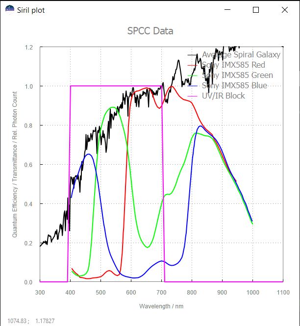

Tony Gondola: That link doesn't work but I looked at the listing on HighPoint and it says nothing about the 585mc-air having a uv/cut window which wouldn't make sense anyway on a camera that is sensitive beyond 1000nm. Here is the image:  |
Not arguing with the transmission graphs.
I am speaking to real work experience. (Only with refractors)
Without the ir/cut I had terrible pink/purple or green image casting and ridiculous halos ,with a fair amount of star bloat.
With the ir/cut it was a super easy to use camera.
That's my real life experience, I totally get what the graph says. That's the whole reason I bought it in the first place.
I may end up buying this anyway, regardless. So I'll report if new version has ir window or not.

I may end up buying this anyway, regardless. So I'll report if new version has ir window or not. My point is not that you don't need a UV/IR cut filter. For my stars, I definitely do. But on days of bad seeing, I prefer to use an IR pass filter to gather Luminance data from which I remove the stars. Anyway, I am going with the ASI533MC instead since do not want to spend on 2" filters/wheel.
