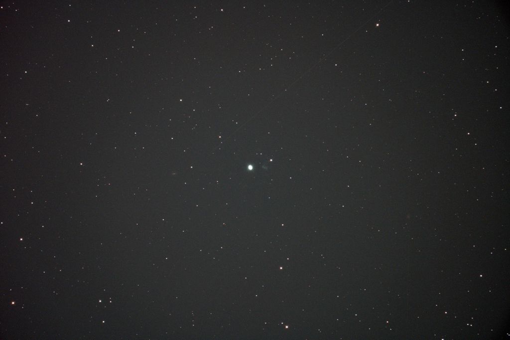

Last night, I finally had a clear sky to test my new ZWO ASI2400MC camera. However, I noticed numerous red, green, and blue dots appearing in the image, along with noticeable vignetting.
Does anyone know what might be causing this? Any insights or troubleshooting tips would be greatly appreciated!
Binning 1x1
300s exposure
Gain 100
Offset 50
Filter Antlia Quad Band
The R/G/B "dots" are quite simply hot pixels and should go with processing, if done right.  This is quite usual for that generation of chips (I have the same in my FF DSLR camera). As for vignetting, that has nothing to do with the camera itself, but with the imaging train/optics. I can't be surprised, as it is, after all, a full frame camera and expecting a full illumination with anything but either large fast apertures or slow system would be foolish.

Andrea,
Thanks for your insight!  Regarding vignetting, I appreciate your clarification,
it makes sense that it's more about the imaging train and optics rather than the camera itself.

Doesn't look like you used any calibration frames.   Dark subframes will remove the hot pixels while flat frames will remove the vignetting and any blemishes found in the imaging train. Andrea is right, the suitability of your CMOS sensor and optics will affect the outer edges of your subs.   Use the tool, Astronomy Tools, to determine the compatibility of your set up Of course, you'll need Dark/flats to calibrate the flat frames or Bias frames.  I find dark/flats work best for me with the ZWO cameras.  More work to all this than meets the eye but well worth the effort when you see your results in the final image.
Clear skies,
Patrick

Thanks Patrick,
I posted a single FITS file and was curious because this issue never occurred with the AS2600. I was wondering why. I used astronomy tools, and it seems the camera should work well with the RC 12"
Perhaps I'm missing something, but I appreciate your input!

Light drop doesn't equate to vignetting or at least in the sense of clipping of the marginal rays. From what I can see…

Light drop doesn't equate to vignetting or at least in the sense of clipping of the marginal rays. From what I can see...
Andrea,
That's an intriguing idea! Tonight, I'll be capturing some photons and diving into the image processing and I am curious to see what unfolds.
