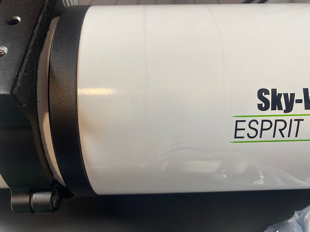

Just a heads up in case you have one on your kit. I have been using a 12v SVbony dew strap for 11 months, and a few days ago I took my rig apart to fit new scope and sell my mint Skywatcher Esprit 100, which was in unmarked condition, wrong, when I removed the dew band it’s left a mark all around d the full dew shield, not sure if it’s a scorch mark or just dyed the paint, but I have tried everything and it will not come off, it’s there for good. Now I am not the only person this has happened too, the exact same had happened to 2 other people I know of. the dew strap was used with the supplied controller on level 2, from a 12v supply, and then connected to the Pegasus controller on auto dew setting with 75% max setting. so just as it should have been I am in contact with SVbony on why this should have happened, but I think it’s a combination of a poorly made and much too powerful (20w 😮) dew strap, and very poor cheap paint on the Esprit scope tube. see image below  |
I reakon some automotive polish will clean it up, the lighter duty stuff (:
Jordan Morley: I reakon some automotive polish will clean it up, the lighter duty stuff (: No, I have tried it all mate, even strong cutting compound, and it’s made no difference, trust me I would not have posted this if I had not tried everything first, I worked for 3M and have all sorts of car paintwork chemicals and no this has worked…☹️
Same on my Askar 120APO.
I am going to replace it with a Prima Luce Lab one… it certainly doesn't get hot enough to be a burn, but I think it might be heat transferred dye from the black of the strap…
Alex Nicholas: Same on my Askar 120APO.
I am going to replace it with a Prima Luce Lab one... it certainly doesn't get hot enough to be a burn, but I think it might be heat transferred dye from the black of the strap... Yes, I think your might be correct, it’s seems to follow the line of the stitching around the edge of the strap… Contact SVbony and they will refund the cost of the dew strap, and are still talking with them on sorting it out long term..👍🏻
Dye from the band absorbed into the paint. Not a heat thing. No clearcoat to stop it like your automotive stuff. Now the next user knows exactly where to place the dew shield for maximum effectivity.
