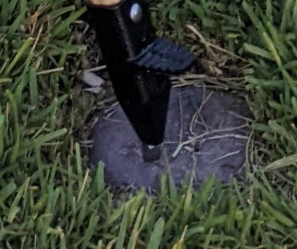

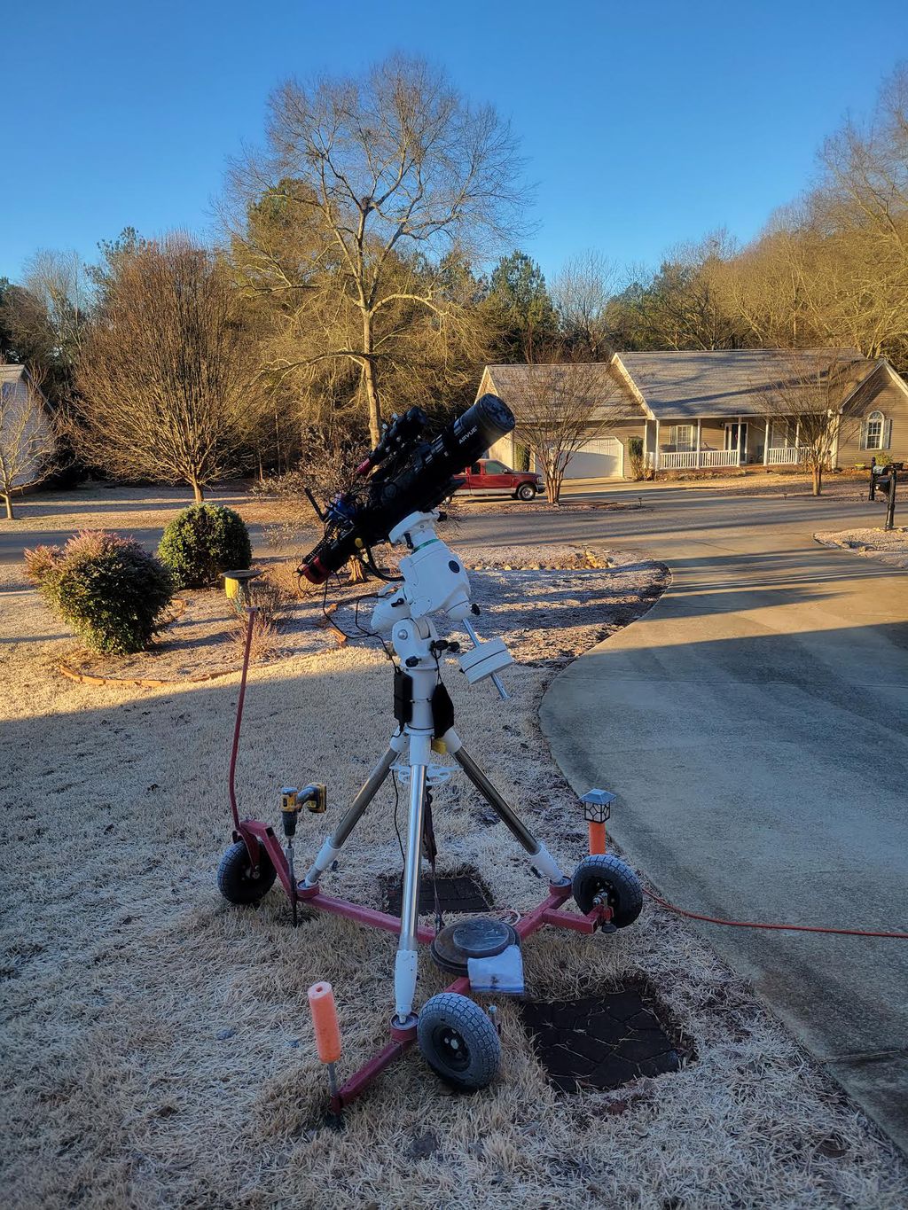

I don't have plans, I just looked at a few on the internet and made my own based on the dimensions of my mount. I am lucky as I have a small work shop I can fab and weld small project like this. I added outriggers to aid in stability and leveling and some weight. The outriggers are setting on concrete pads pored in the dirt. My outrigger leveling screws have points ground on them and their are pointy divots in the concrete, so I align the 3 screws in the divots and then polar alinement takes less than 5 min. Its HEAVY but solid as a rock. No issues with guiding or movement . Burrr, this picture was taken at 15 deg f last winter. Moving from my garage to this spot takes me 10 min or less. PS, if I didn't have the ability to fab my own, and after using it for a year, I would consider buying the "Scope Buggy" I see advertised in Astronomy mag's. I think they run about $350. REALLY speeds up set up things being able to wheel it out level and PA very quickly. I leave mine on the buggy when parked in the garage. My truck sits outside lol  |

Every one of the dollies shown here share a potentially fatal flaw. None of them appear to have a jack screw for lifting to dolly off of the wheels for imaging. Imaging on a wheeled dolly will almost certainly limit the quality of the results. Another potential problem is the use of wood, which isn’t mechanically very rigid. Wood can work for a small light scope but just don’t touch anything while the scope is running. Remember that at 1”, everything (even metal) is made of rubber! That means that you should use the most rigid materials possible. You can see the roll out platform that I built for my 20” scope here: https://www.astrobin.com/dlko5b/N/I was concerned that this setup might ring as well, but it turned out to work really well. The entire rig weighed around 700 lbs but it took two fingers to roll it out and it provided sub-arcsecond stability. It was also extremely easy to polar align. I didn’t realized it when I designed it but the arrangement of the jack-screws provided near orthogonal polar alignment capability in altitude and azimuth. Using a PoleMaster, I could have PA done in about 5 minutes and a 70 point full sky model done 10 minutes later. John
John Hayes: Every one of the dollies shown here share a potentially fatal flaw. None of them appear to have a jack screw for lifting to dolly off of the wheels for imaging. Imaging on a wheeled dolly will almost certainly limit the quality of the results. Another potential problem is the use of wood, which isn’t mechanically very rigid. Wood can work for a small light scope but just don’t touch anything while the scope is running. Remember that at 1”, everything (even metal) is made of rubber! That means that you should use the most rigid materials possible.

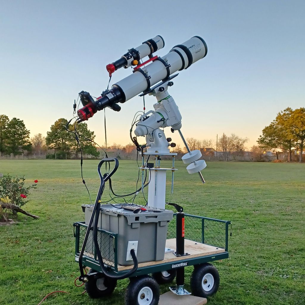

A little late to the party but here is my so called Dolly.  |

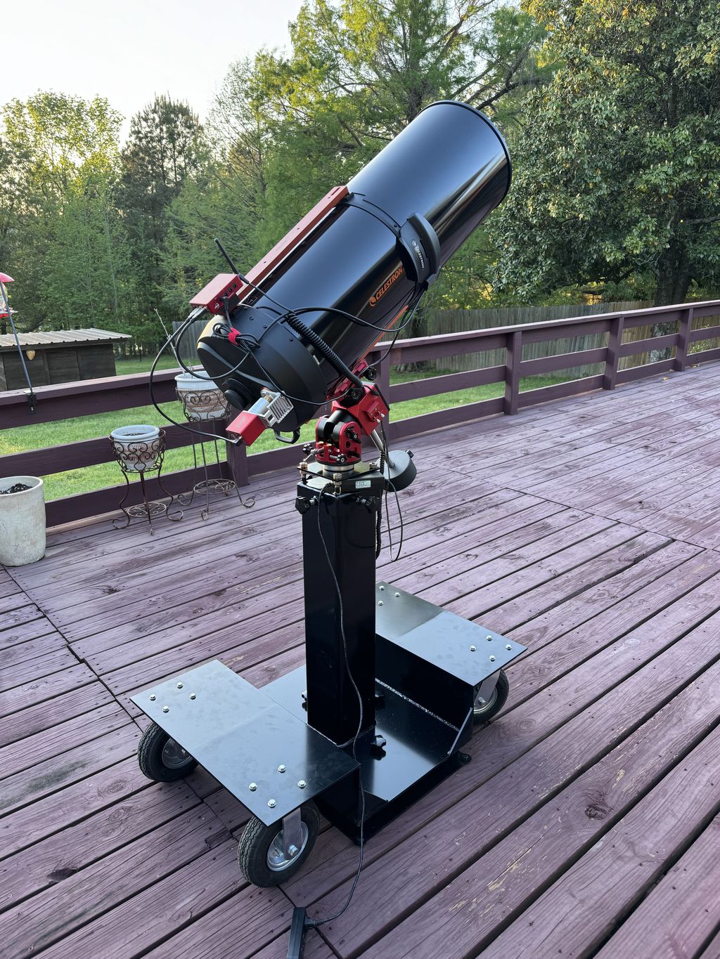

https://www.uline.com/Product/Detail/H-5245/Dollies/Leg-Dolly-2-Casters?pricode=WB1828&gadtype=pla&id=H-5245&gad_source=1&gclid=CjwKCAiA-bmsBhAGEiwAoaQNmtg_AUukbfA8Qqkl9c-o7Larow9dx-HeZvNNgBWuejVG4H4rizi7phoCggIQAvD_BwE Hey Monty, Those would work great however, my driveway is all rock, no concrete. Hence the much larger rubber wheels on the wagon, it rolls over the rocks much easier. Good choice though for those that have concrete to roll on. My old house had a concrete driveway and that would have been great for the casters. Thanks for sharing, Clear Skies, DJ
@Roy Hagen Excellent idea Roy.. Love the ingenuity and making it work as needed. Good job. DJ
Good job.
DJ Thanks, DJ👍 It is as far as I can see, a very stable dolly

Love that pier cart @Roy Hagen! Yeah, both of those would have been too wide for my application and yeah, so sorry to hear about the C11 being dumped, that would be awful to deal with. Hope you get that fixed and back into action soon. Clear skies, DJ

Love that pier cart @Roy Hagen! @JayRuhMe Thanks, my friend. I do not claim any copyrights on this one🤩, I just have to make something to fasten the pier to the dolly.

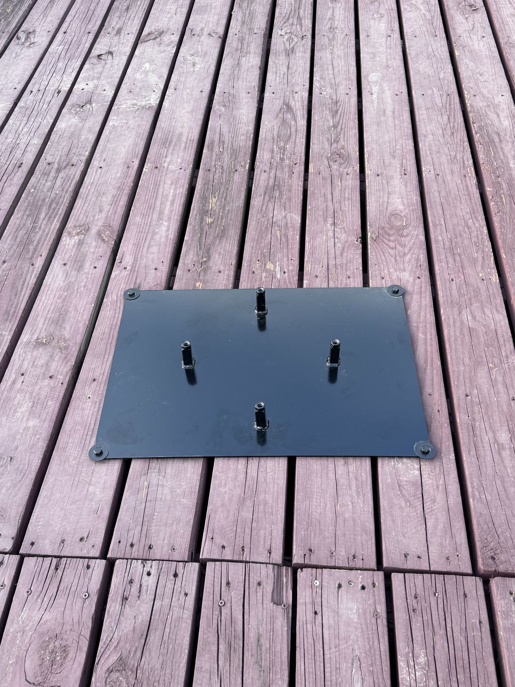

This thread inspired me to go and solve for some problems that myself and others have had when it comes to moving large telescopes around. Below is my beta/POC version of my first Mobile Pier Cart. I plan to start my own little business and sell this and a few other models I'm still designing. Details are as follows: - 6-inch, hollow, square pier. This allows you the option to fill with sand for vibration dampening.
- 1/4-inch plate on all parts
- Pneumatic casters on sealed hubs
- 25-inches wide, 40-inches long. Fits easily through standard interior home doors.
The deck/slab plate can be mounted to a wooden deck or concrete patio slab. The cart rolls over the deck plate and screws down into the deck plate to lock the cart in place. This will help in maintaining polar alignment and prevent any accidents from happening where the scope may tip over. I am planning 3 models to support scopes of various sizes. The problems that this cart solves for me are: - Stability in imaging
- Ease of setup as it never has to be torn down.
- Rolls very smoothly across any surface.
- Allows me the convenience of having a pier and being able to move my equipment indoors nightly.
First night imaging with a C11/Hyperstar on a AM5 I was averaging .5 RMS in light winds. A second night with 20+ MPH gusts put me at .8 average. I'm happy so far and have testing this week at 2800mm focal length. We'll see how it does there.   |

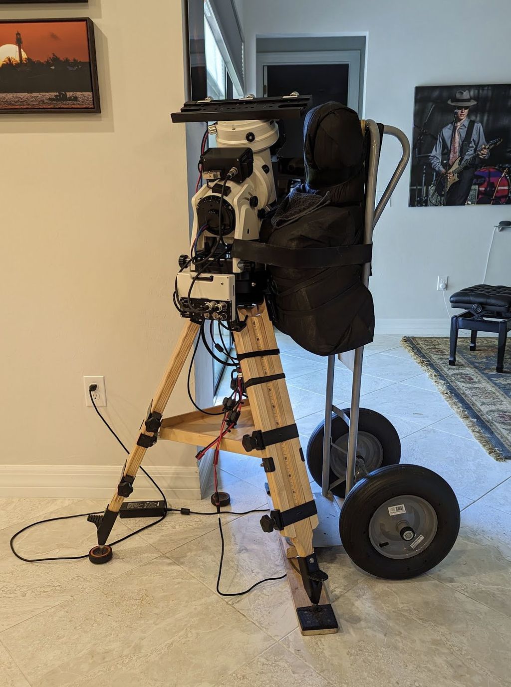

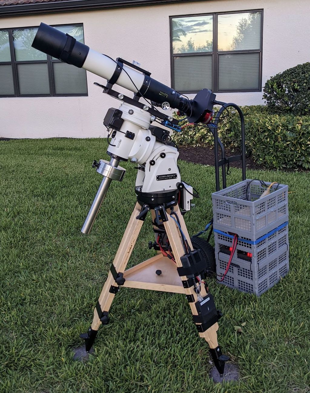

I just go from garage to driveway and have a JMI Medium Heavy Duty Wheeley bar for my setup which works very smoothly for moving the setup around. But neither the wheels nor the screw risers were sufficiently stable for imaging. I removed the screw risers and cut up some 6x6 wood blocks and a small lifting tool to raise each leg up onto the blocks ( https://www.amazon.com/dp/B0CJFW9FY5?ref=ppx_yo2ov_dt_b_fed_asin_title) . Takes me a few minutes and allows me to fine-tune the leveling with shims and is absolutely rock solid.
