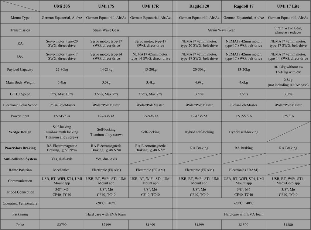

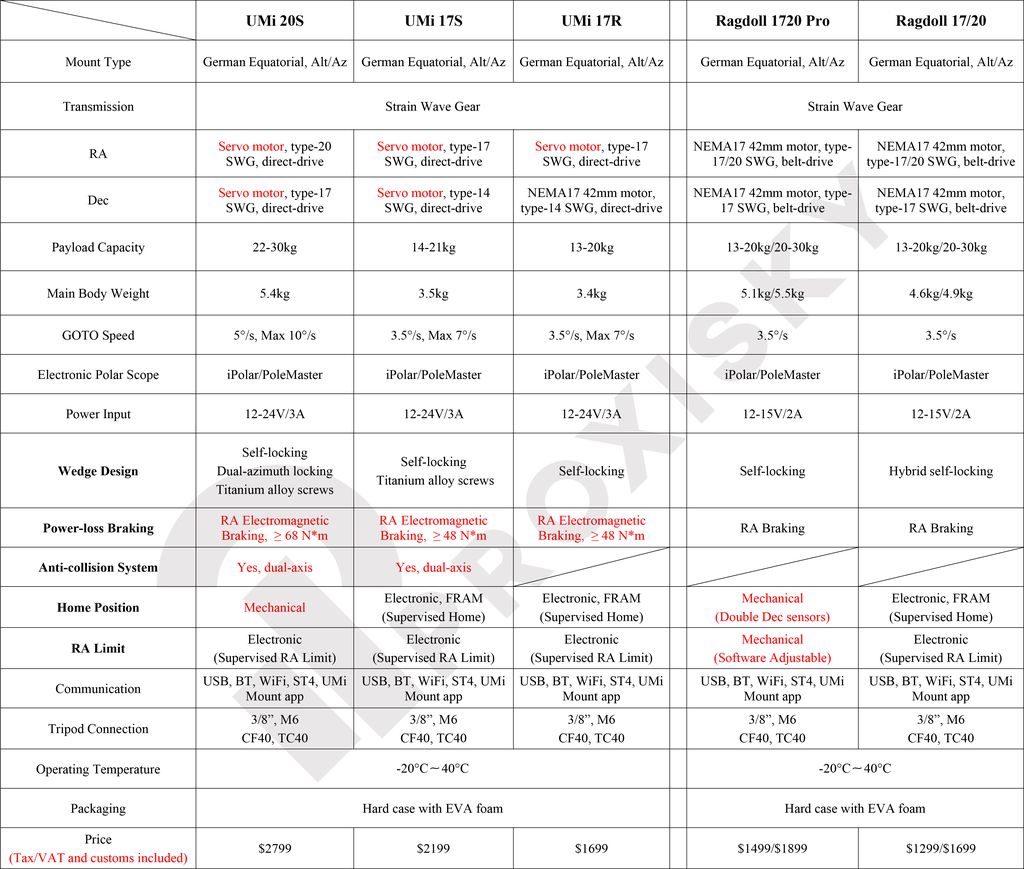

Thank you @Phil Wright for the tag! I hope I wont turn this into an AD so i'll make it short and attach an updated specs table. So in short, for Proxisky SWG mounts, the Ragdolls use stepper motors, while the UMi series use at least one servo motor on RA (with 17S and 20S using servo for both RA and Dec). If you're looking at a traveling mount, 17R is perfect for you with 13-20kg capacity and only weighs 3.4kg. Phil already provided a link to our website, so please allow me to also include an invitation to our official Discord server. Most of our users are here sharing their setups and experiences of our mounts, and we work tirelessly to provide after-sales services here. Link: https://discord.gg/FbQMVSyaVTThank you for your time!  |

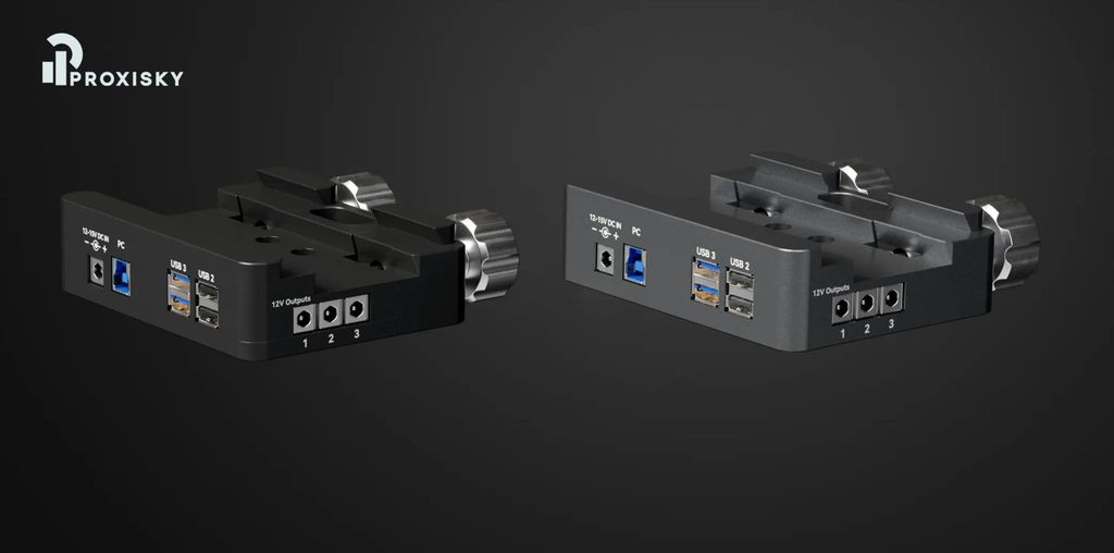

Also, you can get the Proxisky Ragdoll mount above with their new power saddle - which looks cool:  |
