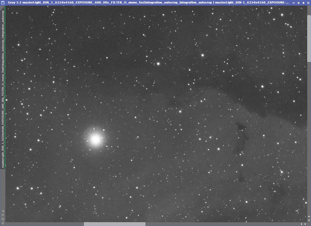

And here is the OIII raw stack with no processing further than an aggressive screen stretch, cropped to show the result around Lambda Centauri. As you can see, there is a very small, tight halo here around Lambda Centauri, however, in the final image, I was able to completely mitigate that by stretching the stars separately from the nebulosity, and in the final image, it can not be seen at all.
