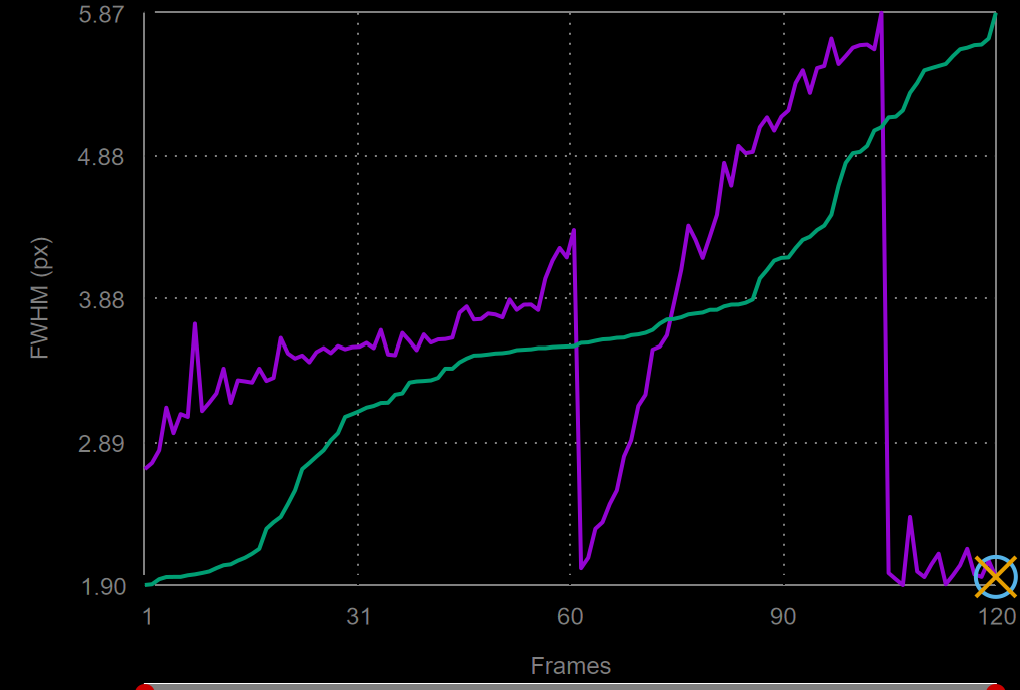

After discussing in NebulaPhotos' discord I believe I've observed much more intense temperature sensitivity in focus with my SQA55 than when learning with my roki 135. The drop in the middle of the graph is the start of night 2. The first night I had my ASIAir in live mode so it did not automatically rerun autofocus. The 2nd night I used autorun mode and it appears to have autofocused after ~45 2min exposures. The ambient temperature dropped 6c over the course of that drift out of focus.
What we believe therefore is needed with this scope to maximize its potential is to carefully acclimatize it before usage, such that the first focus run is at a stable temperature, and then aggressively rerun autofocus to 1c of change (I had my ASIAir set to 2 and it didn't pick up and rerun until at least 4c of change).
jpsc01 0.00
I'm betting more for a shift of the objective in the tube
this is what I've experienced from my side.
huge shift in translation (this is why of course my last focuser movement is against gravity)
medium shift in rotation too
cheers

@jpsc01 can you detail what you mean and how you're mitigating it? I'm running autofocus once positioned towards the main target so I'm not sure how the objective would further settle against gravity. It should be clear enough for me to test the acclimatization tonight and/or Monday.

jpsc01 0.00
Ok, so here is all I've discovered with this APN objective. It's important to mention this is an APN objective as the focus consist to move the objective inside de tube here...
-To reduce backlash you have to put the "fine focuser" ring in one of its course limit. Only one side is working to reduce backlash
-if you have a medium to heavy camera (like me with the QHY600 + filter wheel), then the weight of the imaging train will make the objective to move in the tube which will make mandatory to guide with OAG instead of piggy back.
-I've tried to build a lot of model with the 10micron 1000 and 2000 and all of them was catastrophic (30 to 60 arcs RMS), this was definitely  showing lot of flexure in the tube which make guiding mandatory
-you need to be sure the last movement of your focusing is against gravity when you are autofocusing
-I've swapped the rotating ring by a simple ring CNC and it's a game changer (not for the flexure but more because I consider that the rotating ring is an anomaly for many reason)...
-if you play with the extremity of the objective with your finger (when focused) you will see you can move the objective first  up and next down and also  rotate it.... Yes.. there is some play internally, you have to live with that (I'm suspecting some shitty plastic part not well adjusted inside the objective
I'm talking about that on CN here
https://www.cloudynights.com/topic/929708-askar-sqa55-55mm-f48-petzval-astrograph/?p=14030829
https://www.cloudynights.com/topic/929708-askar-sqa55-55mm-f48-petzval-astrograph/?p=13907345
Last but not least: sharpstar support is useless and pathetic. I've give up in the ticket I've raised with them....
cheers
jpsc01 0.00
Travis McGeehan:
simple:
with Nina autofocus, you can chose the  direction of the last movement for backlash correction: take the one which is IN-focus (I mean pushing the tube against gravity)
Also, I've set autofocus each 40 minutes max in my sequence and each 1°C diff
cheers

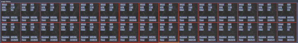

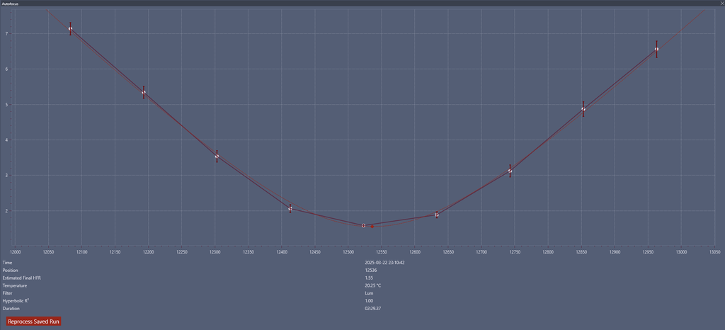

CAPastrophotography 0.90
I have the SQA55 as well with a ZWO EAF. I don't seem to be having the problem you are but I am running NINA with 3 focus triggers 1) HFR 10% 2) Temperature 3C and 3) Time 60mins. Below is part of the image history of my run last night spanning from around 7:30 pm to midnight and one of the focus runs:
