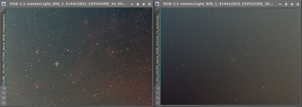

Images for Reference (Only STF applied after WBPP)Here are some to demonstrate what I am able to get in my skies: - Seagull Nebula (No filters used with OSC) - 30s subs, 1 hr integration
- Pinwheel Galaxy (No filters used with OSC) - 30s subs, 1 hr integration

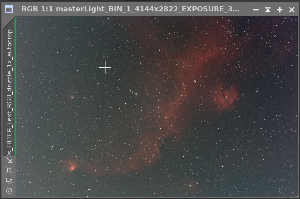

- Seagull Nebula (L-extreme) - 5 min subs, 7 hr integration

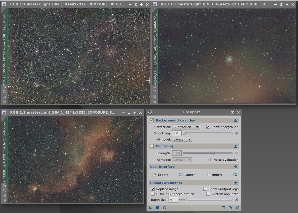

Adding a screenshot of gradient corrected images for comparing Seagull Nebula, and what to expect out of galaxy (a mess!). Just Graxpert applied after WBPP, no other changes. I have experience mostly with Narrowband imaging, so quite possible the flats are an issue when I created them for RGB (no filters ) - They were only 0.0015ms exposure. I have only these 2 hour of experience on broadband targets. First two images on top are without filters Bottom single image is with L-extreme filter  |
