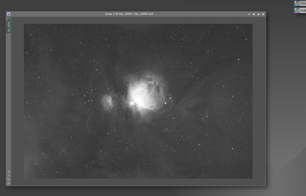

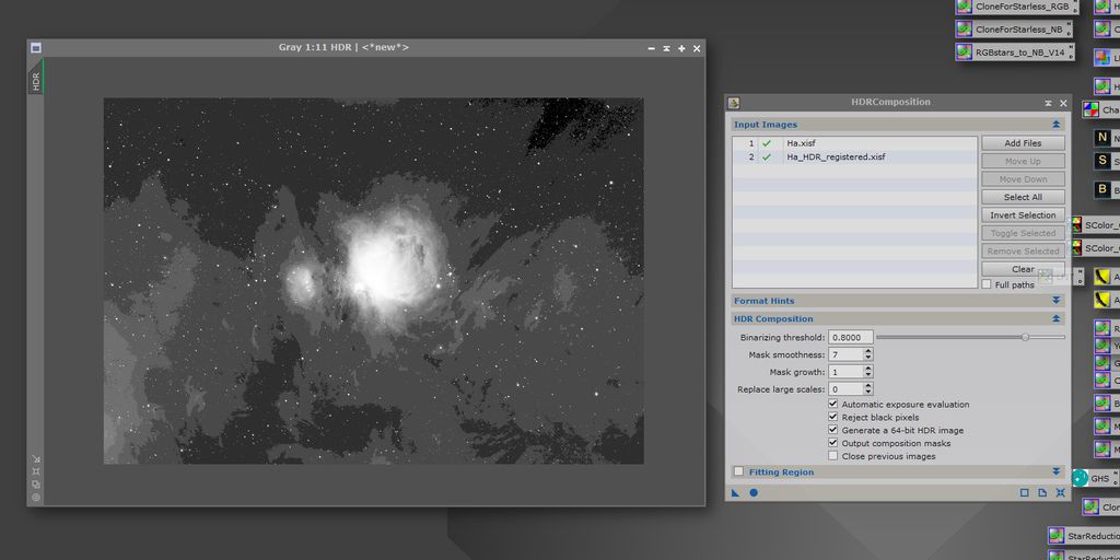

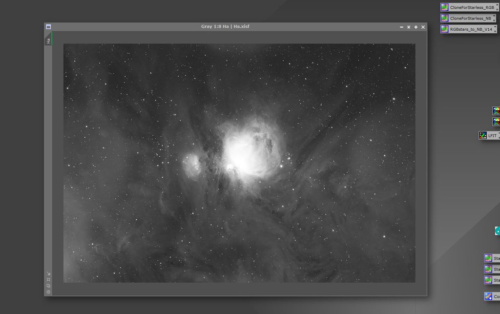

Hi! I'm having a problem generating my M42 HDR image in PixInsight. The resulting image is horrible. Does anyone know why? The HA master is 180 seconds at -10 C and the other is at 15 seconds at the same temperature. My camera is a ZWO ASI294 MM Pro. My filter is an Antila HA 3nm 31mm. My tube is a Red Cat III 250mm. When stacking in PI I selected to apply Drizzle. I appreciate your support, please!. Thanks! Clear skies!
Master Ha 180s

HDR =´(

Did you try to apply STF again and especially to apply it using 24-bit LUT?

@ArchStarGazer  Thanks so much ArchStarGazer! It's been fixed! I didn't know about that feature! I wish you clear skies without moon forever.
