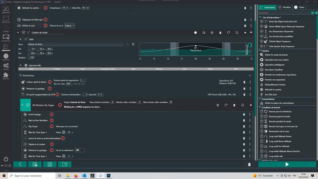

Hello everyone,

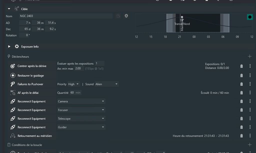

I have some problems with de Nina Meridian flip.
It always start at the beginning of the sequence, regardless of the time it's supposes to start.
My setup is:
  • AZEQ6
  • Player One Poseidon C
  • Redcat 61
  • Nina
  • PHD2​​​​​​​​​​​​​​GS server
Has anyone had a similar problem?
Capturedcran2025-03-02210906.thumb.png.18315c3d46cbf2f5d17190012caf0fbc.pngCapturedcran2025-03-02210811.thumb.png.33c0ae959d1c60dc0477f594a0df3541.png​​​​​​​
manu.zaitun 0.00
I think you should put the meridian flip order at the beginning of the sequence. Prior to Exposure info. Because the order of meridian flip applies during the whole session.
Scubapeks 2.41

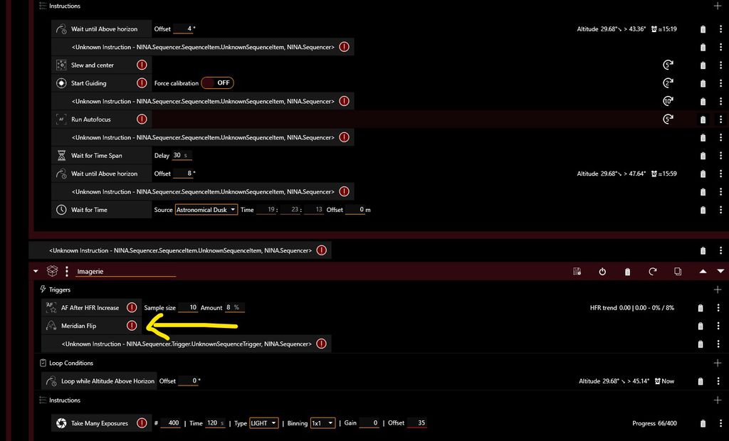

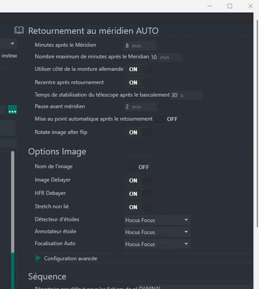

Justin, quand tu ouvre ton séquenceur, tu devrais voir l'heure à laquelle le flip est prévu de se faire. Est-ce qu'elle est correcte avant de cliquer sur START ? Est-ce que tes données de localisation (latitude, longitude) sont correctes dans NINA ?
Autre chose, pourquoi tu fais une pause avant le méridien ? S'il n'y a pas de risque de contact avec le trépied/colonne avant le méridien, ça doit être mis à OFF.
Dans mes séquences, le flip est programmé dans la section "Imagerie" dans la partie "Triggers" donc à chaque pose NINA vérifie si un flip est nécessaire ou pas.

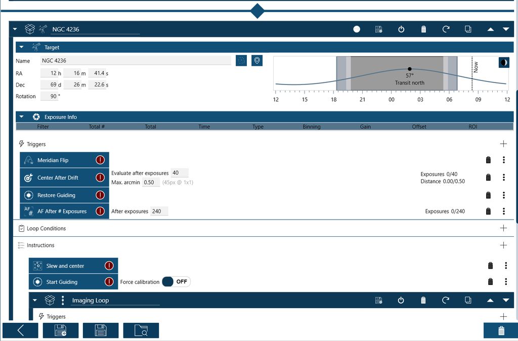

=Y2IQFcFor the meridian flip it is better to use the DIY meridian flip plugin

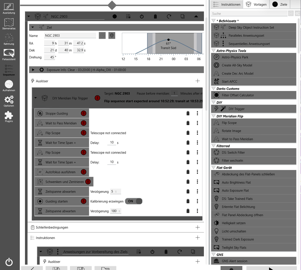

Useally, I have the followin as DIY Part at the beginning of any Sequence:
I have a skywatcher EQ6-R Pro and the meridian flip is tried twice in this part, because sometime the system does not react for the first meridian flip.
Here's how I set it up, works every time. The standard flip trigger works just fine. I don't think you mention what mount control software you are using but you have to make sure that it is in sync with NINA. In other words, the mount software flip window needs to be open when NINA sends the command.

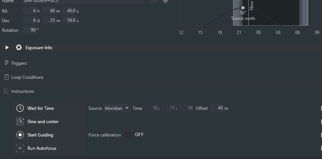

here an evidence that N.I.N.A. has trouble in advanced sequencer to calculate meridian flip: you can see from the graphic  that the object will pass meridian  at about 21:30 but the calculated time for te wait for meridian is about 9:30, that is 12 hours (earlier or later)... I've posted this in N.I.N.A. Discord, but have no answer yetimagen.png

frankz 4.07
Geert Vanhauwaert:
Actually, no. The chart shows that “now” is roughly 21:30, and that the object *has passed* meridian at 21:10. It has already crossed the meridian, and if the telescope is already on the East side of the pier, NINA calculates that the next flip will be in about 12 hours. And this seems correct to me, as there won’t be any need to flip until then.

gvanhau 0.00
Francesco Meschia:
no, if you see the numbers in the graphic,  the now is at about the middle between 9 and 00, that is about 10:30.
The sequence was already running at this time. The run stalled at this wait instruction, and I had to remove the wait to continue.
frankz 4.07
Ah, got it. Do you recall at what time you started the sequence? If it was after 21:30, I bet that NINA considered the next meridian pass, regardless of whether you were still in the 40-minute interval since the last meridian pass you had specified in the “wait” instruction.
gvanhau 0.00
Francesco Meschia:
may be you are right,  although I started N.I.N.A. at about 21:23,   the sequence run started at 21:56... If I had not cooled the camera before starting, may be it had run as I espected...
